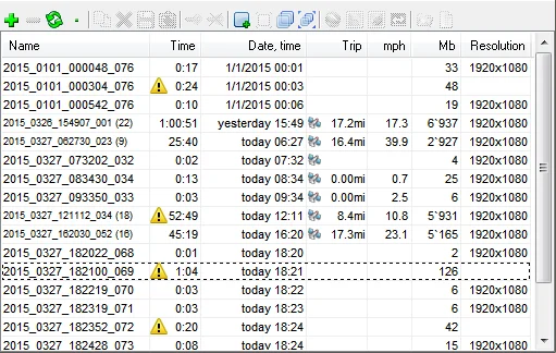

Mine seems to not do a soft shutdown on power-loss, as if the caps aren't doing their job. The last file of every trip gets corrupted. Other than that, I've been having a lot of fun putting it through its paces these last few days.
That's not right, was that from @Pier28 ?
I just sent you an PM. This is the first potential RMA I am aware of but I am ready to sort it out ASAP.
