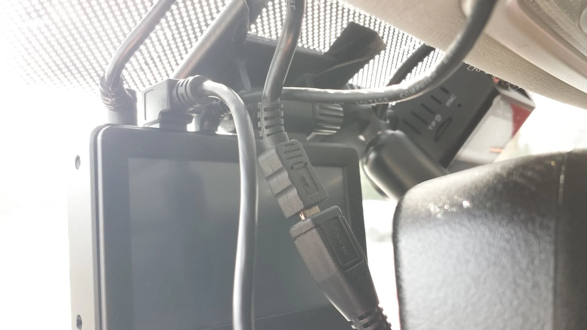

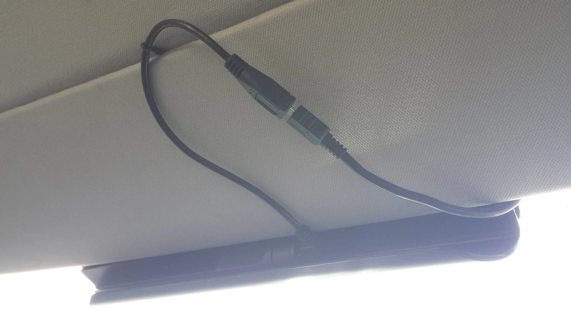

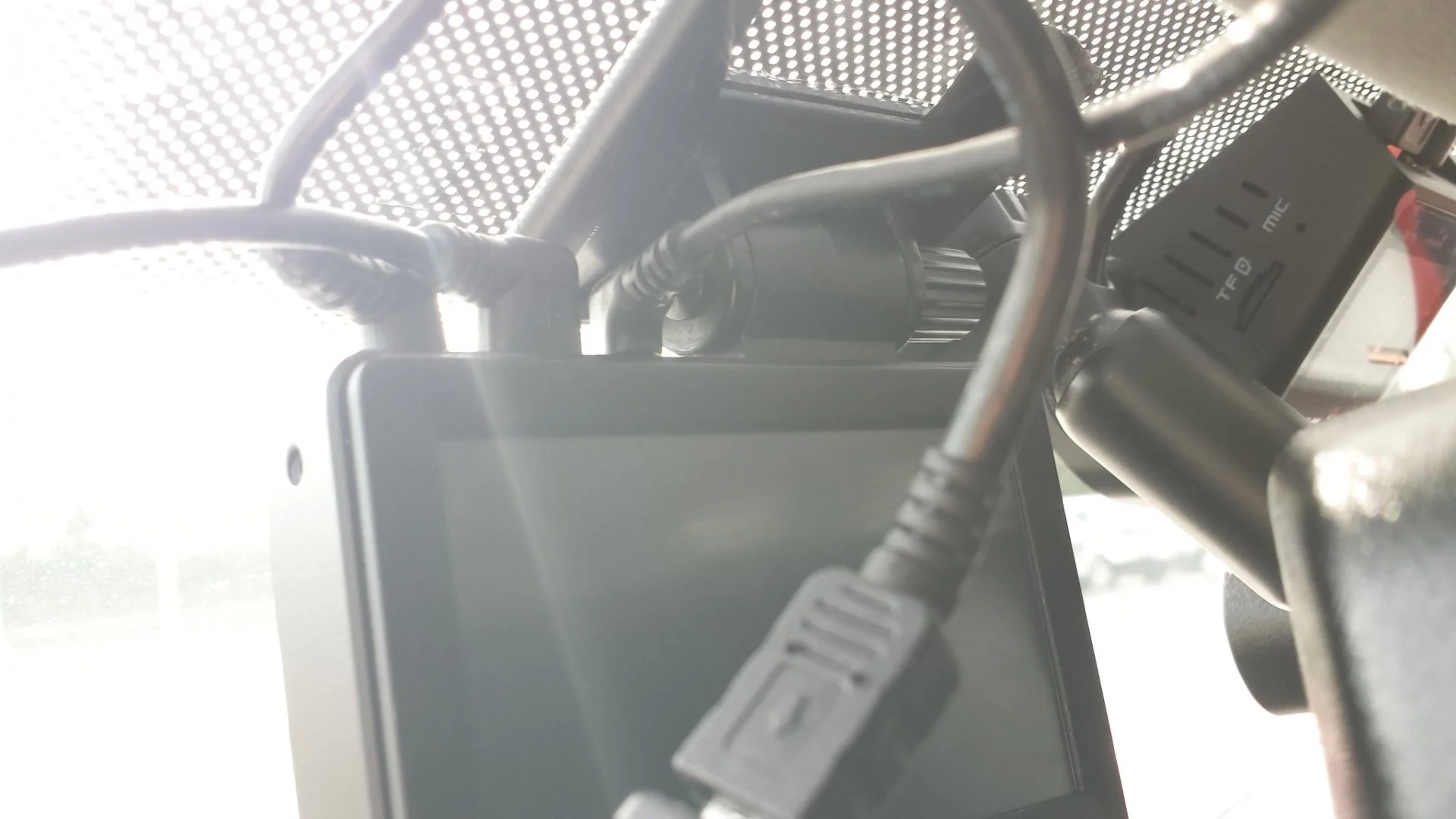

For over 1 moth I was testing in my car on daily-base driving a different adapters / extensions cables for Panorama X1 and X2 ( for main unit and camera unit ).
It was a little bit messy all this time driving around with bunch of hanging-wires, but for now job is done and I have finally cleaned up my car.

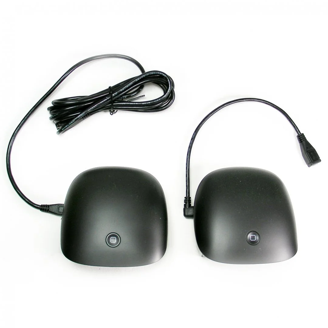

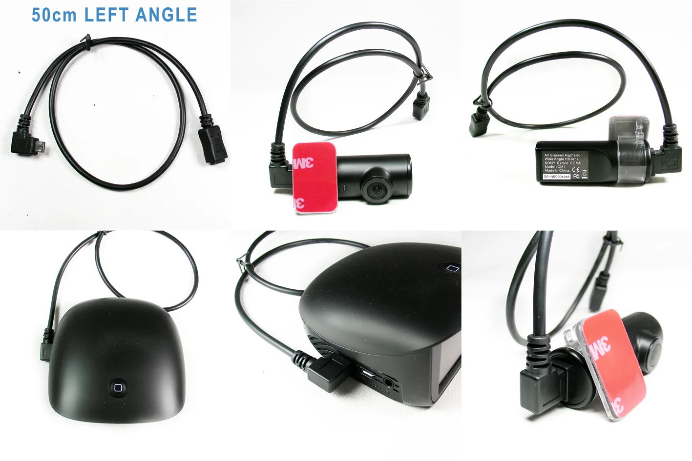

This is how adapter / extension video cables looks like on Panorama X1 / Street Guardian SGZC12RC.
Comparison of standard video cables vs adapters.
Using an adapters on camera unit, the overall "footprint view" to outside is minimal, which makes set-up more stealthy.

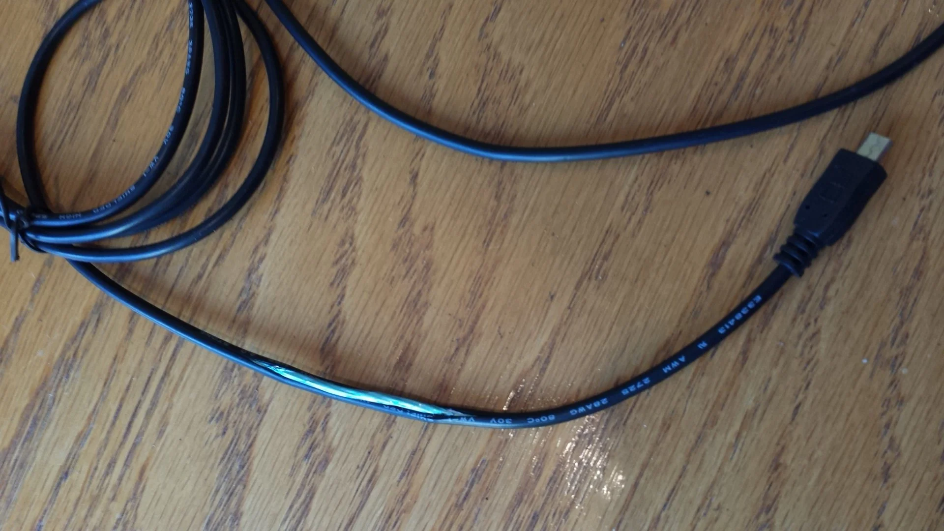

As promised, below are pictures of "stripped" cables I have "sacrificed" to see they all have a shielding.

The name of the direction of the microusb plug is determined following way:
If you take microusb plug and insert into device the way "locking teeth" are faced up, then from there you will be able to determine which way plug is facing. If to the left, then its left angle, if to the right, then its right angle, if down, then its down angle.
Hope you understand what I mean ?
Lowest "footprint" to outside leaves "down angle" connector type, because it's cable facing 180 degree opposite direction from the camera when plugged in. Left angle connector "running up" and has more footprint. But we talk here about truly marginal "footprints" if judging by looking from outside ( lets say 5-6 metre away from the car ), - you will not see a big difference.
I started offering different angle adapters, because not in all cars you can use only left angle, some set-up requires down angle connector and left angle would not fit. Its all depend on individual set-up approach.

Right angle will take cable coming in down direction out from camera and I am not sure if someone want that solution.
Best is down direction or left angle, depending on how and where do you mount it. For some cars both ( left angle and down direction ) are OK, for some cars only down direction would suit.
