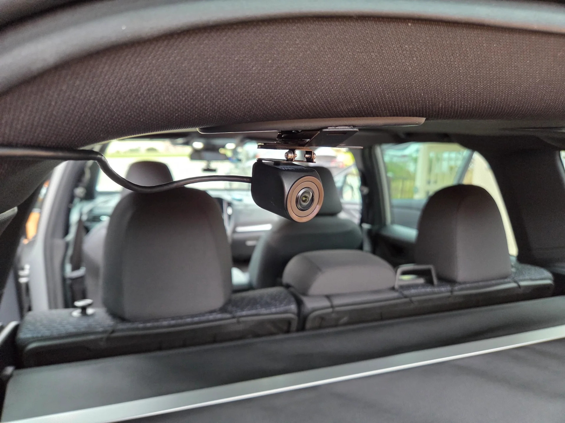

What is the plastic plate that the rear camera is attached to? Is that part of the Subaru or did you mount it?
Subaru comes with a hook. I found an unused radar mount plate (metal/aluminum) that I just bended and used some 3M VHB tape to hold to the 'hook'.
