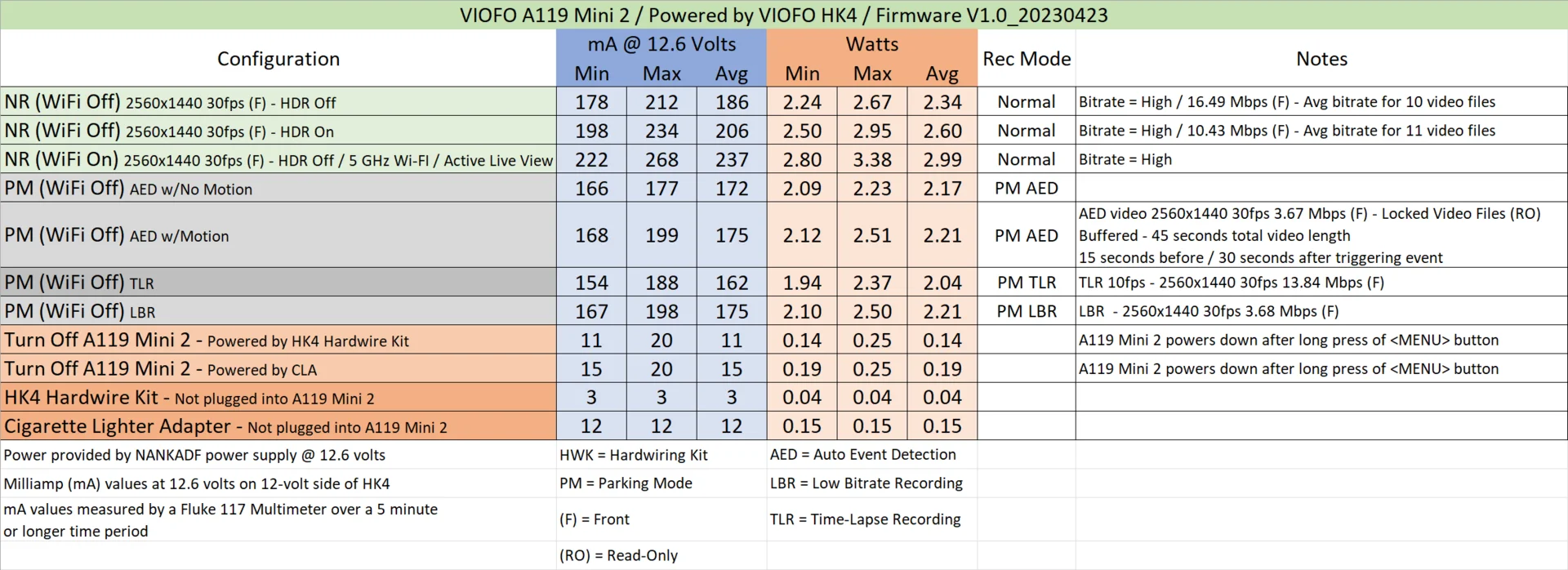

Here are my preliminary power consumption results with the v1.0_20230423 firmware that was installed in the A119 Mini 2 when it was released (at least my test version of the A119 Mini 2). This firmware does allow the recording bitrate to vary depending on the amount of activity within the field of view. A firmware which uses a constant bitrate is believed to be in the works for the A119 Mini 2.
Have you tested Time Lapse Recording power consumption at 1/3/5 fps as well? Was the difference too marginal to the 10 fps to include it in the table?
From looking at your table, it's not really worth it to use LBR when AED has the same (or even less without motion) power consumption.
Would be interesting to see if 1/3/5 fps can reach <2 Watts (max/avg).

No, I have not tested each FPS setting for time-lapse parking mode. I test the highest FPS setting in that mode which should result in the highest power consumption. I prefer to use low bitrate parking mode (when a dash camera supports it) so I capture everything going on near my vehicle or the the general area that AED would not necessarily detect and record.

I'm noticing power consumption when PM is almost the same as recording permanently, so PM is only good for saving SD card space?

There are too many factors involved with regard to estimating how long a dash camera will operate with a vehicle battery (age of the battery, charge level, temperature, other vehicle power draws) to give any sort of accurate estimate with a vehicle battery powering a dash camera. The parking modes for the A119 Mini 2 do consume nearly as much power as it uses while in normal recording mode. The VIOFO auto event detection parking mode implementation consumes power to have it monitor for motion to allow it to have a buffered recording (15 seconds before triggering motion / 30 seconds after). Depending on the vehicle, draining the vehicle starting battery down to 11.8 volts may be too low. I usually recommend to set the low voltage cutoff to 12.2 volts or at a minimum of 12.0 volts. The low voltage cutoff detection logic can vary a bit from unit to unit and there's usually a +/- 0.1 to 0.2 volts variance allowed. That means the 11.8 setting might result in an actual 11.6 to 12.0 voltage cutoff.
I would suspect your vehicle's battery should be able to power the A119 Mini 2 in parking mode for 1 to 2 days without a problem, but that depends on the factors mentioned above.
