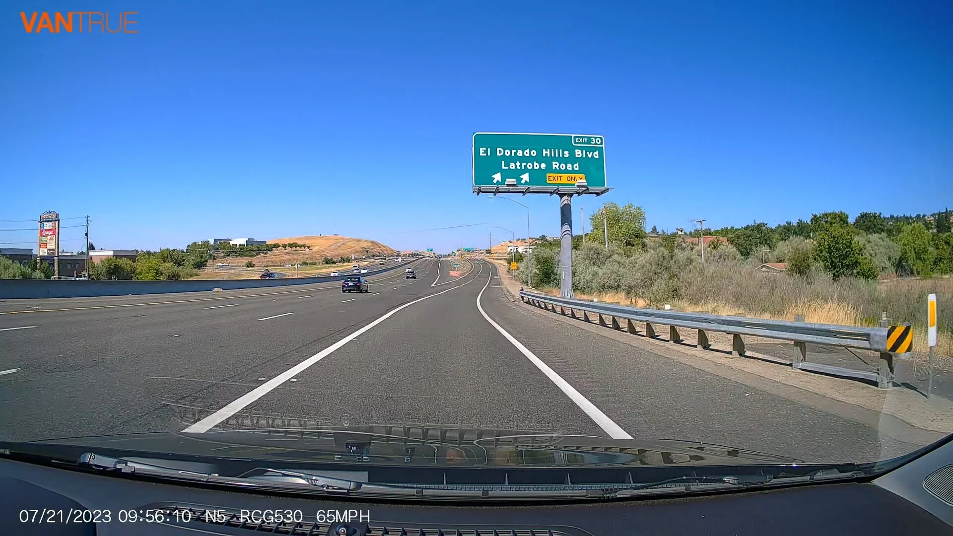

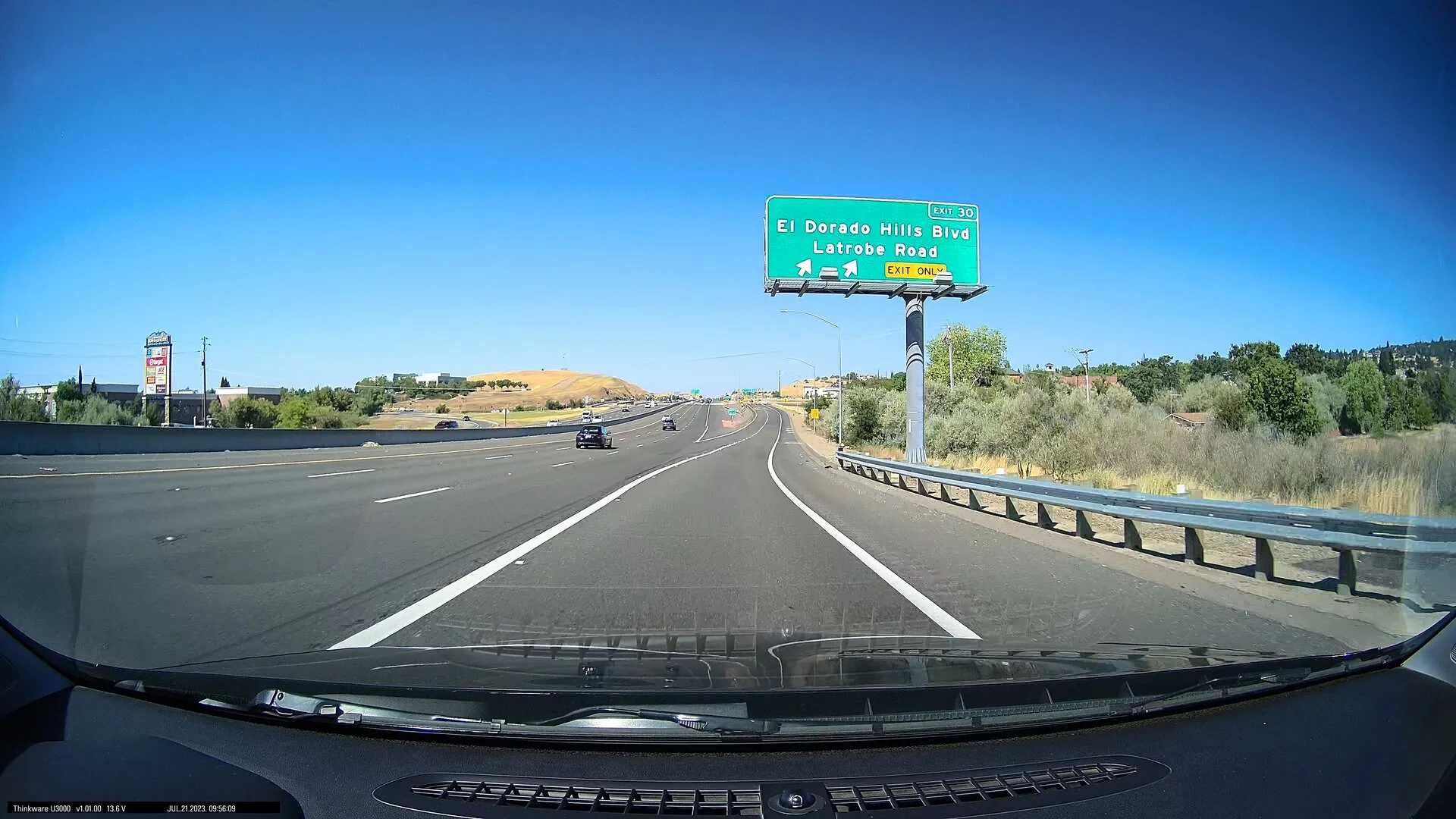

Over the past few weeks of testing the A119 Mini 2, I've found that the new lens used in the A119 Mini 2 compared to the one in the A119 Mini will lose focus clarity as it is exposed to normal use in direct sunlight. I've tested a preproduction unit, a replacement production unit sent to me by VIOFO and a production unit that I purchased from Amazon. All three had varying levels of this problem. All three were out of focus to some degree when cool as well. I've been submitting info to VIOFO and they are investigating the issue. For now, I'm suspending my review of the A119 Mini 2 until I have feedback from VIOFO on when this will be corrected. I really like the A119 Mini 2 with its new Sony STARVIS 2 IMX675 image sensor and the addition of voice commands.

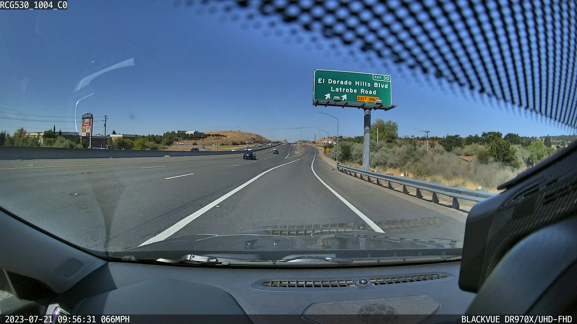

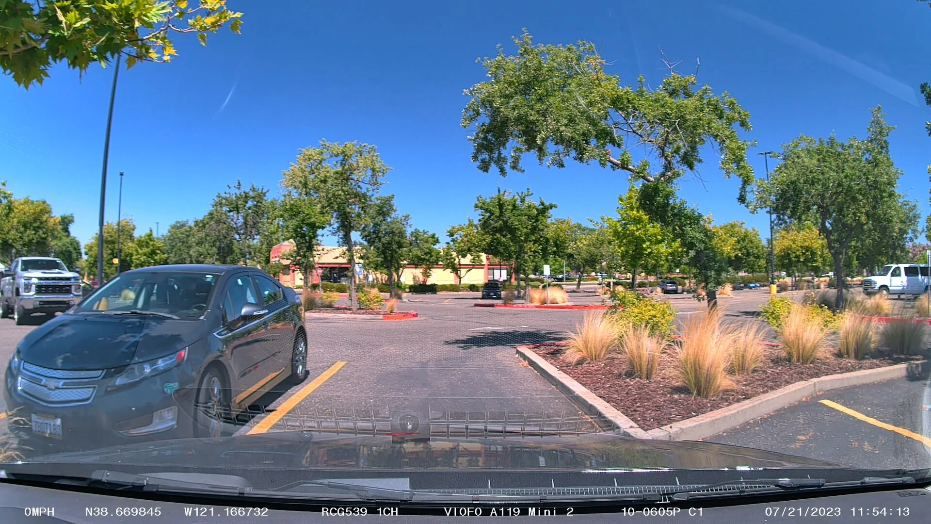

Here are a couple of screenshots from today's driving trip (warm outside temps in the low 80s F to start and low to mid 90s at the end). This A119 Mini 2 doesn't start off with too bad of a focus when cool, but definitely gets worse as it's exposed to my heat/sunlight.
Near the start of my trip / Just after the third parking mode session - High bitrate, CPL installed, HDR Off
View attachment 66503 View attachment 66502
Other Dash Cameras near the start of the trip
BlackVue DR970X / Thinkware U3000 / Vantrue N5
View attachment 66505View attachment 66504View attachment 66506

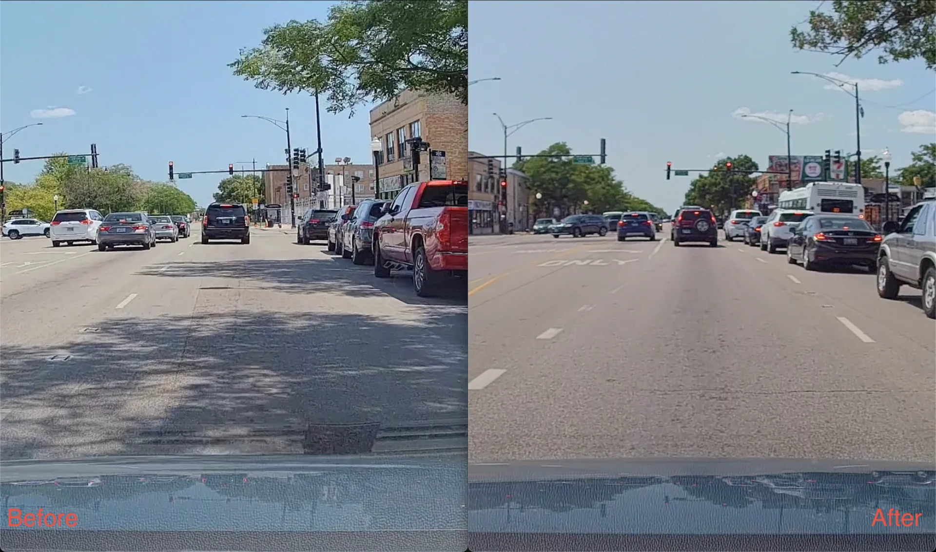

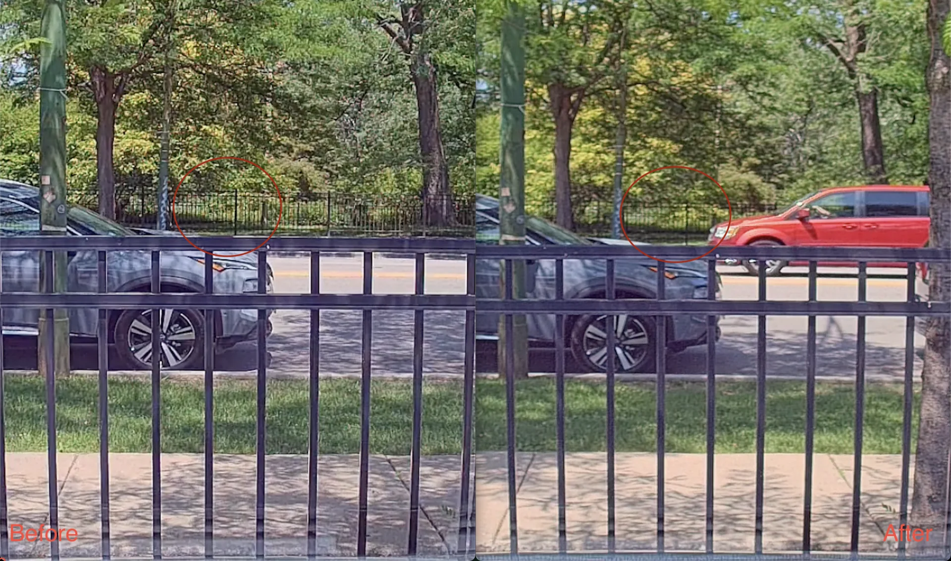

I noticed when I got the camera, I had moments where I was wowed by the quality and other moments where I was saying "this is alright but doesnt look 1440p to me"
Your post update confirmed the small hunch I had. So I went and checked some footage of mine to see that I am having the exact same issue you have described. Bought when the camera came out on Amazon.
My current settings are 2560x1080p, 30fps, HDR ON, High Bitrate, and CPL installed. (I chose 2560x1080p because I don't need footage of my hood and the sky, plus the bitrate is constant in this mode). Additionally, I also cropped out my gps coordinates before posting here.

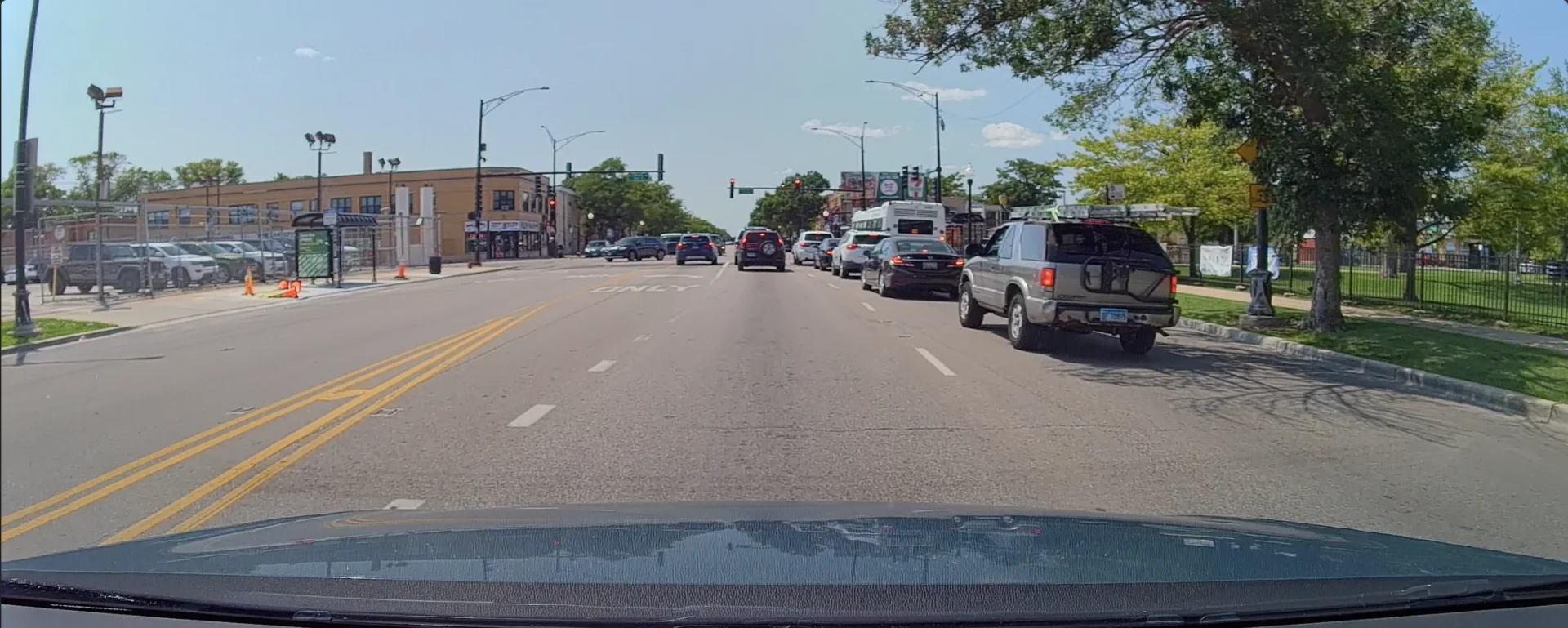

First screenshot is when the camera is "cool" and I have parked at the gym.

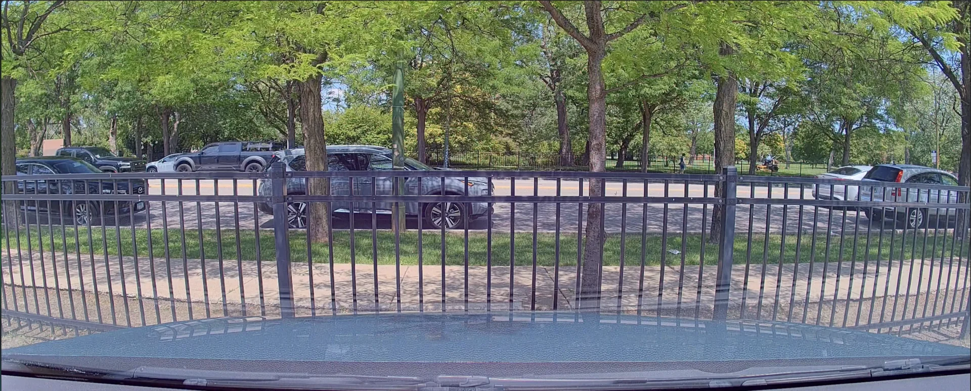

Now this one is about 90 minutes later in the same location. Temperature outside was around 86F to 88F. I haven't hardwired my cam yet so Parking Mode was OFF. No tint on windshield, but have pretty dark tint on all other windows and had the sunroof tilted open as an heat exhaust. Regardless, the inside of the car was still pretty hot when I entered.
Here is a side by side zoomed in comparison:
I think the circle shows the issue adequately

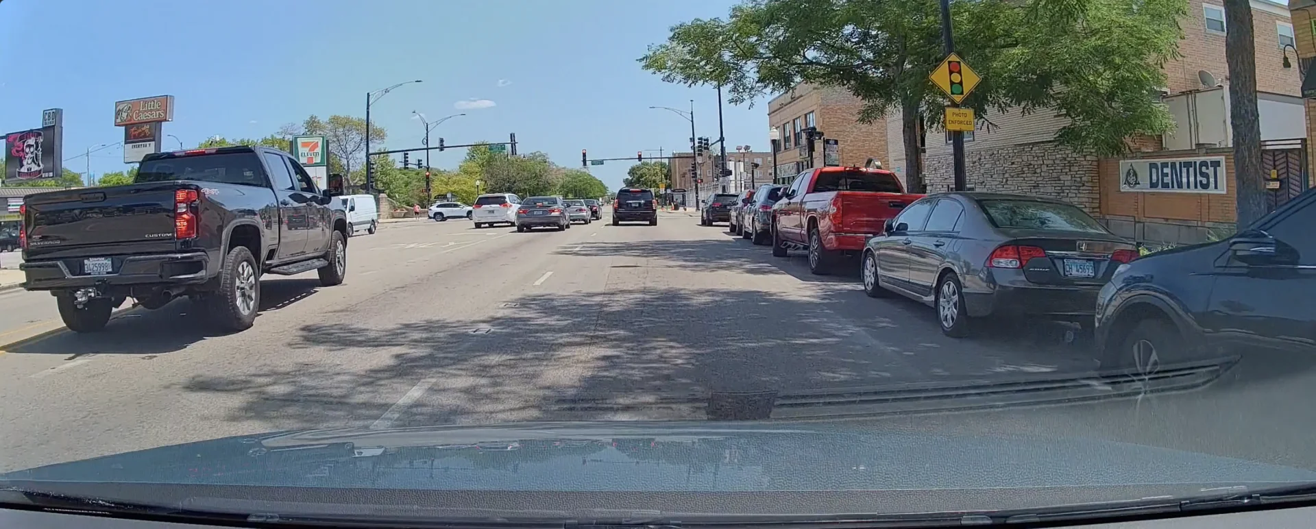

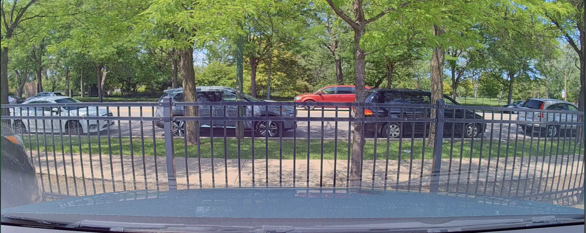

Here are another screenshots but driving. First one is the "cool" one before I got to the gym. Second one is the "hot" one driving from the gym after 90minutes in the heat. I tried to line up the distance between the car in front of me as closely as possible between the two pictures.
Side by Side comparison between the two
Will be following this thread closely to see what updates you get from Viofo. Thanks again for posting your update and suspending your review until this gets addressed

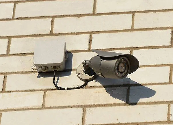

CCTV cameras are made with many of the very same lenses, sensors, chip-sets and other internal components as dash cams and many are in the same price range. These cameras run 24/7
When there were no original holders, I took apart several broken CCTV cameras, they all had a metal holder (alloy), but they did not fit Viofo in size.
