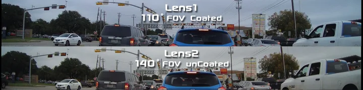

Actually Sharp60 was Lens 1 and Sharp70 was Lens2.
Edited my post to show which was what lens
Great! was hoping my guess was wrong because Lens1 has special coating and it also improves color based on your low light test clips. Lens2 without coating will always have brighter image.

Judging by your comparison I don't see a difference in FOV, and it was said that Lens1 has 110 and Lens2 140 FOV. I would say they are very similar. What do you think?
To accurately compare video or photos never judge, use editing tools.
That's what I did, it just didn't look like 30 FOV difference between those two - especially when they are not mounted very close to each other. But I did it on the first rainy night footage, maybe that wasn't the best choice! :)

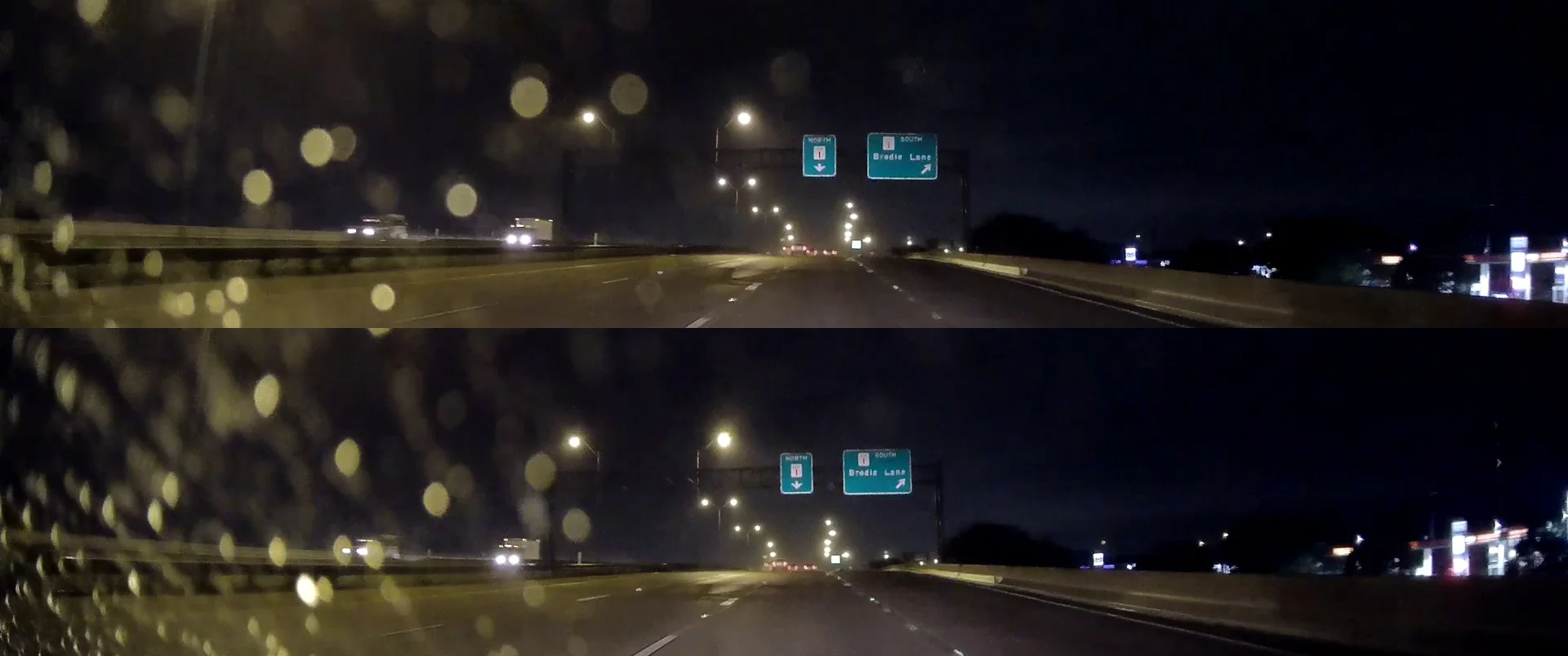

Nice 6Vf old Sharp72 version footage, can see why I reduced Sharp from 72 to 70, these clips are all over-sharpened with your perfectly focused Lens.
Look forward to new Sharp70 Strong footage.
The marketing info on actual Lens FOV is the diagonal measurement, horizontal is never published or referenced because its small and almost insignificant.
The actual horizontal measurement done on piece of paper with protractor Lens1 = 100 degrees (some are 98 or 99) . I have no data for Lens2, don't own one.
Yeah I'm aware of that, anyway, I like the smaller FOV better, in my opinion the plate readability is a bit higher, thanks for clarifying.

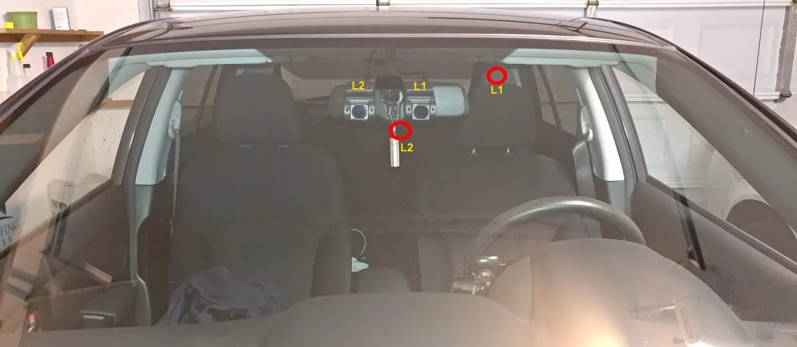

After these clips both Cameras were re-positioned. See attached Photo:
The Red circles indicate the approximate previous camera positions and where all video Clips that I have shared were obtained from. The cameras are shown in there new position and labeled L1 = Lens1 and L2 = Lens2. Any further clips shared after these will be from the new location shown in the pic.
Perfect A119S side-by-side configuration! You Sir, have improved your image record-ability by 200%. Looks Professional and similar to Police Interceptor.
Very good Lens1Sharp60-vs-Lens2Sharp70 comparison. The higher MENU > Sharpness > Strong level works well with Lens2, very impressed, actually shocking since most of your footage involved rain and clouds, absolutely shocking difference. Well Done!
