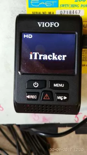

Hello friends,
I have the a119s from Viofo and iTracker.
Here in Germany a friend, from a certain company, always buys me the cameras.
The company sells selected and optimized cameras.
### Selected: According to the seller means selected: The Viofo a119s often has different factory Kamera quality.
Image quality, sometimes the quality of the camera is very bad, sometimes it is fine.
### Optimized: According to the seller means optimized: The Viofo a119s will be optimized again if it was selected, how did I not know until today, only through the forum I am sure that the seller changes or modifies the software.
I'm about to sell my iTracker a119s because the camera is much worse than the Viofo, can I change the software of the ITracker with the firmware of this site? I think it's just the name, otherwise the cameras are almost identical.
The Customer is sellings also the optimized Version from the iTracker like Viofo.
Actually I want to sell both Kamreas and buy a Duo, but I don't know which one yet.
The Viofo in the trunk is really big, cars behind me feel watched.
What I also don't like is that I can't access both cameras at the same time every time I want to play them.
I am very satisfied with the a119s, it doesn't cause any problems in cold and heat, even if it still records overnight.
Sorry for my English, use a translator.
Is it better to buy an A129 and optimize it?
Is the seller's story true that the unmodified Viofo a119s sometimes has a poor factory quality?
I conducted such experiments at the request of the owners of Spytec Inc and itracker.
Who in the hands of 119S from Spytecinc and itracker, firmware from Vifo A119S can be installed without problems.
Do not rush to sell, try a recorder with a new firmware, I think you'll be happy!

Welcome to the Forum and this MOD Thread,
It's true if the dash camera body/case is similar between Brands ITracker & Viofo the Firmware almost always is compatible, just don't get the S non-S and Pro versions mixed up.
Your idea to sell may be correct. A very important factor in selecting any Dash Camera is the windshield mount, only the A129 has a stable 4-clip design.
If you require dual camera buy the A129. I prefer separate unconnected cameras for Front and Rear windows for maximum reliability, their size and cabling can complicate installations. There are new DVR models every year, probably need to create more MOD threads later in 2019.
The A119S is an excellent 1080p resolution camera but 1440p has better detail. Modified Firmware improves A119S image quality but Lens focus makes all the difference.
For lowest power drain and Parking Mode power bank support nothing beats the A119S.

Post a screenshot from video for focus verification, if its soft or blurry return to vendor.
Mounting the main Dashcam in rear window is very noticeable to other drivers but has other advantages. Dual Camera systems are preferred since the rear camera is much smaller but you'll notice weak AM radio station interference (working on a MOD for that issue). The much more stable side loading quick release 4-clip A129 mount is far superior to the old 1-clip mount and EVA foam pads for stability.
I'd recommend the A129 Duo to anyone, just remember to disable WiFi before driving for maximum video quality and reduced heat.
Okay, I have installed the MOD-6Vk and the camera is now taking very good pictures, which makes me very happy. Thanks a lot! I didn't think a software would make such a difference.
