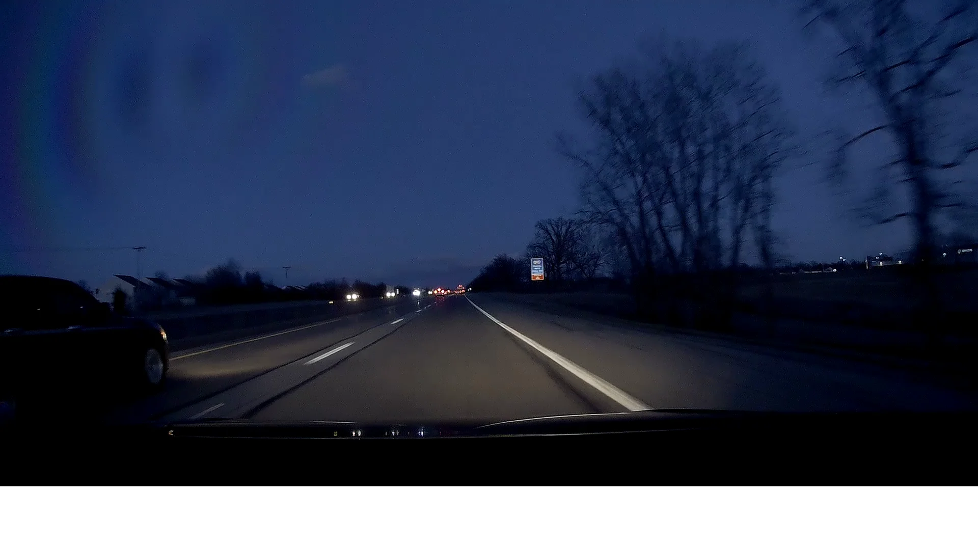

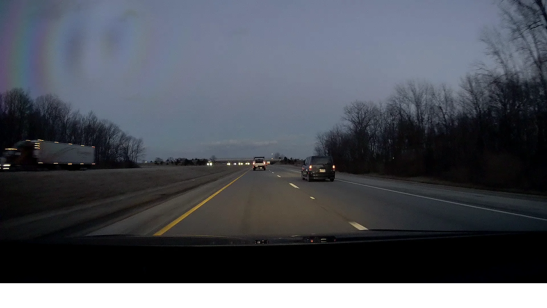

I asked about the swirl and was instructed the Tint + CFL was causing the issue. This was even before I modified the firmware. I didn't argue with people about that issue what so ever. I simply asked why I was getting a circular reflection and that was explained. You'll see the light issue on both screen shots. So yes, it exists BECAUSE OF THE light reflecting off the tint and messing with the CFL Filter.
It's hard to show on captures, but it appears to be more grainy with modified firmware. Again, NOT the firmware's fault and stems from to adjustments in sharpness + higher bitrate picking up more noise due to CFL + TINT.
So I can either remove the CFL and try Firmware to see how it reacts with ONLY the tint. Or just remain on stuck with there is less noise because less sharpness and lower bitrate.

Very similar to the defect of the windshield, which manifests itself in these conditions.
Could you change the camera position and re-bring screenshots?

Thanks for sharing the images. Apart from being a bit unsightly in the corners, do the swirls affect any important details that would be required for dashcam video evidence?
e.g. Are street signs distorted? Are the colour of traffic lights affected?
With Modded Firmware, The CFL Filter + Tint make objects very hard to read (plates. signs, etc) Snapshots didn't really show that except in the blue sign. It's fuzzy. That's how signs looked in motion.

The blue sign is fuzzy due to motion blur, the only solutions are either to slow down, or to catch more light, and the only way to catch more light is to remove the tint. Not sure why you want to look through something with coloured patterns in anyway!

Presumably a linear polarising filter would not show the coloured patterns from the tint? The patterns being a result of the tint circularly polarising some of the light.
Don't think he is listening!
... I am listening and I meant to say CPL and I understand it's from the tint. But the camera only picks up the polarizing effect when the CPL filter is attached.
