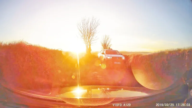

Too much sunshine in my part of the UK yesterday, I can't see the road, although the A129 has no problem reading plates:

Not quite sure why the road isn't visible, maybe sunlight reflecting off the sensor and then back off the lens elements?

These are the situations where the CPL filter come in Handy. My Dilemma is the light polarization from my tint causing the CPL filter to show a halo effect. If your windows aren't tinted, then invest in a CPL and that problem disappears.

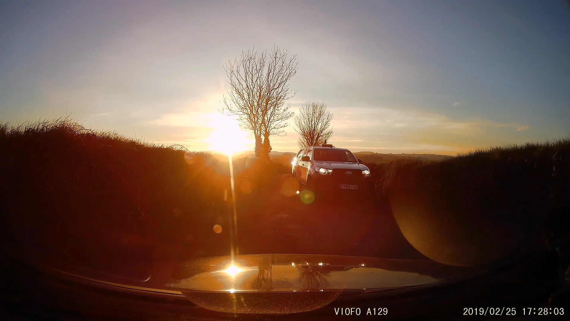

You said that you couldn't see the road yourself. The low bright sun throws most of the image into shadow or silhouette.
It's a simple case of the dynamic range being a long way beyond the capability of the sensor. The road is just under-exposed. Lifting the shadows and the exposure shows a little bit of the road surface. It's not practical for a dashcam to do this image adjustment however.

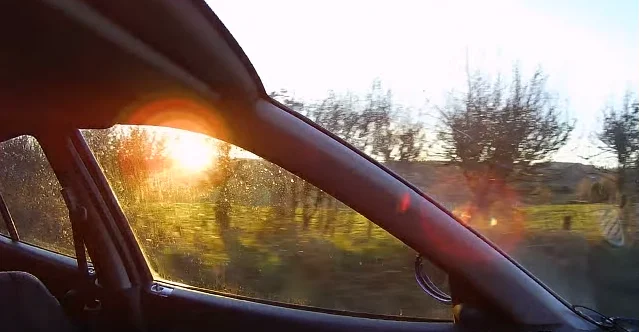

I think the main problem is the orange haze hiding what is behind it, which looking at my side camera is not from the car glass since it extends onto the roof area, so must be caused by lens reflections:

I suspect the only answer is a higher quality multi-coated lens, or maybe I'm asking it to do too much!

Yes, I agree. There is substantial lens flare in your image that is obscuring the shadow detail in the road. Difficult to do much about that given the position of the sun.
