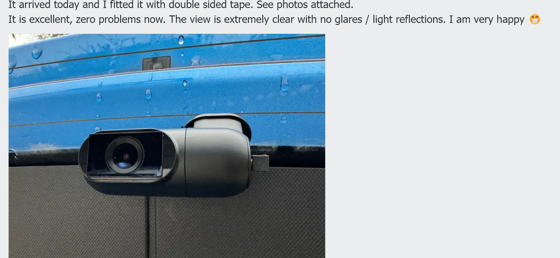

I may have missed it, apologies if so... but is there a CPL filter for the A229 Pro's rear camera? It looks like that would help cut down on reflections. TIA!
If you really need this, you can contact our support team to get one, other users received this simple CPL and are satisfied.
