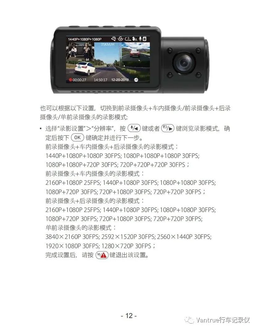

A suggestion, could you please update the firmware in the future to solve the problem of the a229pro three camera version having only three camera options for video resolution and not being able to enable only one or two cameras. Because sometimes only one is needed, which is also to save space considerations,thanks
All the buttons on the camera have been endowed with functions, so there are no spare buttons to be used. To make it easier to plug/unplug, we have used a 3.5mm connector and type-c plug on the interior/rear cables. So you can simply unplug them when you just need the front one.
Thans for your reply.This is the settings interface for Vantrue n4, please refer to it。It should be easy to resolve by updating the software, without the need to improve the hardware。
