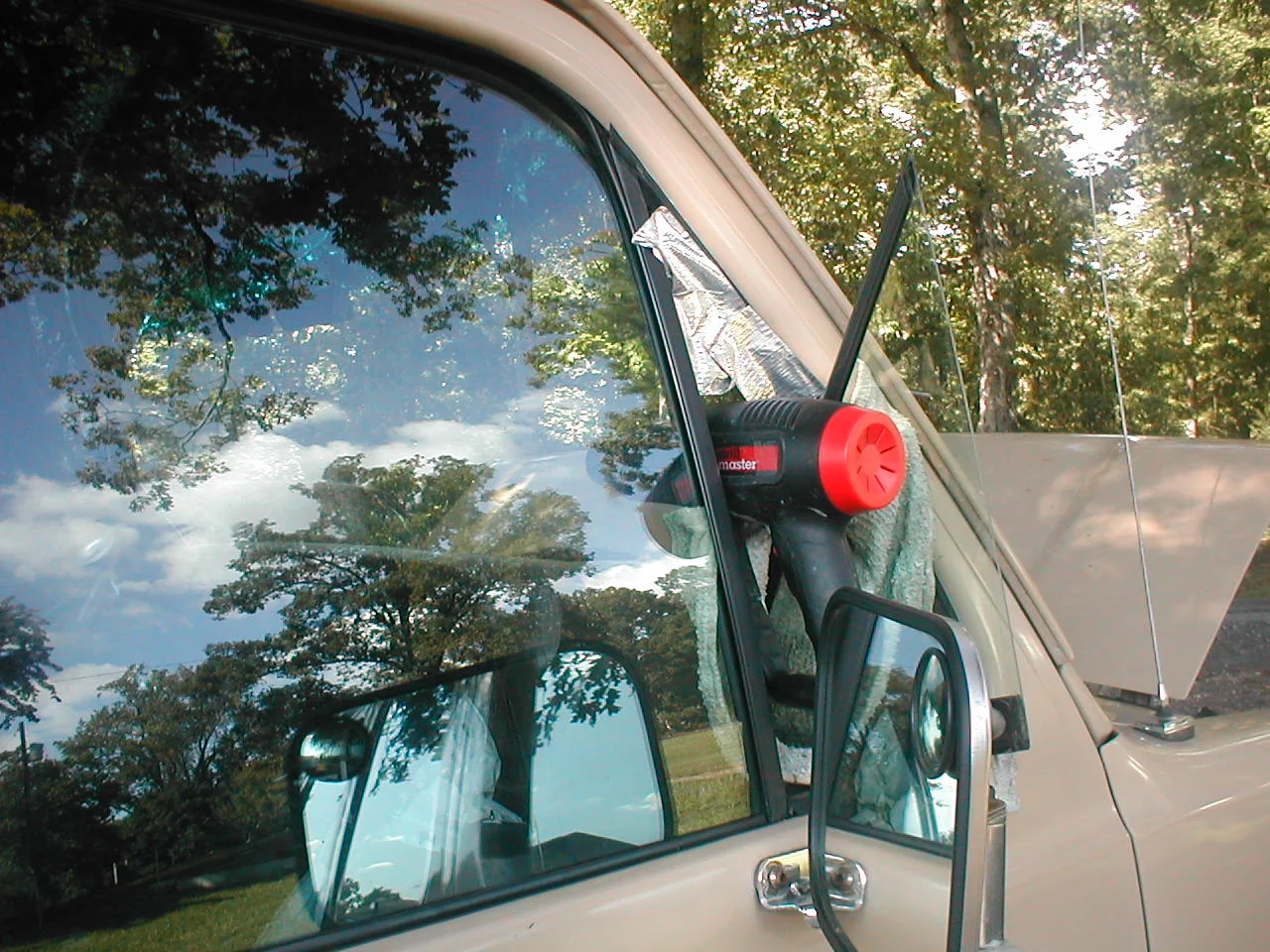

I revised my setup with the heat gun stuck in a vent window blowing under the cams in test; a WHOLE lot better than being inside with the heat as I'd been doing this :ROFLMAO:
I reached a temp of 71C (160F) which I held for 5 minutes. No cam failed. My test was done with all cams in driving recording mode.

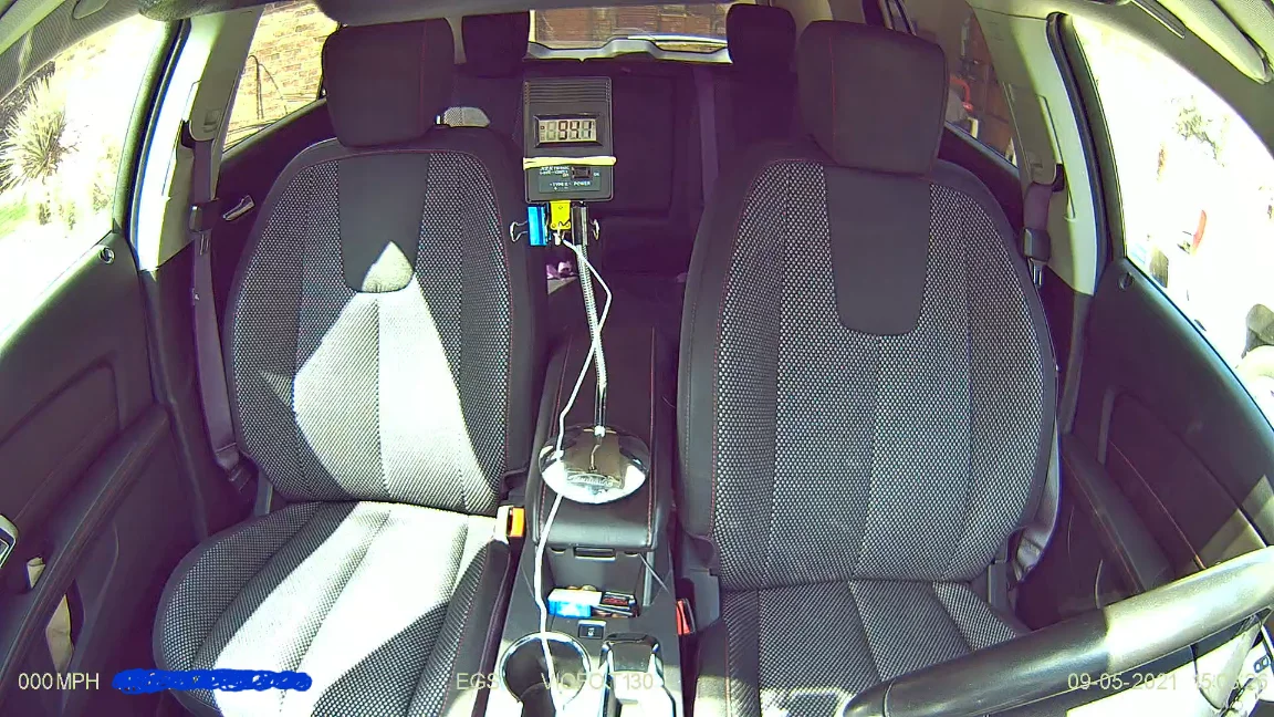

So far I'm very pleased with the results.

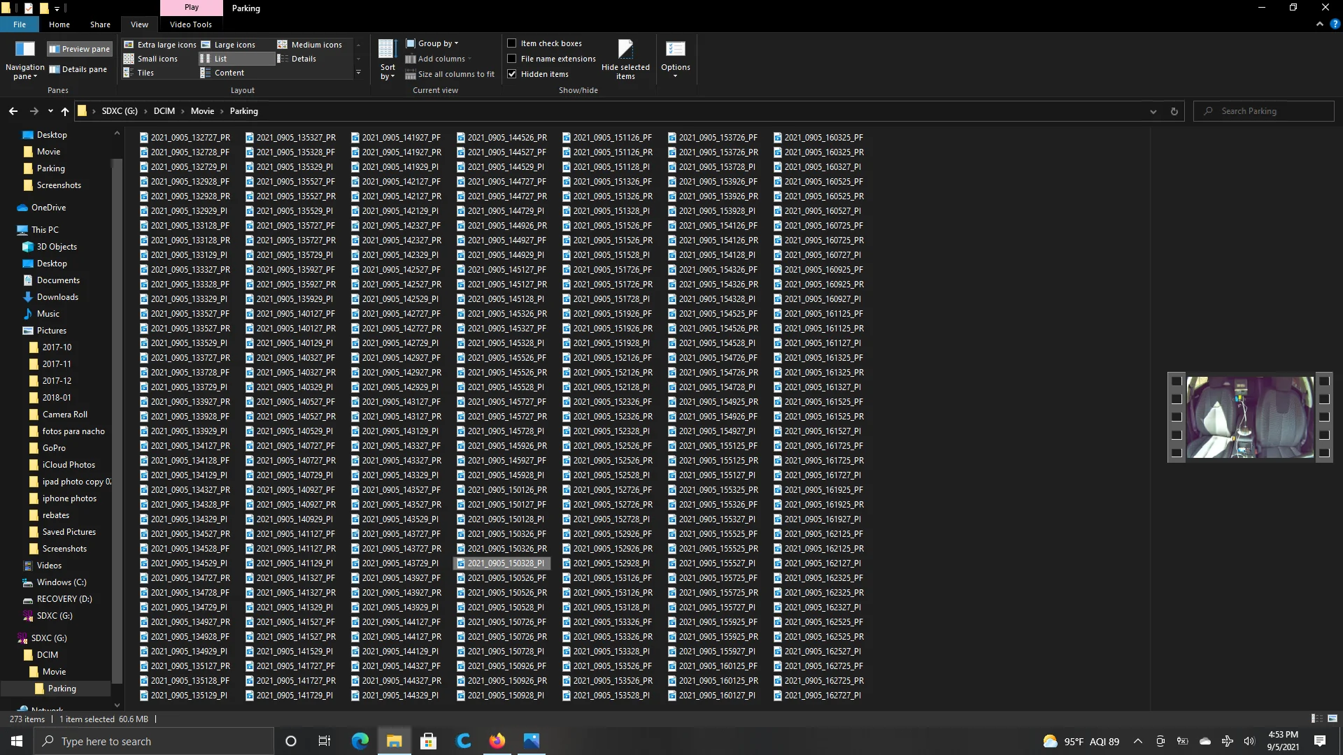

Ir recorded for the 3 hour I had it set for on low bitrate parking mode.
No drop outs or corrupted files.
There is a frame grab from the interior camera showing the maximum temperature recorded.
Also a screen shot showing the file list of the whole event (start to end). Note that each file shows the date and time stamp.
So far I'm impressed with the temperature handling of this camera. The other two I have would likely shut down under similar temperatures.

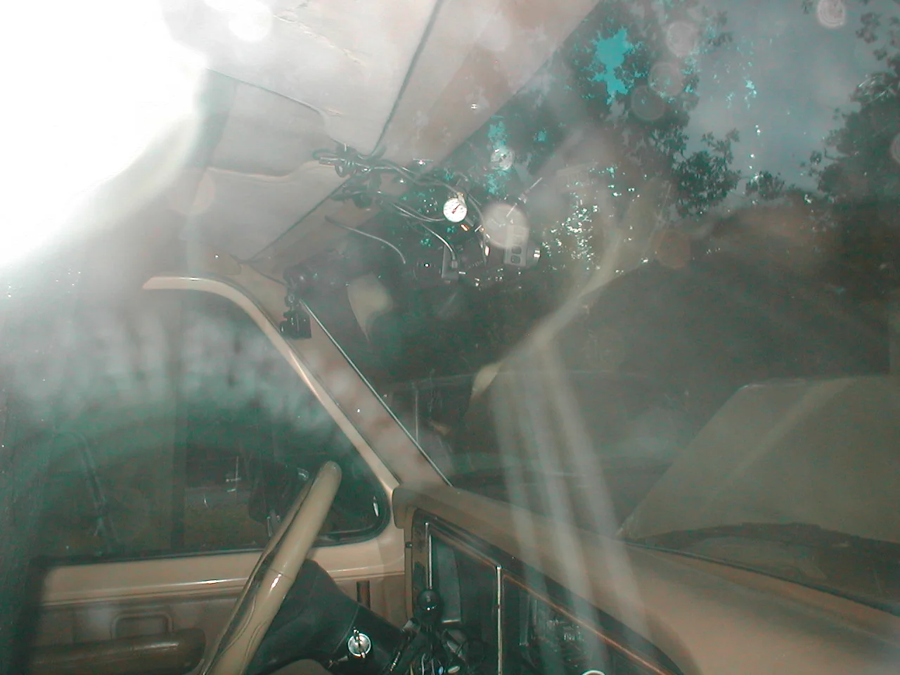

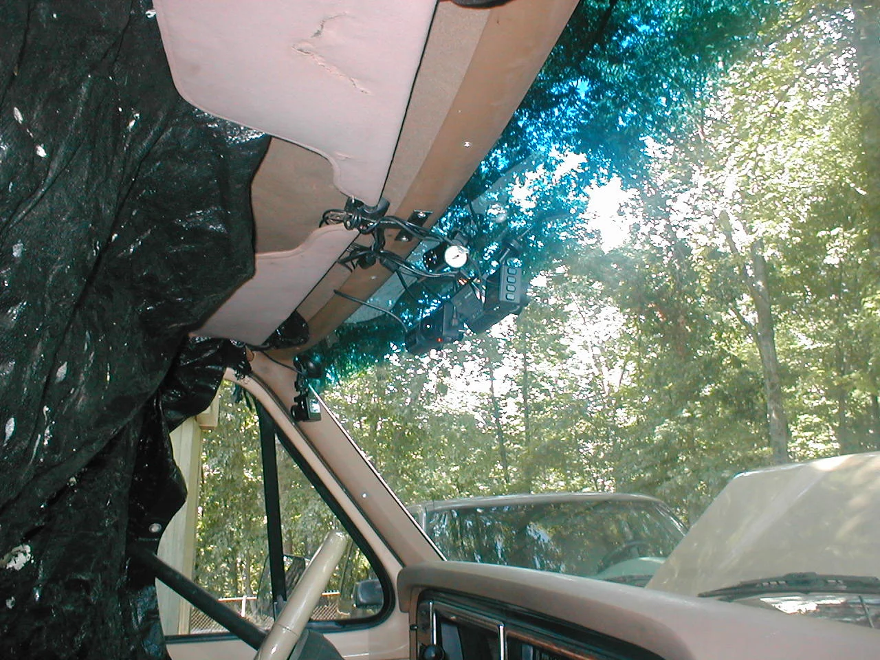

Reporting the same results- no problems with either Viofo in parking mode after them being in 71C (160F) temps for 20 minutes. Cams with the thermometer visible, the left edge of the tape on it aligns with 160F
Test set-up:
Tests done later w/parking- note the needle on the thermometer is about 180F
Sorry for the glare and crappy pic, due to darkness I had to illuminate through the glass with my flashlight to get this image.
Not as fancy as @EGS but an entirely workable test with the entire cams in the heated air where the thermometer probe end was at.
Test set-up:

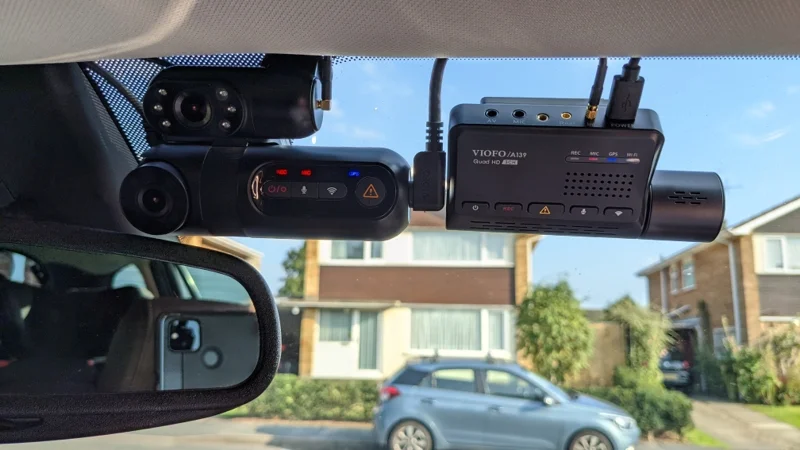

A couple of photos showing the T130 and A139 installed for testing in my RHD car. The A139 used to be where the T130 is now located.
The extent of the frit pattern in my car means that barrel-type dashcams work best if they are mounted on the frit, with the front lens peeking out to the side of the frit.
