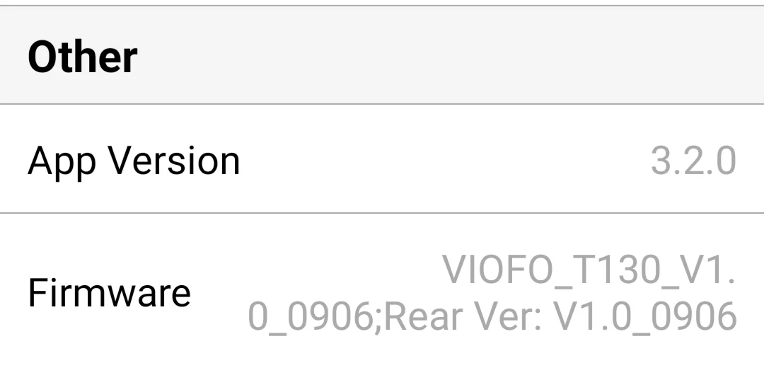

The new version posted today is also V1.0_0906
where did you get the update?
Did you get this version via a wi-fi update?
Was on the Firmware page earlier but no T130 mentioned.

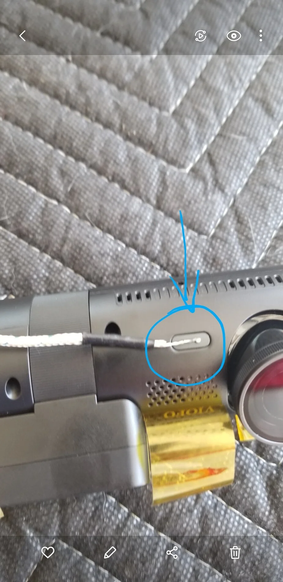

There is a hot spot on my T130, hotter than anything i have ever felt on the A139, so i am not optimistic for parking guard testing, even if now we Danes are moving into colder and colder weather, which should facilitate a hot running camera.

If you are talking about this spot (as marked on the picture) It does indeed gets hot and it is considered normal. It is a portion of the heat sink!
I have already burned my fingers a few times. Extremely hot to touch but my camera have not had any issues even though yesterday's testing in direct sun light for 3 hours.
