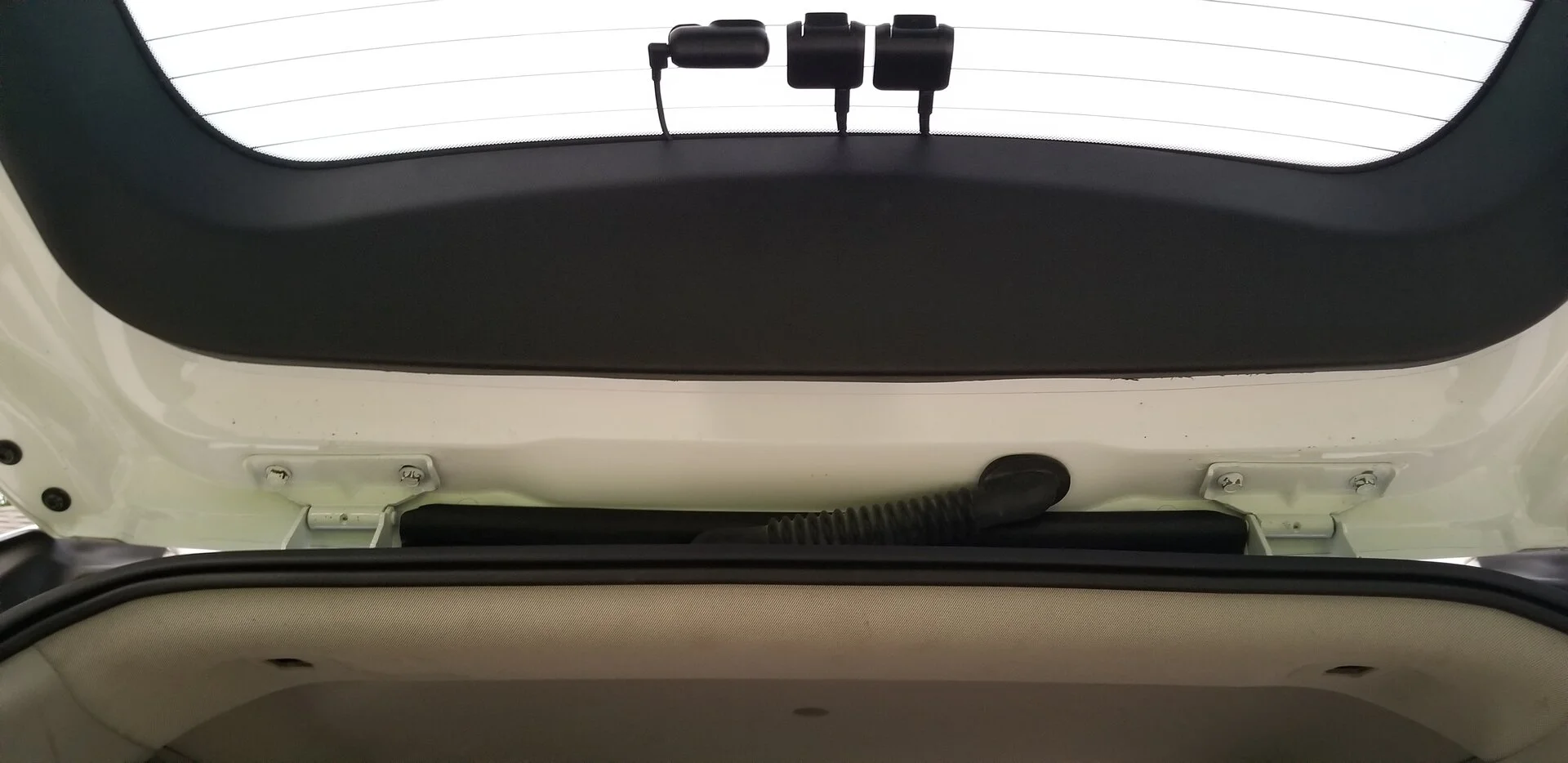

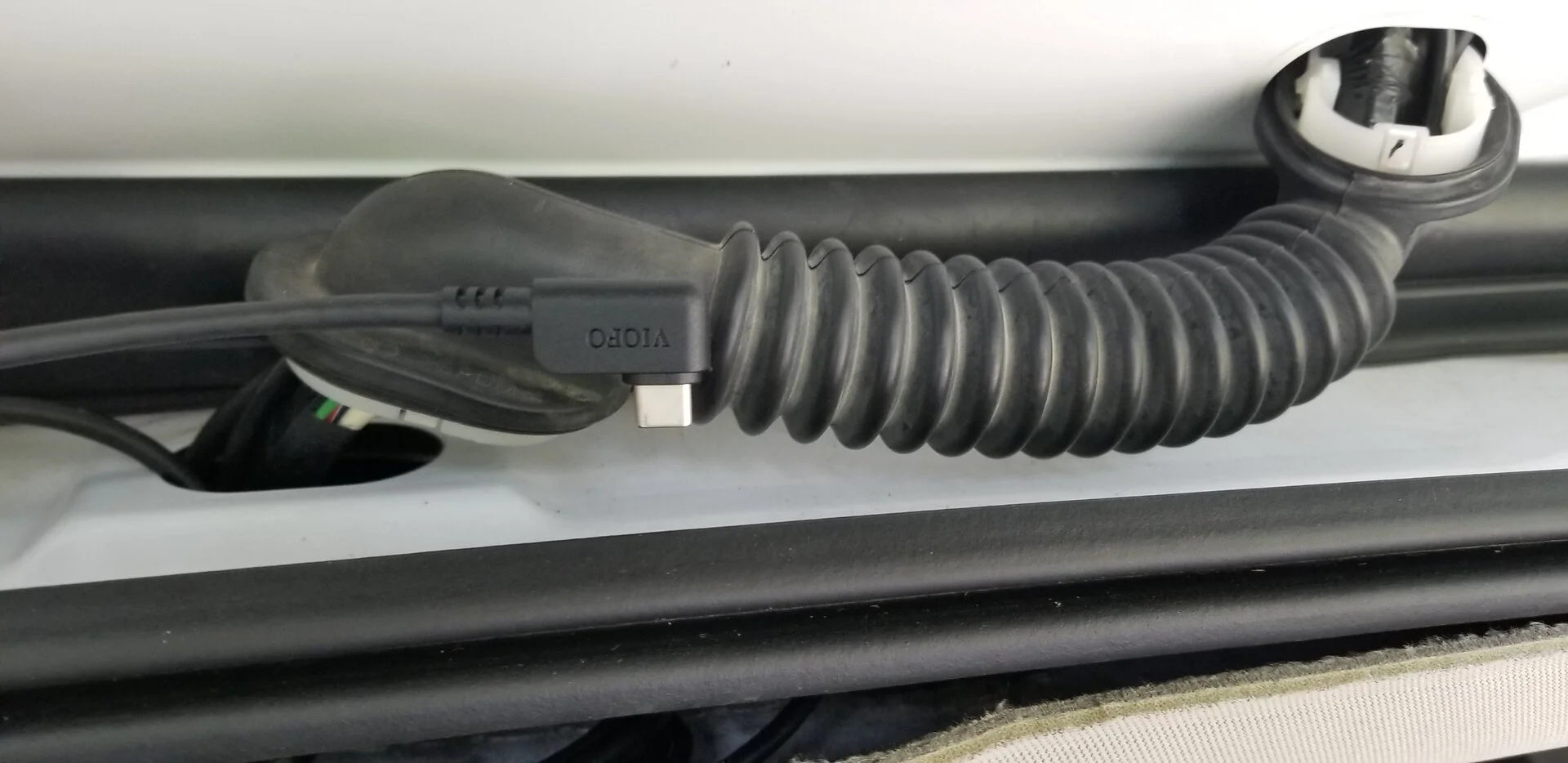

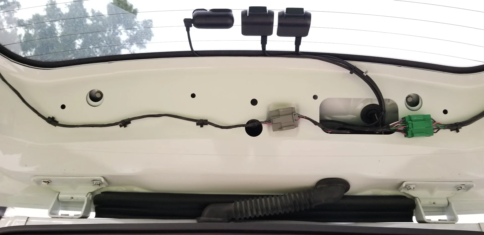

I finally received my rear camera replacement along with cable and want to say thank you to VIOFO for the extremely fast response and shipping.
The culprit was the rear camera and now the 3 channels are working!
Now that all is working, I had a chance to go ahead to properly install the rear camera and in the process I have found out how difficult is to work with this particular cable due the L shaped angle and it's size (big connector).
I can see this is going to be very problematic for those who want to do a clean permanent installation like I did on my vehicle and car audio shops or any other technician hired to do the job will probably won't be happy to deal with it at the end.
It took me about 30 minutes to fish it out through the rubber boot as I was being so careful to not cause any damage to the boot, wires ot the cable connector itself. Definitely not an easy task with this one.
So my suggestion is to change the design to a straight end on one side of the cable as a few members have already suggested, or there may be another solution available in the works.
Also, once the camera is glued in place, the connector will be touching the glass limiting room for view adjustment. In my case it was barely enough clearance for my desired adjustment as I didn't settle having the connector flipped the other direction as it makes it look ugly, At least bad enough to bother me.
first picture is to show the size of the cable tip against the boot size and one must take in consideration the wiring already inside that boot.

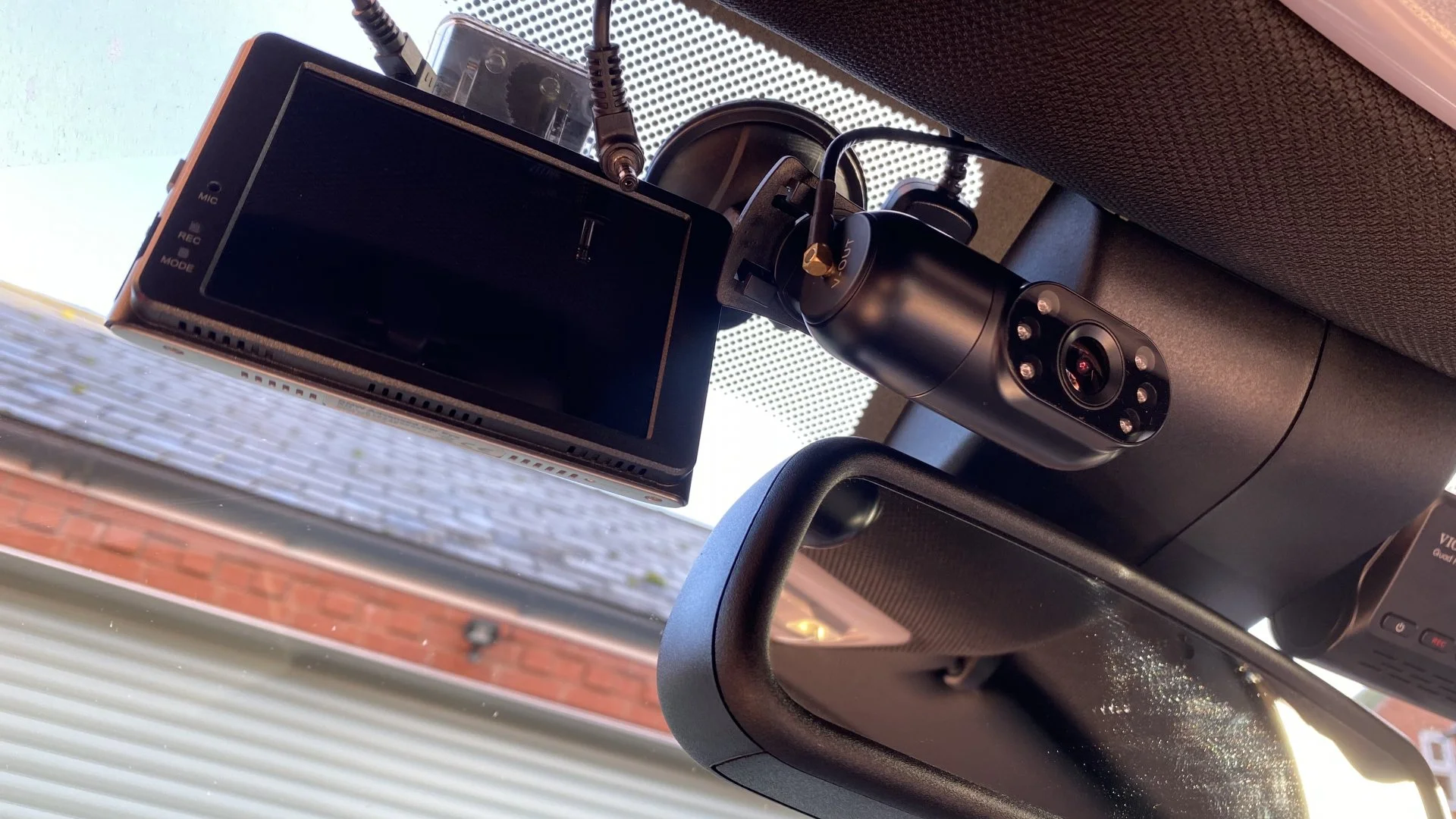

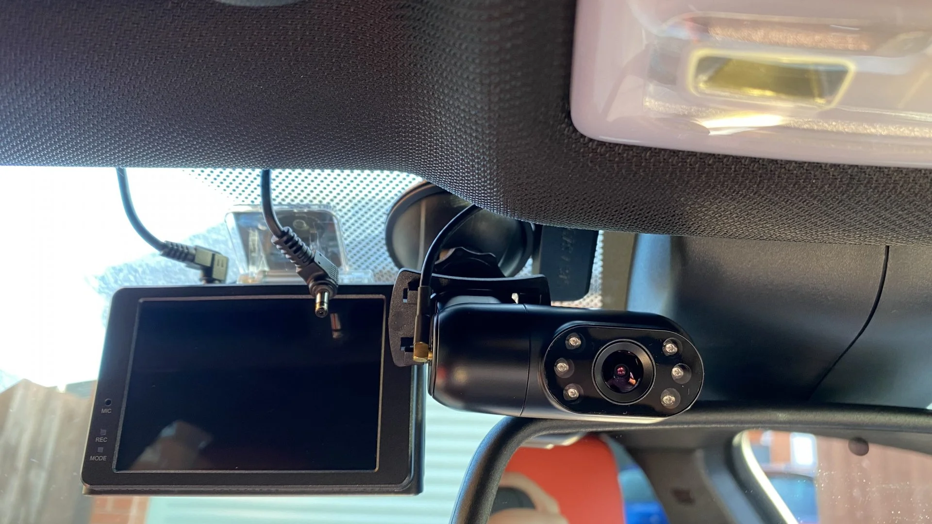

Looking at people's photos, the integrated T130 gives a worse interior view than the 3 individual cameras on the A139. I guess the benefit of a separate camera is the luxury of choosing it's position.
Looking at photos on here, you kind of get a one side view. Generally, I'm guessing this will favor the driver's side. Although that swivel camera would be great if pull over by police versus a fixed A139.
I was thnking about making some kind of hinged mounting bracket for the A139 interior camera, so you would be able to swivel it 45 degrees to either side, but as a cabin camera are not big on my list or the worry about something appearing at my door i have not moved on the idea.
Yes, the rear cable plug will be changed to straight when T130 is launched.
That sound like a good idea, a strait plug could also be used in the front if the user prefer to have the angled one near the camera,,,,,, either way people will have a choice and that is always good.
In my car with the vertical rear window the angled plugs are working just fine.

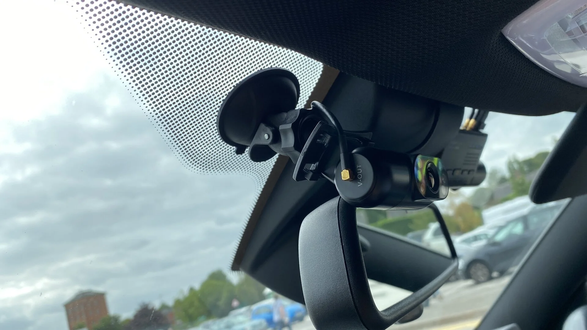

I have mine mounted on a swivel bracket, it came with a 3m stick on mount and a suction cup mount. I just stuck the interior cam to one of the included plates and it can now be swivelled and adjusted all around. It was very cheap to buy.

Also it could be useful for numerous cameras including the T130 rear cam to lift it off the screen to help with the cable clearance.
