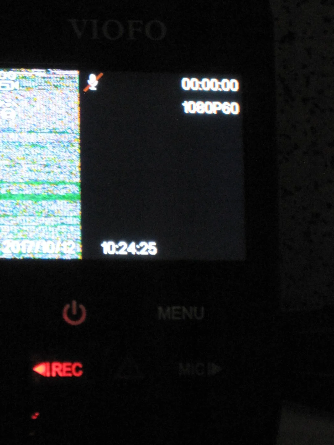

Now while I did not see the XXXXXXX on the screen, the weird scrambled screen issue appeared. Some users just experience the XXXXXX issue, while others like @harsh have experienced the XXXXX issue and the screen issue at the same time. I'll assume they are related in some way.
The three faces of Eve 😕, I mean the X-box problem that I saw during my X-box episode included one with the hash and no button action but no X-boxes (see photo #3 - IMG_403 below). Since many have fixed the problem reloading the firmware, seems unlikely to be a hardware problem but you never know. However, as my problems were resolved without reloading the firmware, maybe the firmware itself is not being corrupted, unless it was able to fix itself. Don't know enough to guess what else it might be. Sorry, my better photo files of #3 face were to big to upload, but believe me, there were no X-boxes on that screen. In all three of the photos, the camera was not recording even though the REC light was steady ON. The was no blinking red dot on the status screen over-lay. When the Hash (photo #2) goes away the picture on the screen is live and active, but the camera is still not recording.

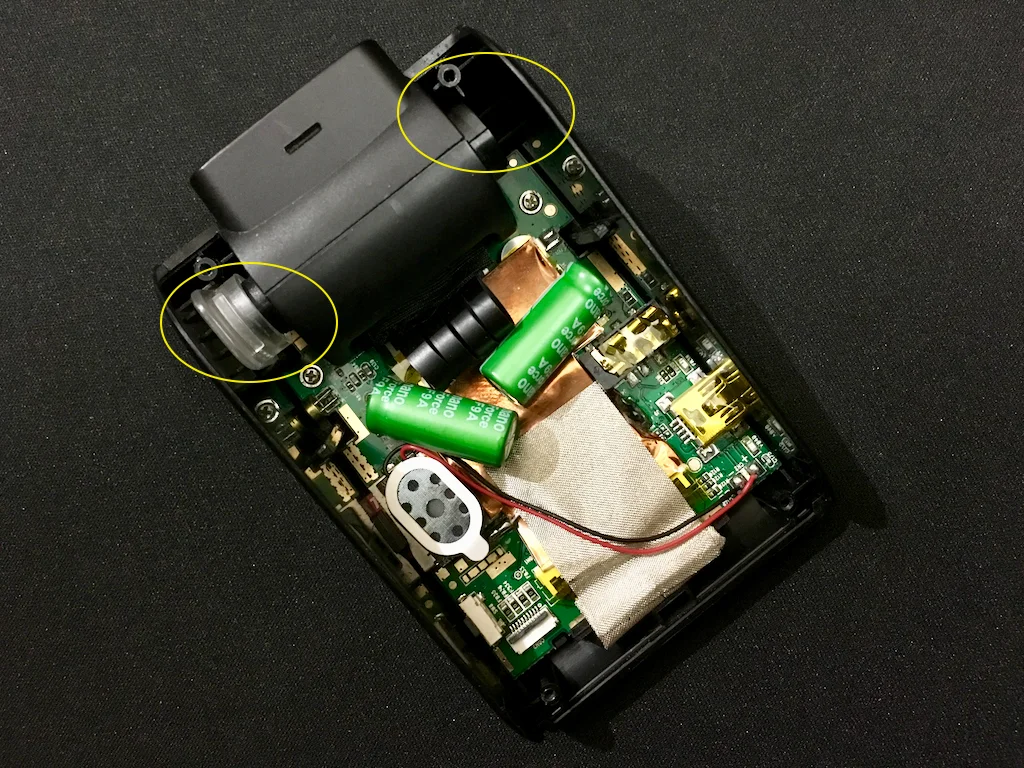

How about adding the same gear mechanism or a holder on the right too, should reduce free movement between the clicks.
View attachment 34383 View attachment 34384 View attachment 34385
I suppose it all depends on what is causing the corruption. The camera will do all sorts of strange things when the ribbon cable isn't connected properly. It's not always the same result. Could be the degree of the poor connection. What I experienced could have nothing to do with the XXXXX issue, but I feel it's something to keep in mind. I do find it odd that most have never experienced this (including myself on my personal cameras) and those that have experienced it, have seen it multiple times.
