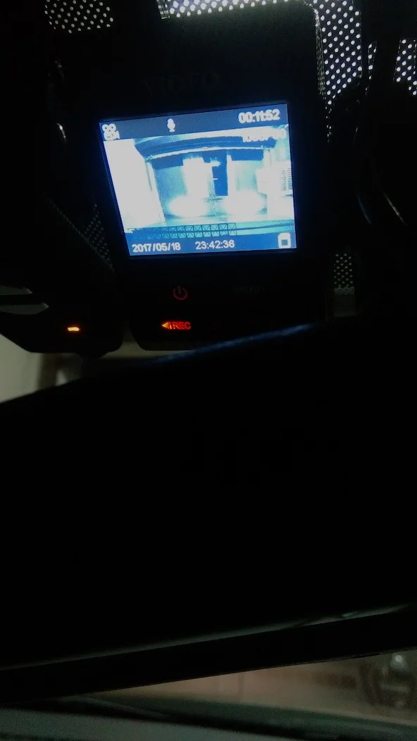

Got the boxes error for the very first time while on V 1.2 on the 18th, just before V1.4 was released. The camera had not been recording for the past 2 days! Didn't mention it then as 1.4 was supposed to fix this.
Flashed V 1.4 and reset the camera to defaults, didn't see the boxes again.
Flashed V 1.6 yesterday and saw the boxes again today.
This is a serious issue that affects reliability, needs to be dealt with ASAP!

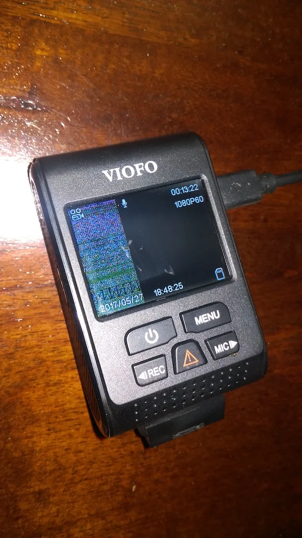

When you reinstall the firmware, does it fix your screen as well?
Reinstalling the firmware brings the camera back to normal but this seems to be a temporary fix.
Have the A119S running on a power bank since reinstalling 1.6, looks to be recording normally. Will report if it acts up again.
Yes, I know reinstalling temporarily fixes the xxxxx issue, but I'm curious about why your screen in the last picture looks messed up on the left half. Does that occur with the xxxxx issue as well.
