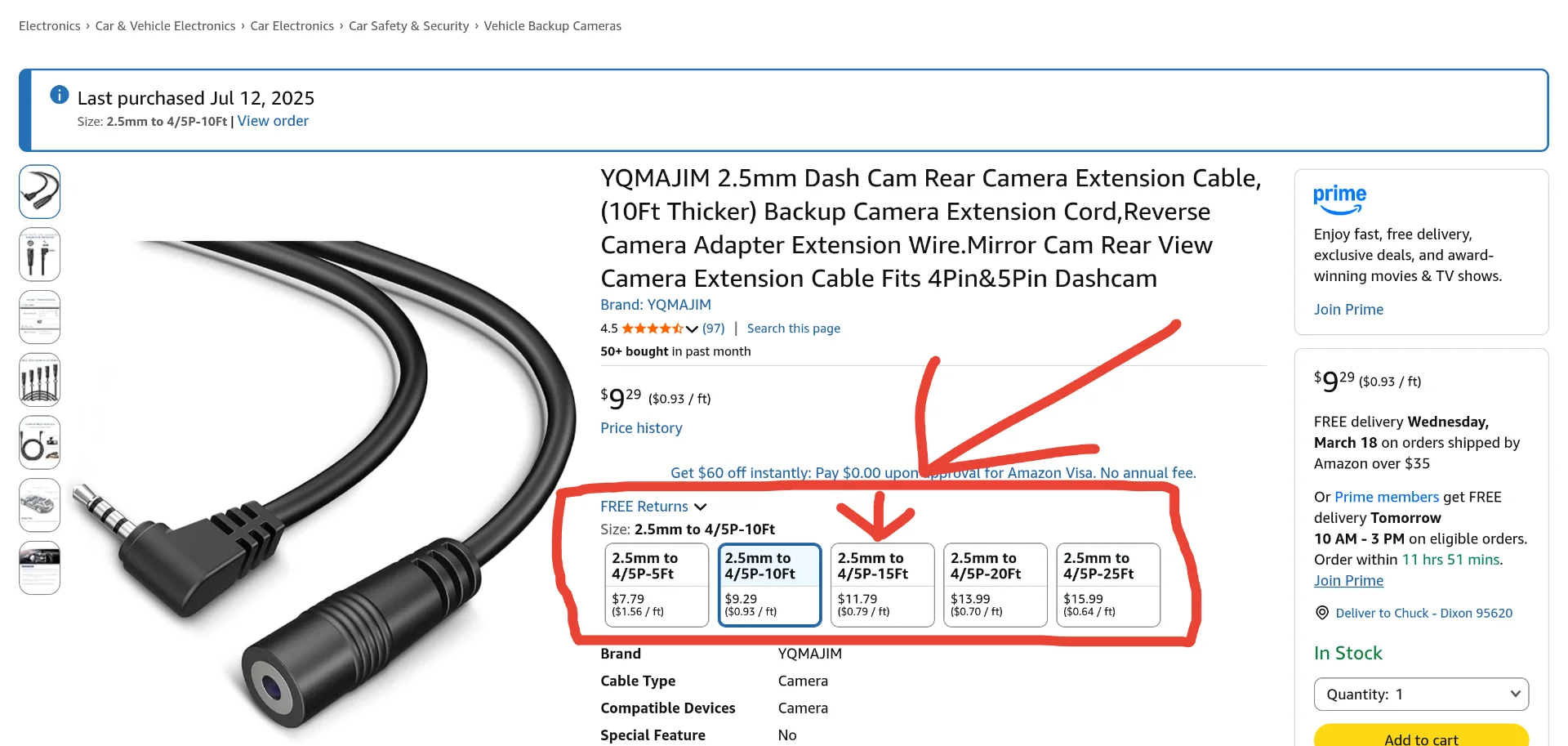

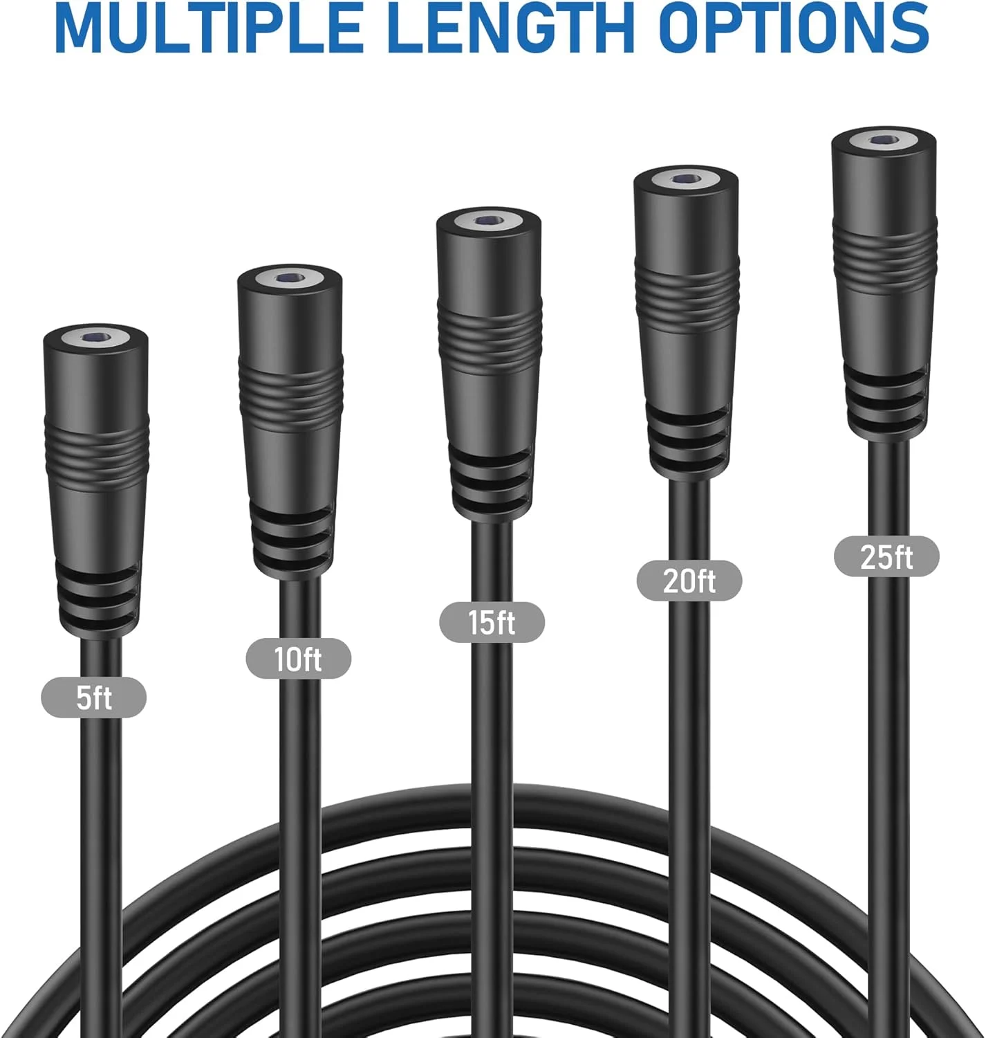

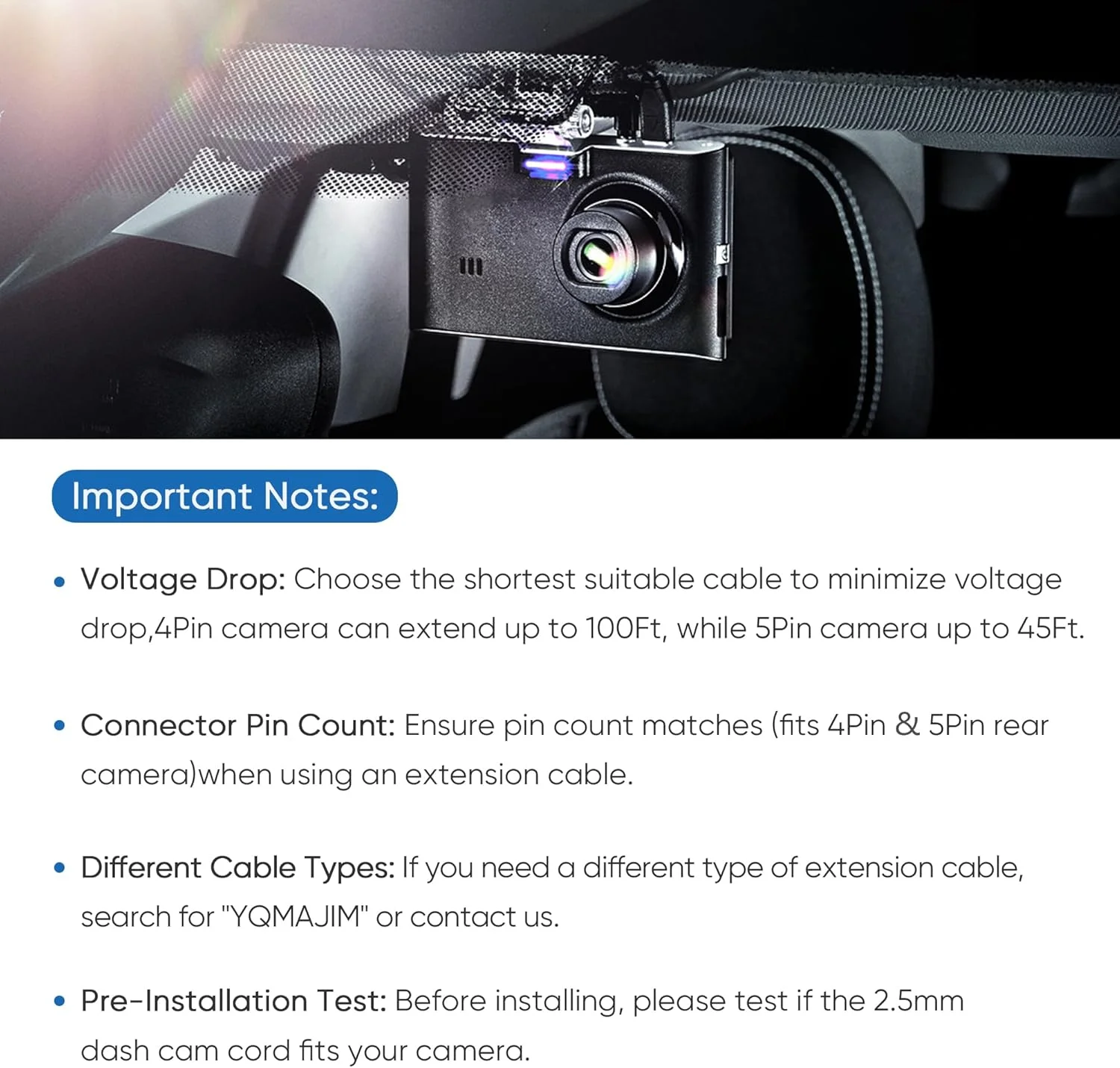

Are you asking that the S1 4K front-facing camera be in a waterproof housing and mounted on the rear bumper of the pickup truck? Is that correct? The S1 4K front-facing camera, as it is now, can be placed inside the flat-glassed rear window and work quite well. Due to the GPS mount, there is ample room to adjust the lens.
AFAIK the extension cable for the interior camera is available only in 3m length.
I wonder if two extension cables can be connected together if needed (provided that one wants to install the interior camera near the rear window, and the 3+1 m cabling is not enough)?

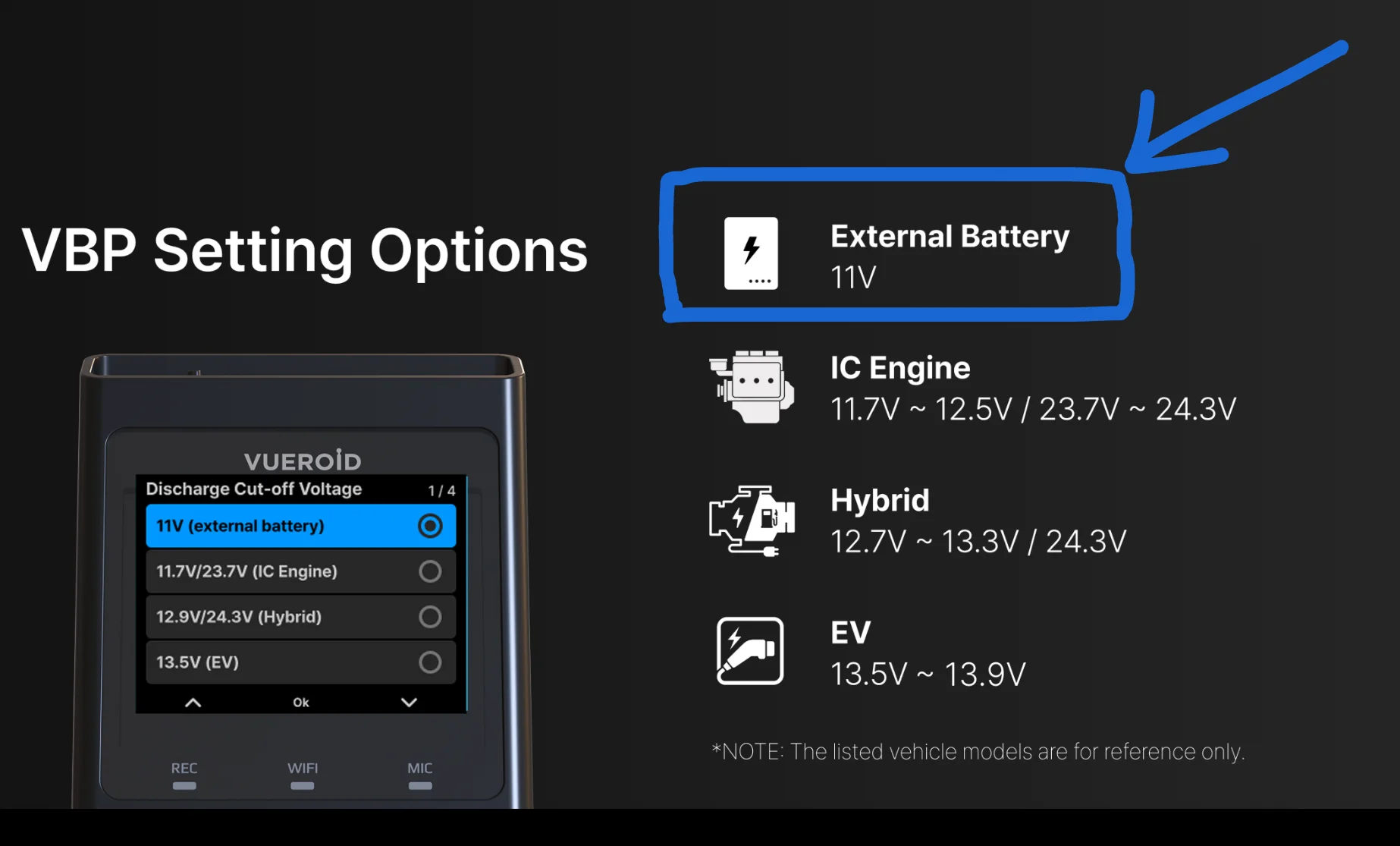

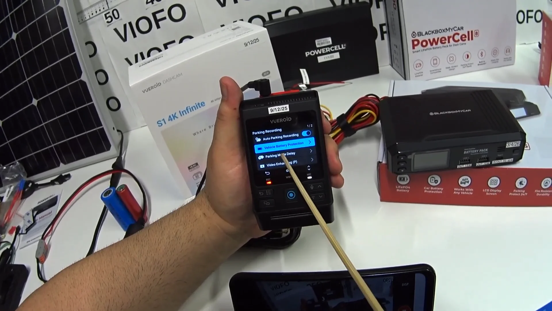

I know you guys are busy with a thousand different things, but I noticed something when connecting S1-4K Infinite to a Dash Cam Battery Pack.
The current firmware setting for VBP (vehicle battery protection) for Dash Cam Cam Battery Packs, (external battery) is 11.0V.
Dash Cam Battery Packs discharge all the way down to 10.0V.
This means the current firmware setting will pre-maturely cut off power to S1-4K before 100% capacity has been drained from the Dash Cam Battery Pack.
Based on my testing this will reduce parking mode operation run time by 30 Minutes to 90 Minutes based on channel configuration, (1/2/3 CH).
Because S1-4K has ELPID (Extreme Low Power Impact Detection) at 1mA, or below this could make an even bigger difference in parking mode operation run time.
I would like to request an additional VBP firmware setting; “OFF”
OFF will completely disable voltage cut-off, and allow full capacity of the Dash Cam Battery Pack to power the camera, and provide the longest possible parking mode operation run time.
Basically, the current 11.0V setting when used with a Dash Cam Battery Pack is like leaving two sips of Soju in the bottle.
I want my last two sips. lol
Skip to 30:45 for a video explanation of what I’m talking about;

recently we add new funtion which can run normal parking mode until cut off volatage , and then one reach the cut off volatage , S1 will turn to ELPM mode .
so in case of Battery pack usage , if user set the power off voltage to 11.0 and set the low poer mode entry time to Auto , S1 will run normal parking mode until 11.0 V ,and then change mode to ELPM .
and also I know your point. we will consider this point for the next release .
within this week , we will release new firmware .
thank for your interesting and suggestion .

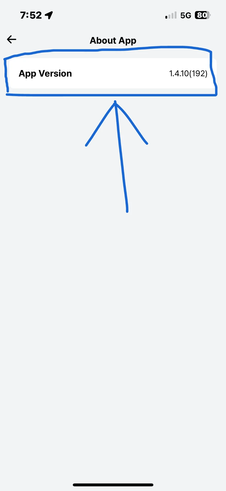

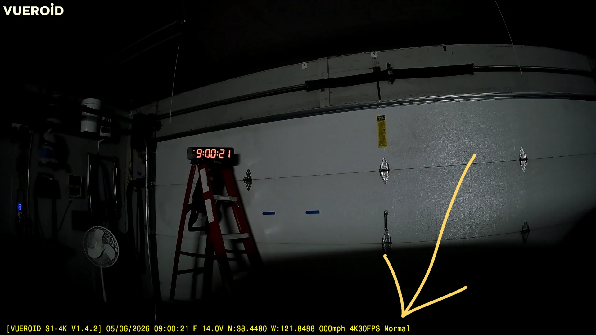

HDR Timer results in 4 Second recording lapse during transition, (8 Seconds per day).
Any lapse in recording is unacceptable.
Here’s what the recording lapse looks like, (occurs at 9:00:21AM)
LCD Screen on S1-4K goes black during recording lapse.
Can this be be fixed?

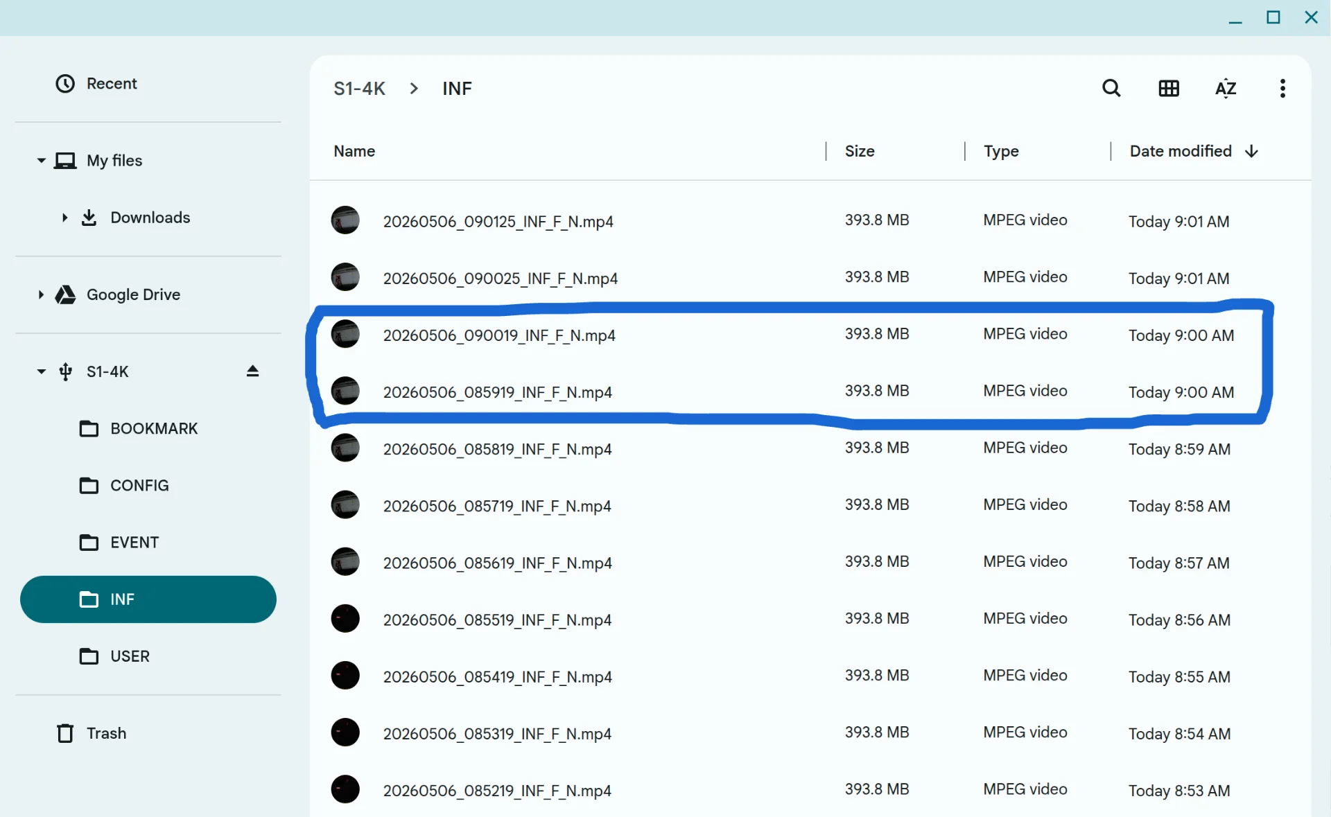

My question would be: "Does changing HDR/SDR type modes result in closing a file and opening a new file?"
for change ISP mode , we have to stop recoding and reinit ISP , So S1 close current file and open new file with new mode . we try to be shorten loss period . current is our best .
yes.. close current file , open new file with new mode

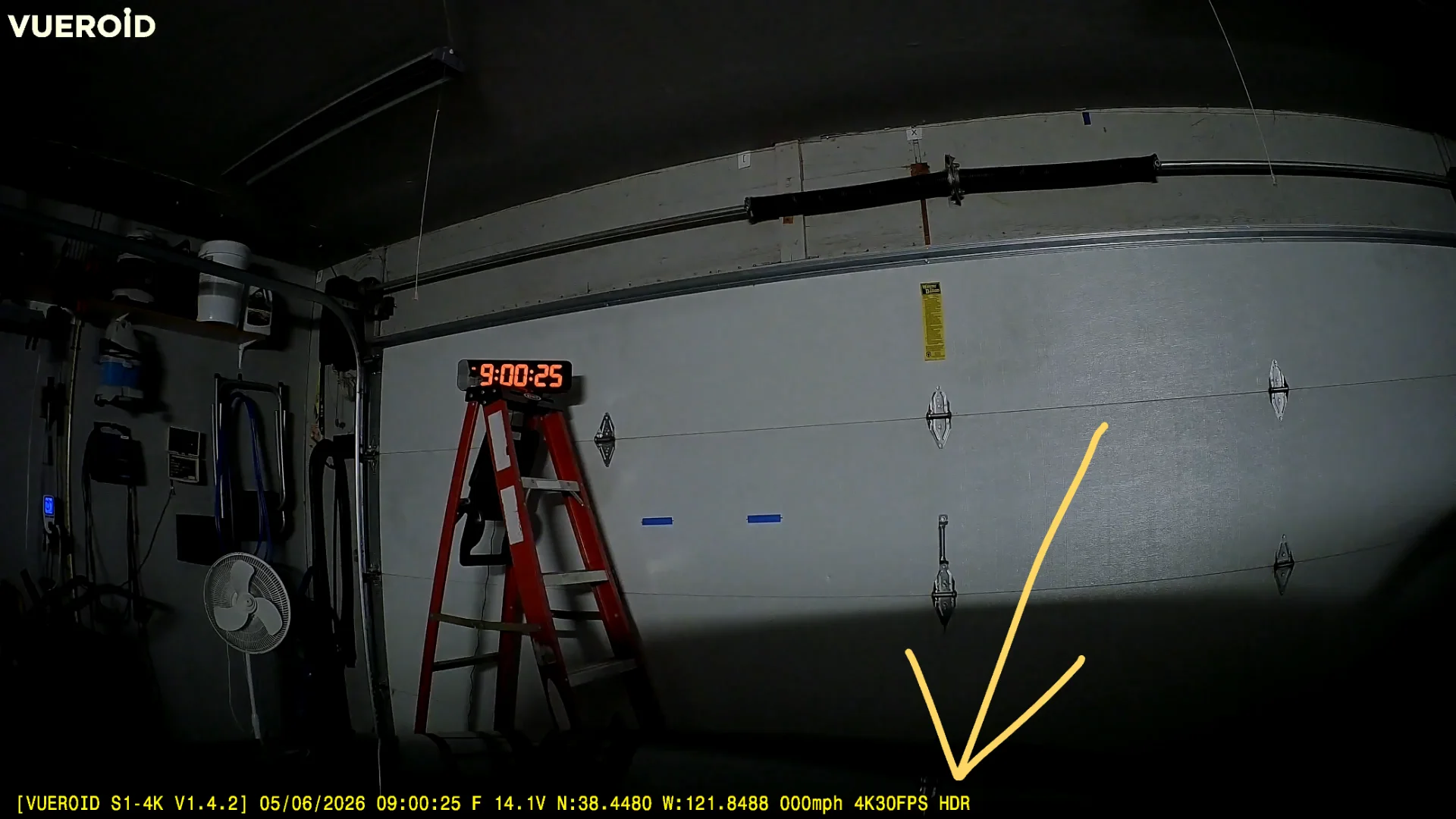

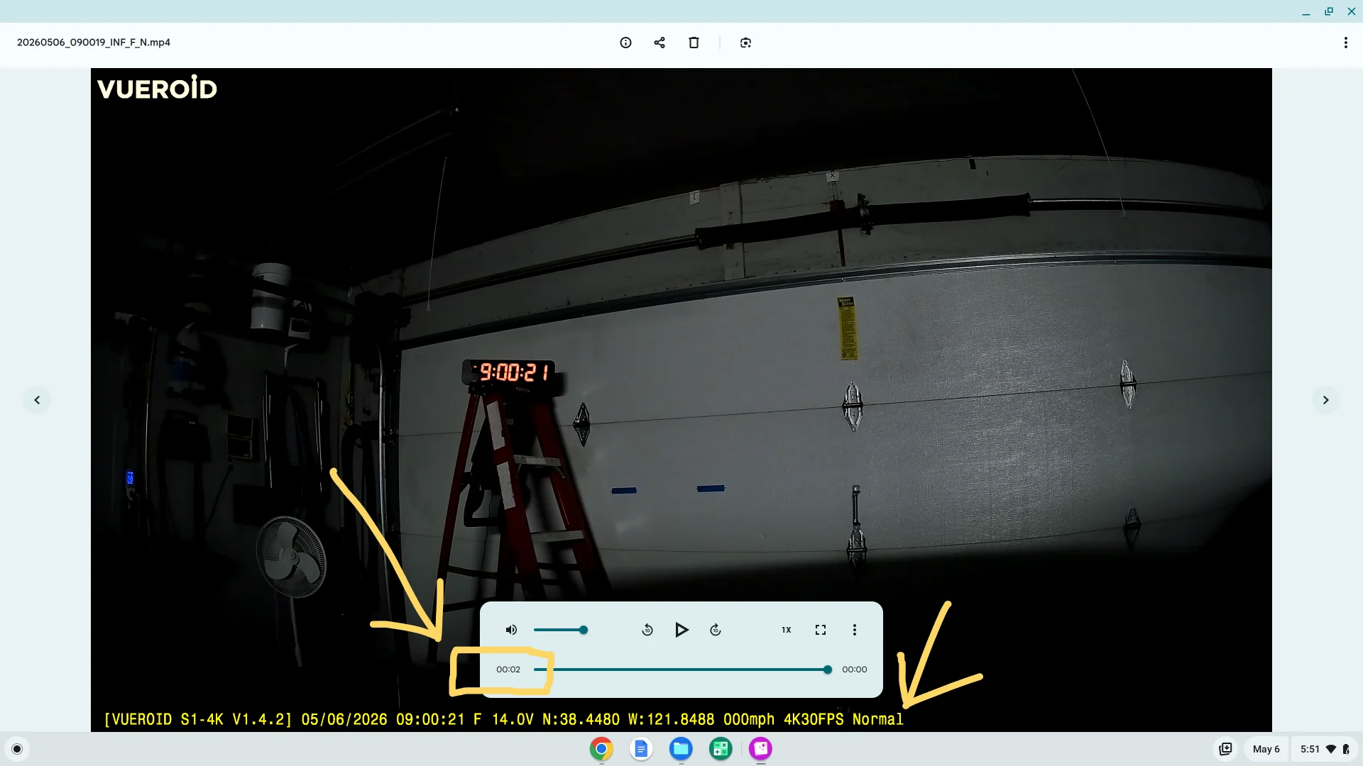

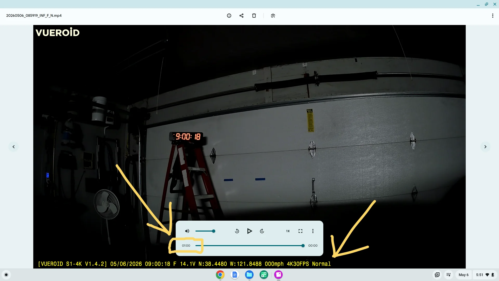

I set HDR timer for 9:00AM.
S1-4K stopped recording at 9:00:18AM.
It started a new 393.8MB file that is only 2 Seconds long 9:00:18AM to 9:00:21AM.
It started a new 393.8MB file that is 1 Minute long at 9:00:25AM.
From 9:00:21AM to 9:00:25AM S1-4K is not recording for 4 Seconds.
This is unacceptable.
What if there is an incident in those 4 Seconds that S1-4K is not recording.
The customer’s expectation is the camera will not stop recording.
1.) Can we just have one single ISP video setting for day & night so this 4 Second recording lapse will not occur?

so user can use non timed configuration , we provide this option(timed) for user convenience.
user can use linear only , or HDR only , or IPC only . the best license plate capture is timed IPC , but it has shortcome ( 8 seconds video loss)
Do you think we remove timed feature if we can not avolid video loss during change mode ?
linear and HDR is totall different operation as you konw , the output of image sensor is different .
we will add comments the risk of video loss with timed configuration . this is the our best I think.
we cannot overcome .

If the user is concerned about losing approximately 8 seconds per day, there is simply no need to enable this option. That’s all.
Regarding video loss when the timer triggers:
Manufacturers need to explicitly mention this in the manual.
This ensures the user is aware of what to expect and can then decide—based on that information—whether or not to use the timer.
