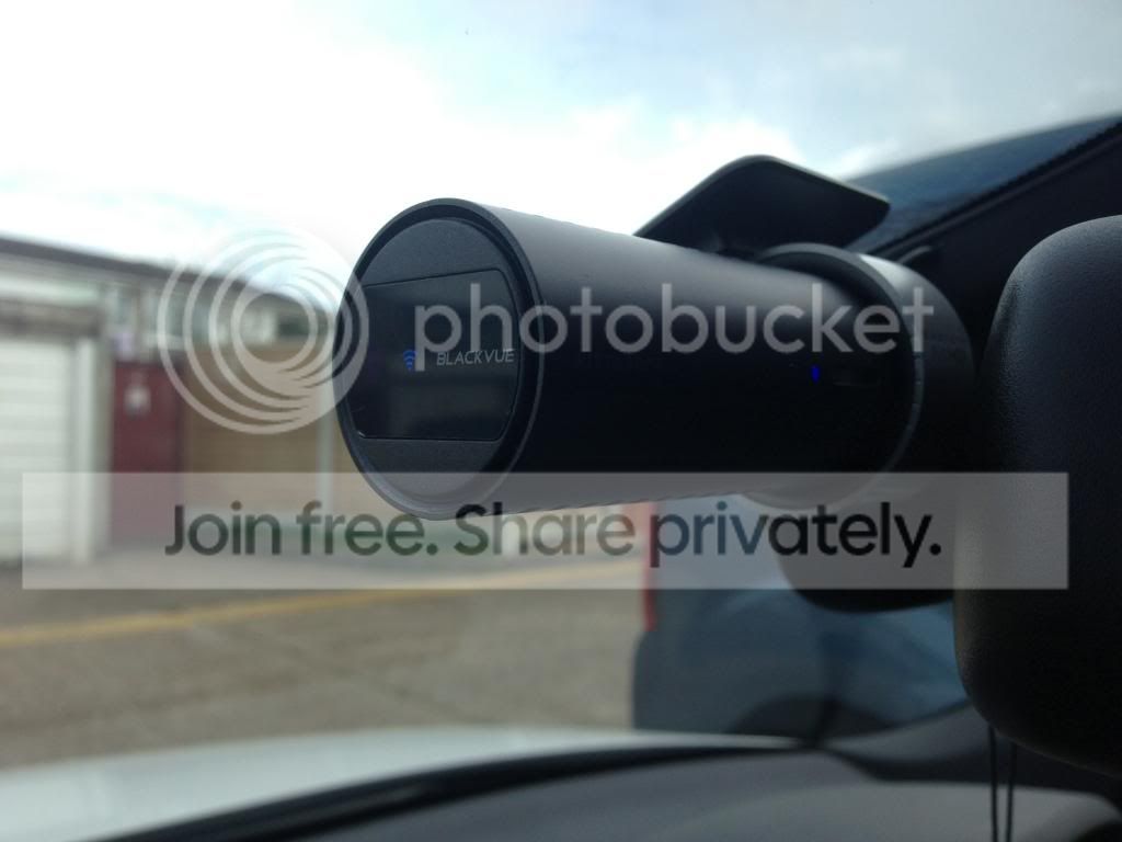

Synaptixx said:
For those of you who mounted on the anti-glare part of the windshield (the black dot part), do you have any problems removing the adhesive from it? Does it do any damage to it? I want to mount my dashcam at the highest point, near the center, but afraid to stick it to the antiglare material.
You can simply put the heating on (windshield one) full blast for a five minutes, the heat softens the 3M sticker, and it comes off much easier when using a flat head instrument like a screw driver. Tried and tested!

I relocated it to the black dots on the upper part of my windscreen. It's a lot better but the Lukas is still on the big side in my opinion.
But at least is full black. And you could move it upper, with just the lens to be under the black part of the windshield, and half of the camera to be hidden under the black area.
enjoy,
Mtz
Yeh that would of been better. I can't remember why I didn't mount it further up.
I think it was getting caught on the mirror. I didn't want it too far off centre also as the mount bracket is not that adjustable.
