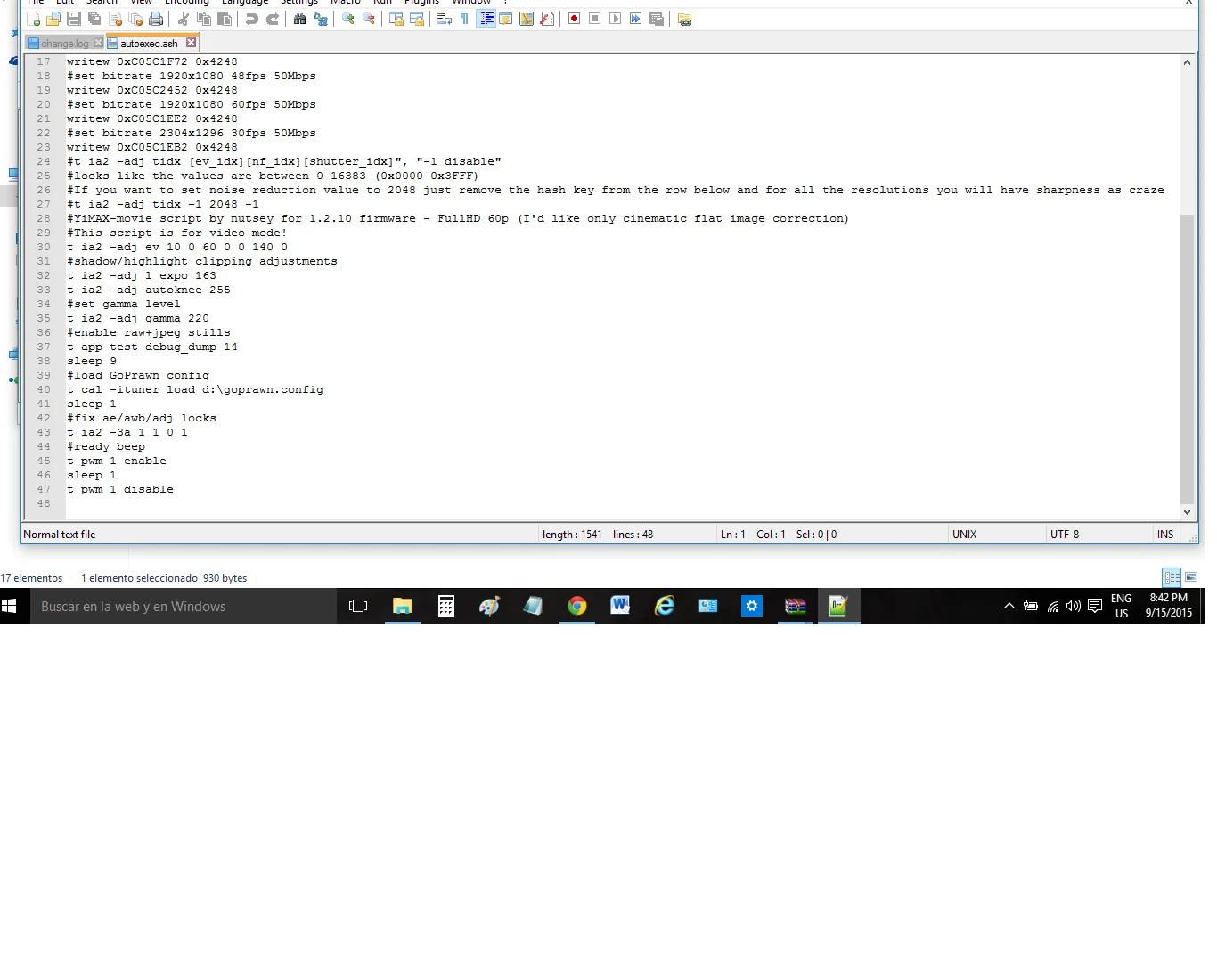

ok Thank you again for your time 🙂. this what I got when I open the autoexec.ash (image below) what's next, do I need to copy-paste on there the file you sent to me? and then save?
sorry man, I'm to green
Thank you
Thank you
You have 2 files to deal with:
1 - autoexec.ash
2 - GoPrawn.config
Put both of those files on the MicroSD card you will use in the camera. Don't put them in any folders, just loose on the card. That's it.
Then start the camera and let the magic happen! Try not to be disappointed - it's not mind-blowing... unless you're a really sensitive guy 🙂
