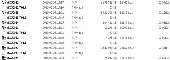

Hi, here is an other test after last week...
This time the yi was flashed with Fried's firmware (Z22) and I tried the 4GB split script. You can see the results int the attached file.
My setup was the following: class10 microsd card with ~80Mbps writing speed (tested with h2testw many times), resolution was set to fullhd@fps (with Fried's firmware the bitrate is 35 Mbps), fully charged aftermartket Kingma battery (works well, with these settings it lasts about 80 minutes) .
So, any idea folks?
P.S.: yesterday evening I used the same package to shoot a lot of time-lapse and normal videos, and here is the thing: files without strange 3-4 secs splittage or bitrate decrease.
P.S.: You see the file names, let me explain it. After 44 I turned off the cam, then I turned it on and switched it to photo mode, took some photos, then I turned it off again, then after turned on again I started to record the video (file 61, 3 secs). Maybe something went wrong during the mode switching? I'm not a pro, but my opinion is there is a bug somewhere connected the mode switch and the higher bitrate...Makes it any sense? Oh, and I didn't use my phone and wifi was off all the time. And this time there are no missing footages, just the split and the bitrate thing.Névtelen.jpg
