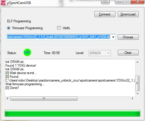

The firmware programming took 58seconds to finish for me. And then the status turns from Wait to OK.
If your windows can't find the driver. Then point it to the location your installed the yiSportCamUSB software. There's a driver folder there.
C:\Program Files (x86)\XiaoYi\yiSportCamUSB\Driver
Once the driver was installed properly, the yiSportCamUSB program Foun 1 YDXJ device!

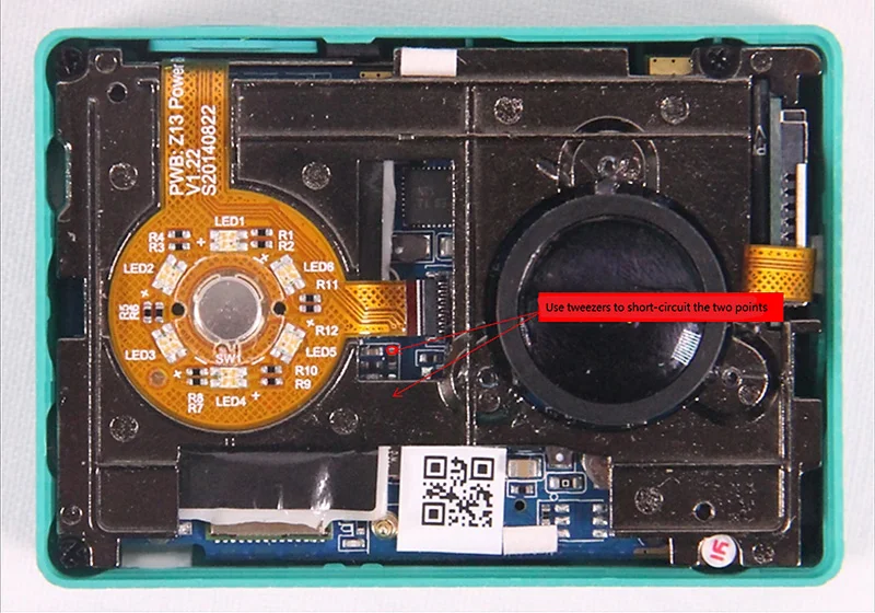

BTW, for those without access to PowerPoint. Here is the point to ground. Simply touch that point to the metal chassis. I used a paper clip. It was easier to bend than tweezers.
Thanks Cruz!!
