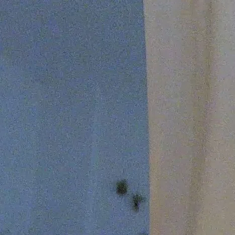

2) I booted the Yitune mode and did some testing in low-light (indoors). My footage has crazy amounts of noise. Is this normal for the Yi? Is it just high ISO? I've seen some footage on Youtube and it didn't seem nearly as bad as my footage. I've added a screenshot for reference.
3) Is there any way to set a fixed ISO and shutter speed/exposure in video mode?
