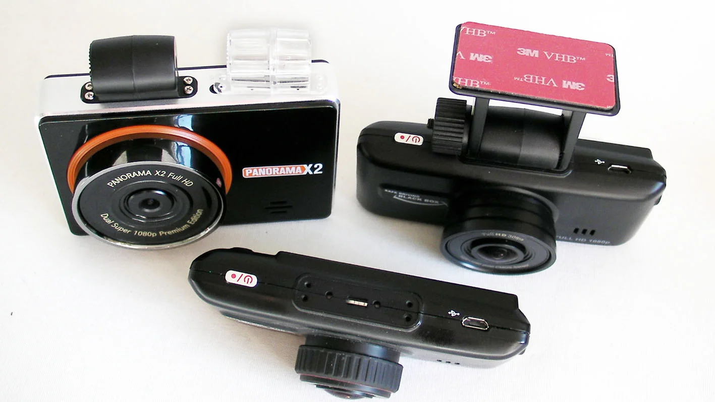

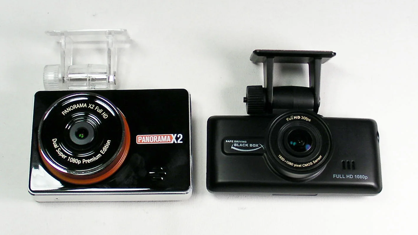

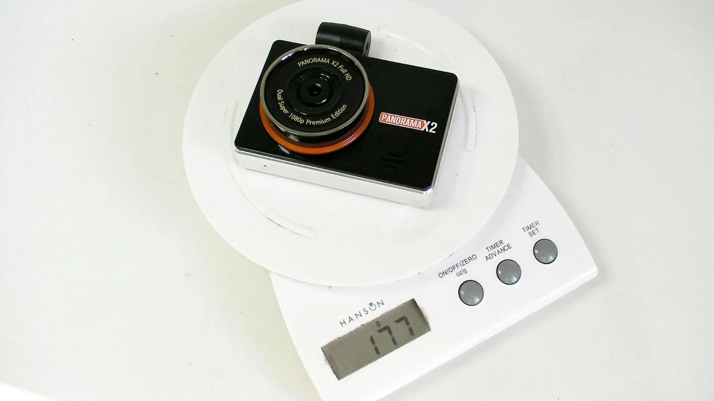

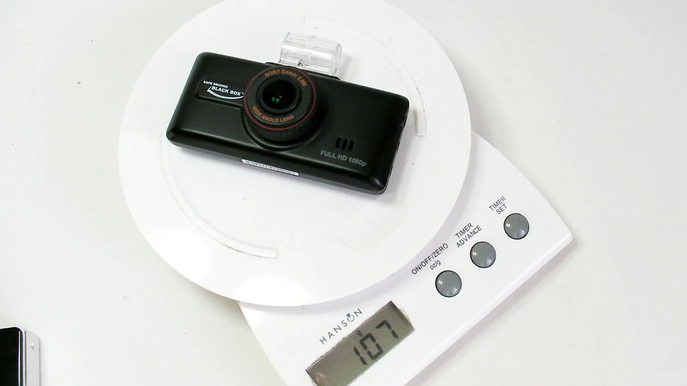

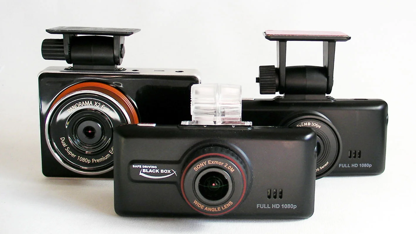

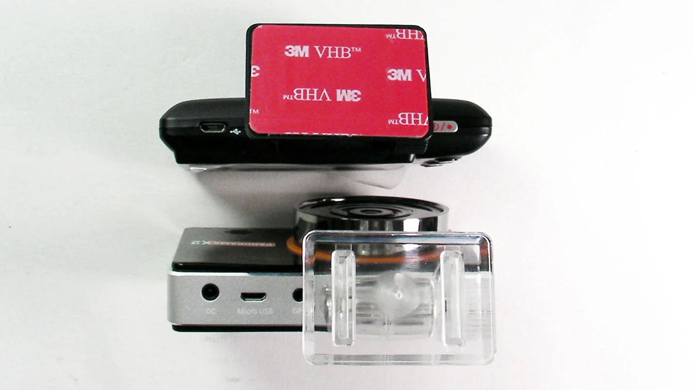

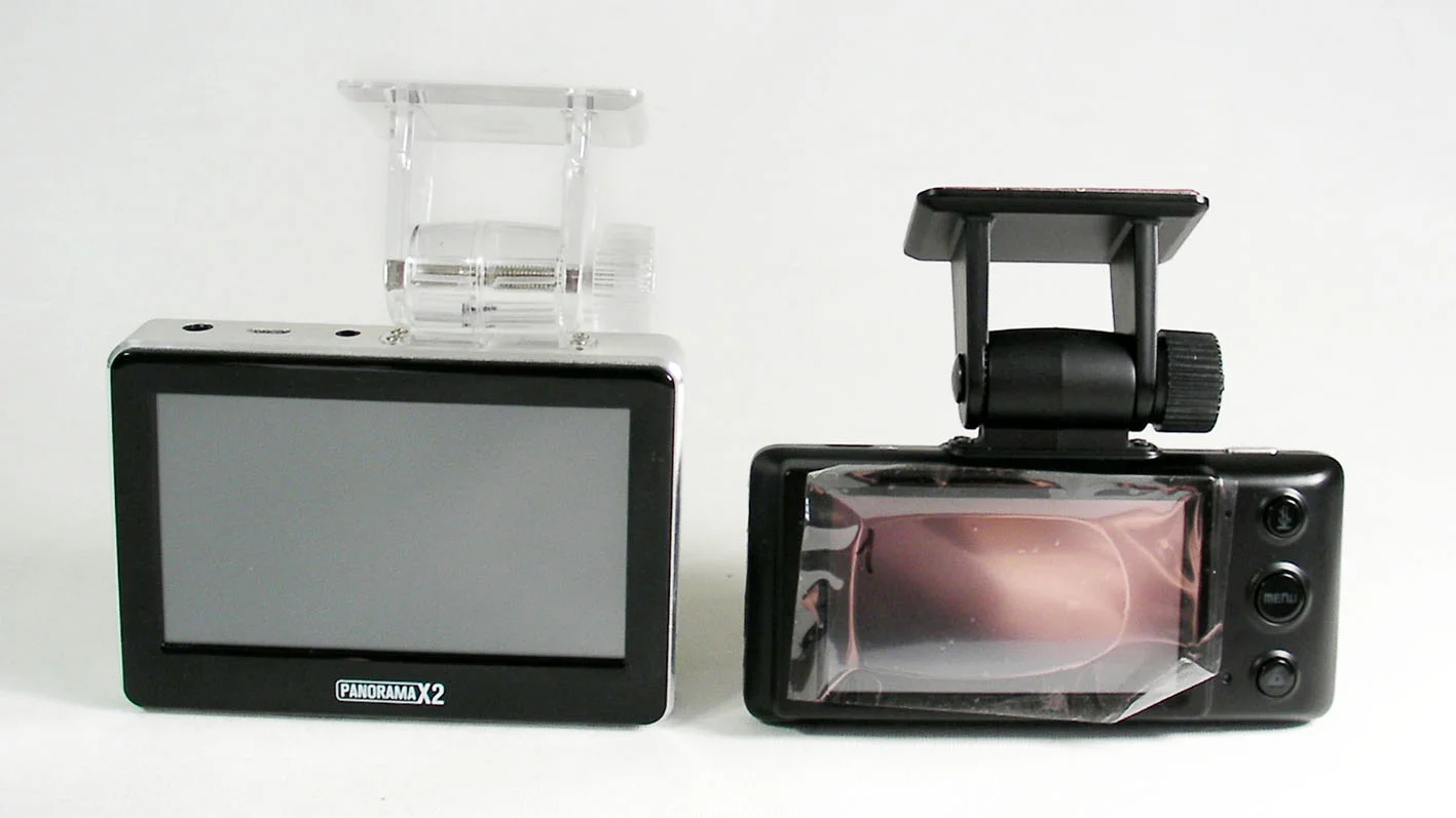

Below is size / weight comparison between Panorama S and X2.
Overall size "volume" ( including bracket ) I would say its nearly similar.
X2 is narrower than S, and its slightly higher, but combined volume looks the same.
( P.S. - dont forget the fact that S model cables connectors are on the side, so if they are connected, - the overall width looks about 1 cm wider. ). So, Pano X2 having cables ports on top is a good choice.
Although weight is much heavier due to many extra hardware used ( aluminium edge frame, inner EMI / RFI metal plate ( full body size ) etc.
On my last pictures you see I have already swapped bracket holders ( clear to black ) for more "unified discrete look".

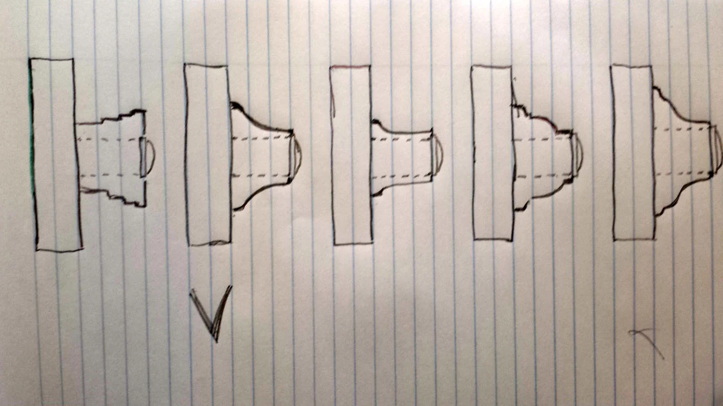

Front bulky lens surrounding re-design idea is also what I would be interested in. More like going smoothly from main body flat surface to lens part.
We have to "accept" X2 as is, because this particular model is prototype for Korean market, so some cometic changes may be made before it goes International. Just patience ! ;) . But of course all proposals are welcome.
Below are few of my childish-scribbles :)
First pics is to have same housing like Panorama S / G to fit a CPL filter. Second is if there is no CPL. ( Personally I don't use it, but maybe many would ).
... or even make lens surrounding interchangeable for customers for extra $ to buy as an optional accessory ? ( not practical idea probably )

I would need to improve my CAD-"skills" ( @ my scribble above, LOL ).
For those not using the filter I was planning a 1mm lip to cover the text on the front of the lens without interfering with the field of view. This would just slide on the lenses housing and could easily be removed to install the filter. I was planning on producing covers and selling them myself, but it makes more since to provide them to a dashcam seller. Keeps my cost down.

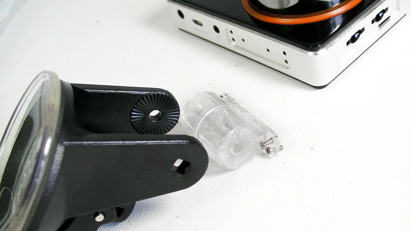

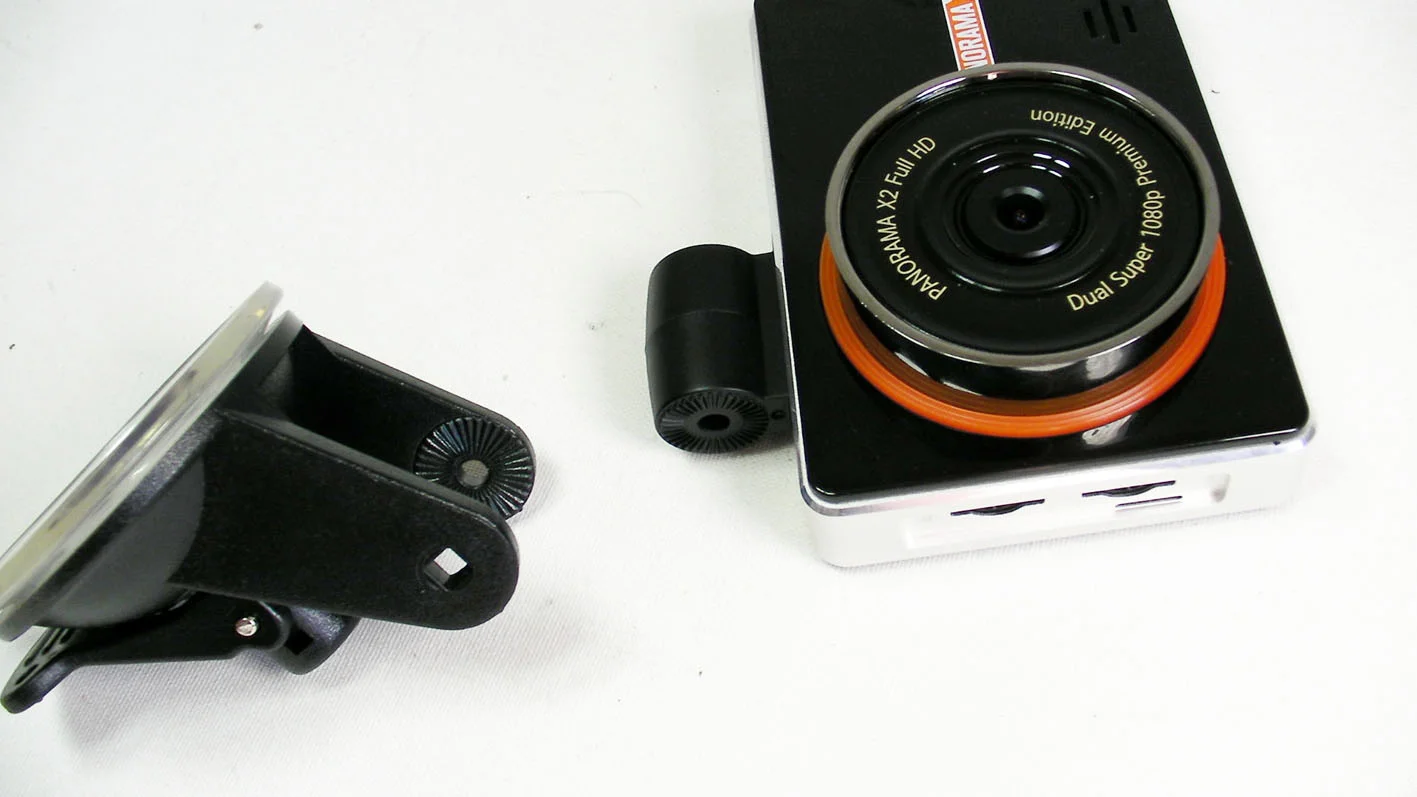

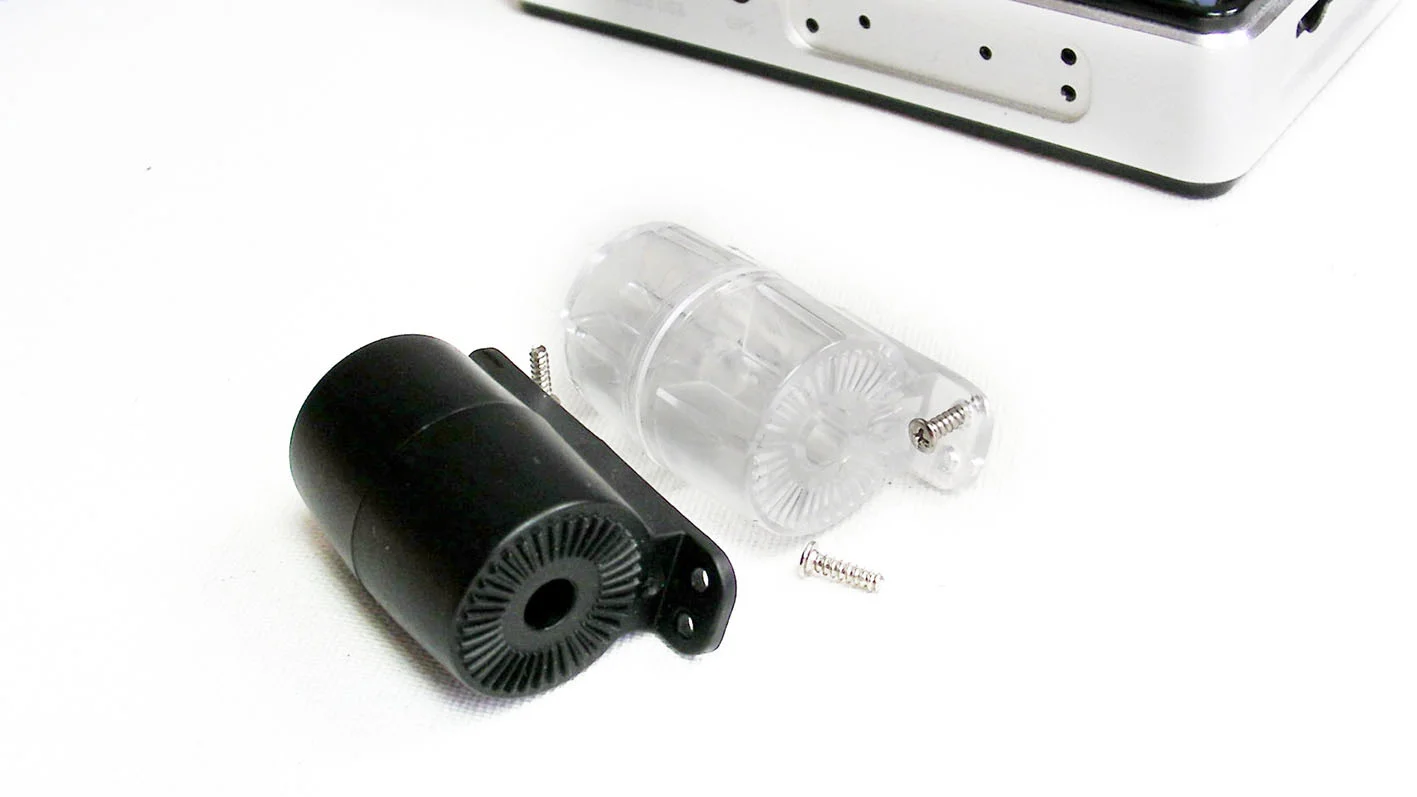

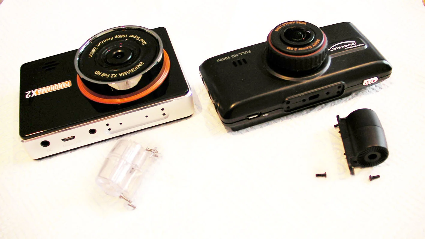

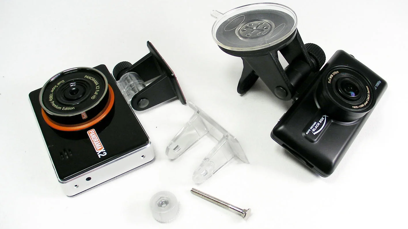

Regarding Panorama X2 bracket / mount / holder ... compatibility of suction mount.

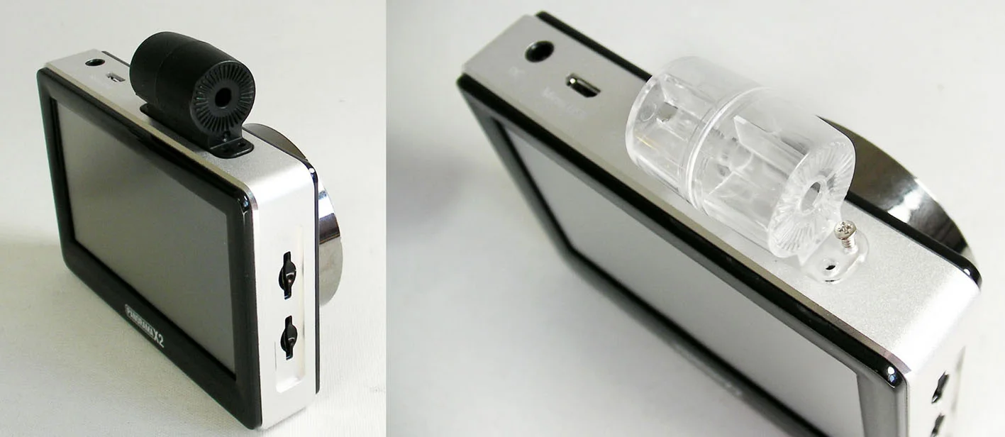

Prototype ( Korean version ) X2 has clear plastic bracket holder and bracket. Of course its up to idnividual taste, but myself I prefer black. Having Panorama 2 / S, I tried to swap clear to black.
Bracket holder is the same size as on Panorama 2 / S, so it is fully compatible with X2 and it is possible* to use same suction mount as used on Panorama S / 2 for those who want attach-detach dashcamera.

The only small issue comes to correspondence of Cotter Pins and Fixed Vertical position notches at the base sides of the pivot bracket mount to the notches on the Suction mount.
Below you see notches are on the right side of the original mount.
Suction mount notches are on the left side of bracket arm. So, in order to use a suction mount, you need to reverse a mount.

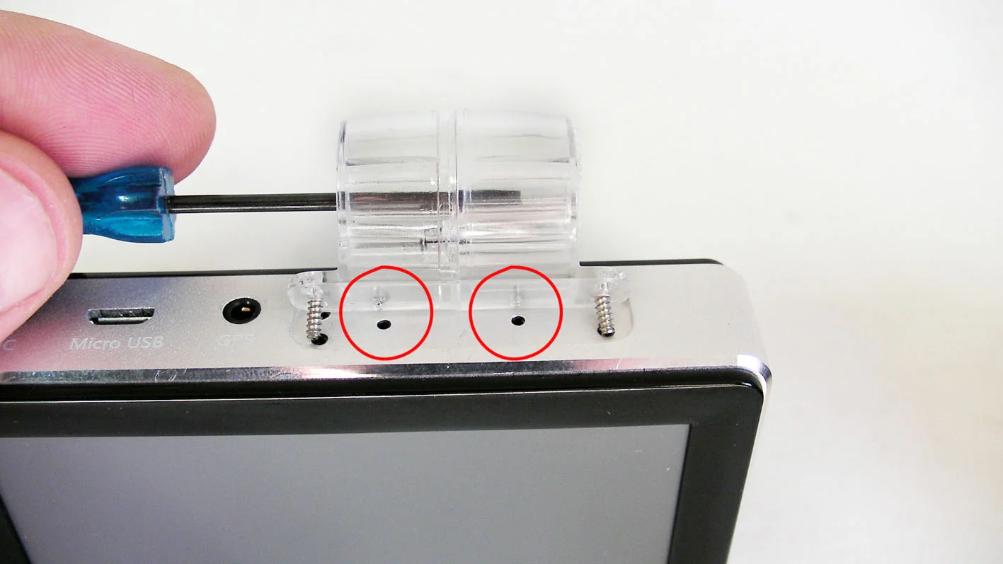

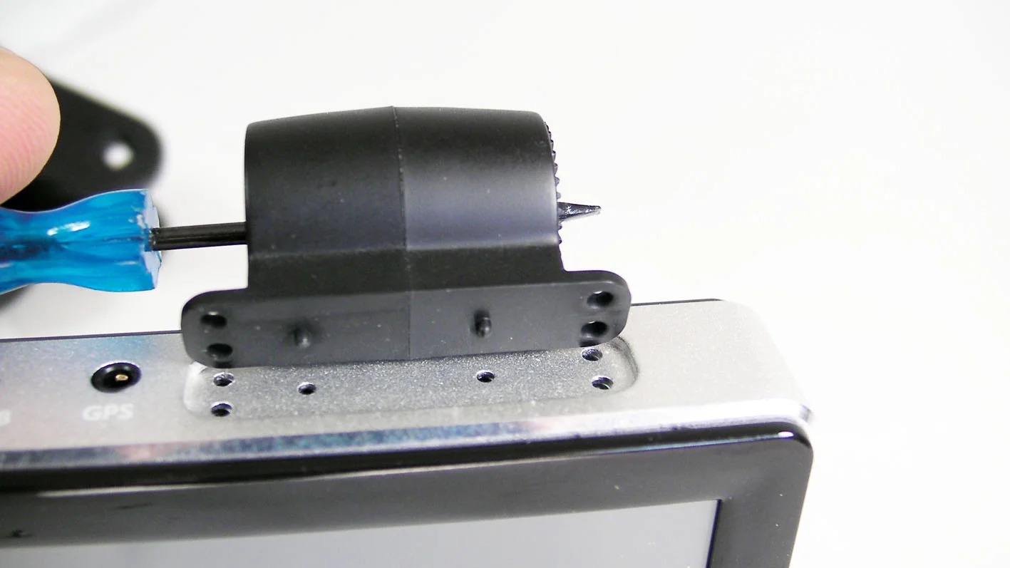

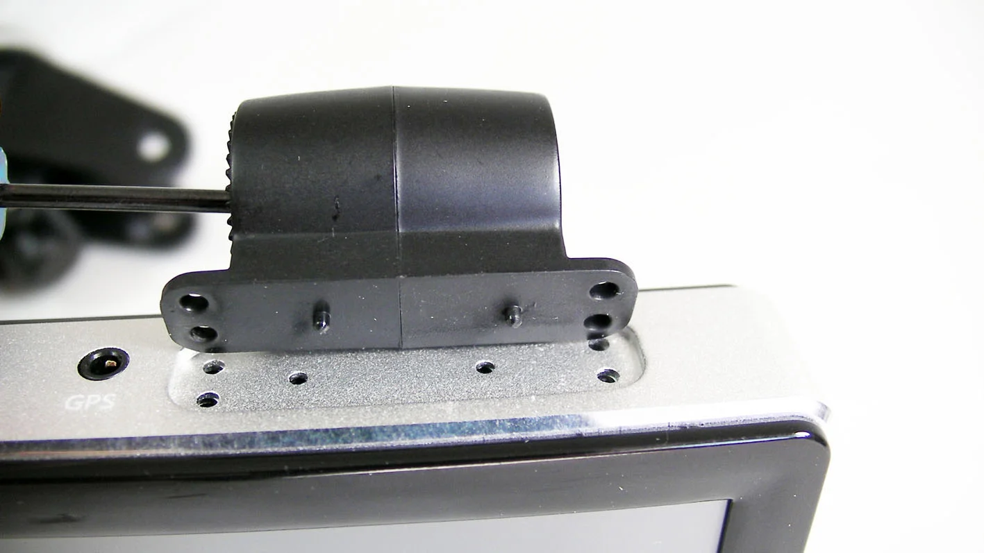

However ...
when reversing a mount ( no matter is it original X2 clear or black colour from s / 2 model ), - the mount pins are not matching main unit holes.
You may cut those mount pins, - this way you can mount bracket holder in reverse. This procedure is for suction mount use.

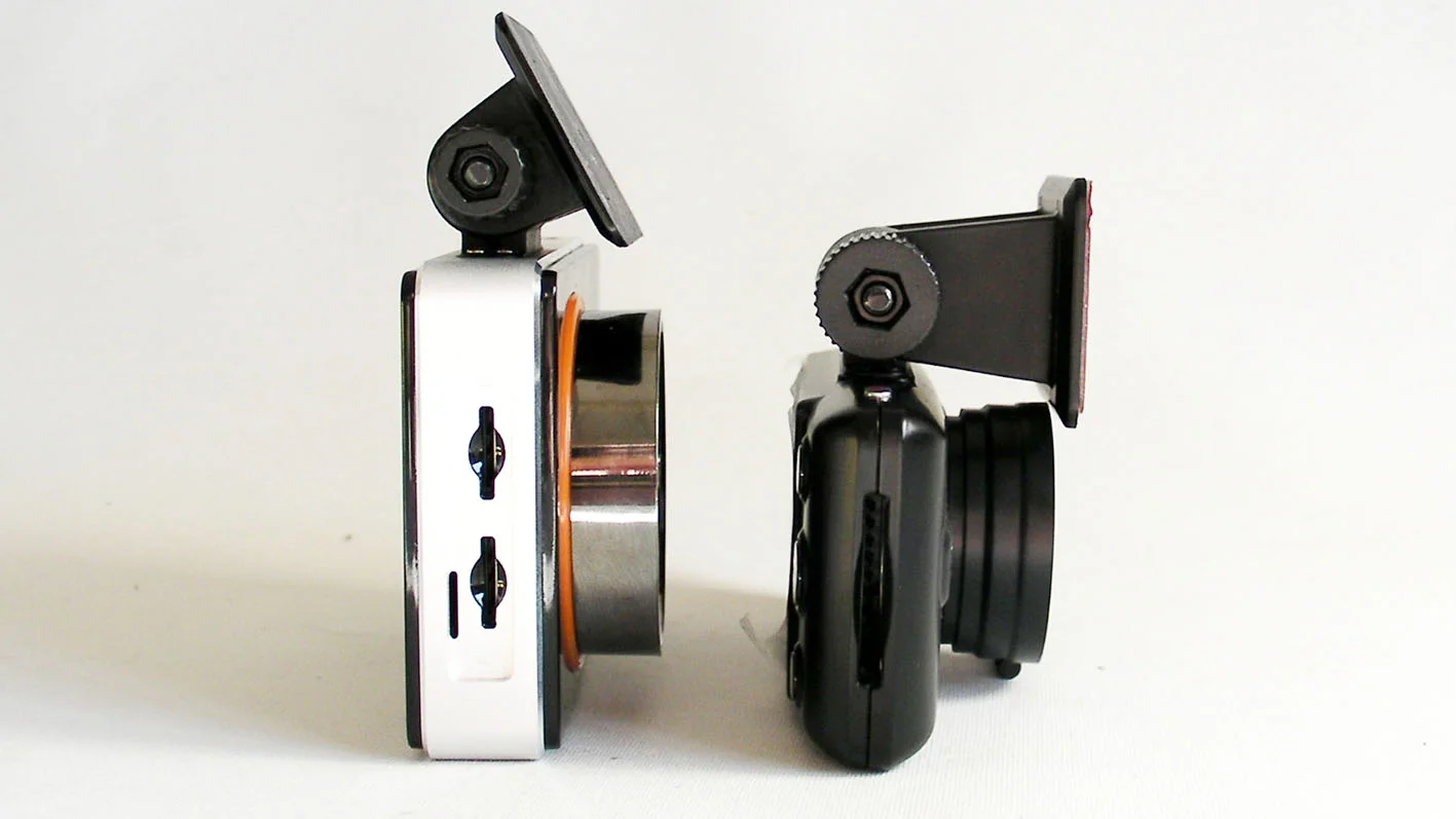

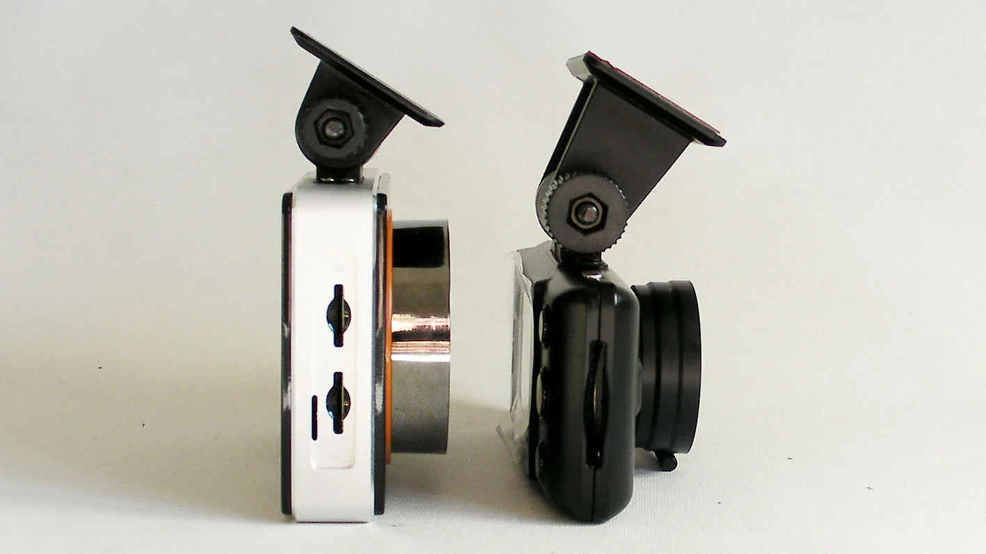

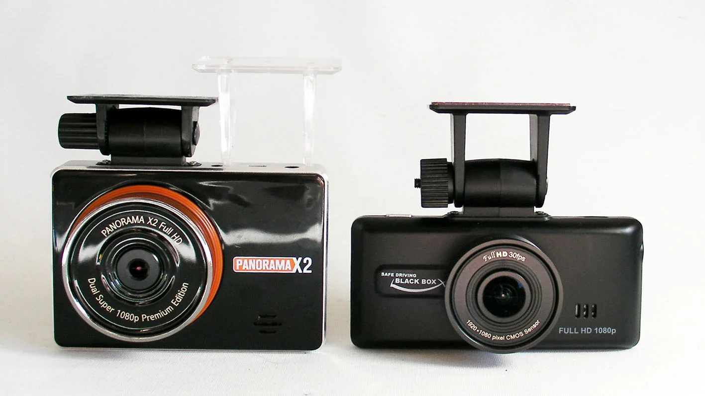

When mounting in the car, for me personally it is very important to mount it as close to windshield as possible. For this purpose I have swapped original long-arm mount to short-arm DIY bracket which I made "ages" ago for Panorama 2. It is about 1/2 inch shorter than original one.
Below is the result. The overall hight of Panorama X2 with DIY short-arm bracket is nearly the same as Panorama S with original size mount, but X2 is slightly narrower. Not bad ;)
WIth this set-up it is very promising to achieve more close to windshield installation which I share in some of my future posts.
P.S. - for vehicles with fully vertical windshield ( bus, trucks, etc ), still need to use original long-arm mount, but for other cars with "angled" windhsiel, the short-arm mount is good way to bring X2 even more close to windshield.
