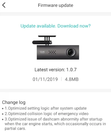

Btw, on 1.0.7 the hotspot is open on startup by default and the led flashes all the time, I don't want to click it every time I start the car. Any idea?
No “Update succeeded” prompt updating from Chinese 1.0 zero, but it worked.FIRMWARE for Chinese Version (CN)
[with English voice acting and English voice control]
v.1.0.7 eu
Take picture
- Record video
- Record without sound
- Record with sound
- Turn off Wi-Fi
- Turn on Wi-Fi
- Take out TF card and insert it to your computer (or using a USB converter to connect computer).
- Download the file named SD_CardDV.bin to the root directory of TF card.
- Insert the TF card and keep the power cable is charging.
- The device will automatically upgrade. DO NOT discharge until the voice prompt “Update succeeded” is over.
SD_CarDV_1.0.7_(for CN version)_ENG VOICE AND CONTROL.zip
