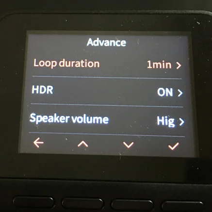

These instructions are very helpful. If you are looking for an easy way to translate the menus and you are using an iPhone/iPad, there is free software from Microsoft that will do the job. It's called "Translator". You point your camera at the screen (in real-time) and press the camera icon that appears on the screen of the "Translator" app. It will instantly convert all of the Chinese text to English in a stil-frame. For those who want a cheat sheet, here are the instructions I wrote to navigate the Chinese v107 firmware.
== To Factory Reset ==
1. Press the big button on the 70mai (wake up)
2. Press the Right most button on the 70mai (select settings)
3. Press the 2nd Right most button 7 times (select factory settings)
4. Press the Right most button on the 70mai (enter factory settings)
5. Press the Right most button on the 70mai (to "Confirm")
== To Select Advanced Settings ==
3. Press the 2nd Right most button 5 times (select advanced settings)
4. Press the Right most button on the 70mai (enter the advanced settings menu)
5. When in advanced settings, you will see the words "WDR" (even in the Chinese menus). Use the Right most button and navigate to the first menu option. Then press the Right most button to toggle WDR to "on"
