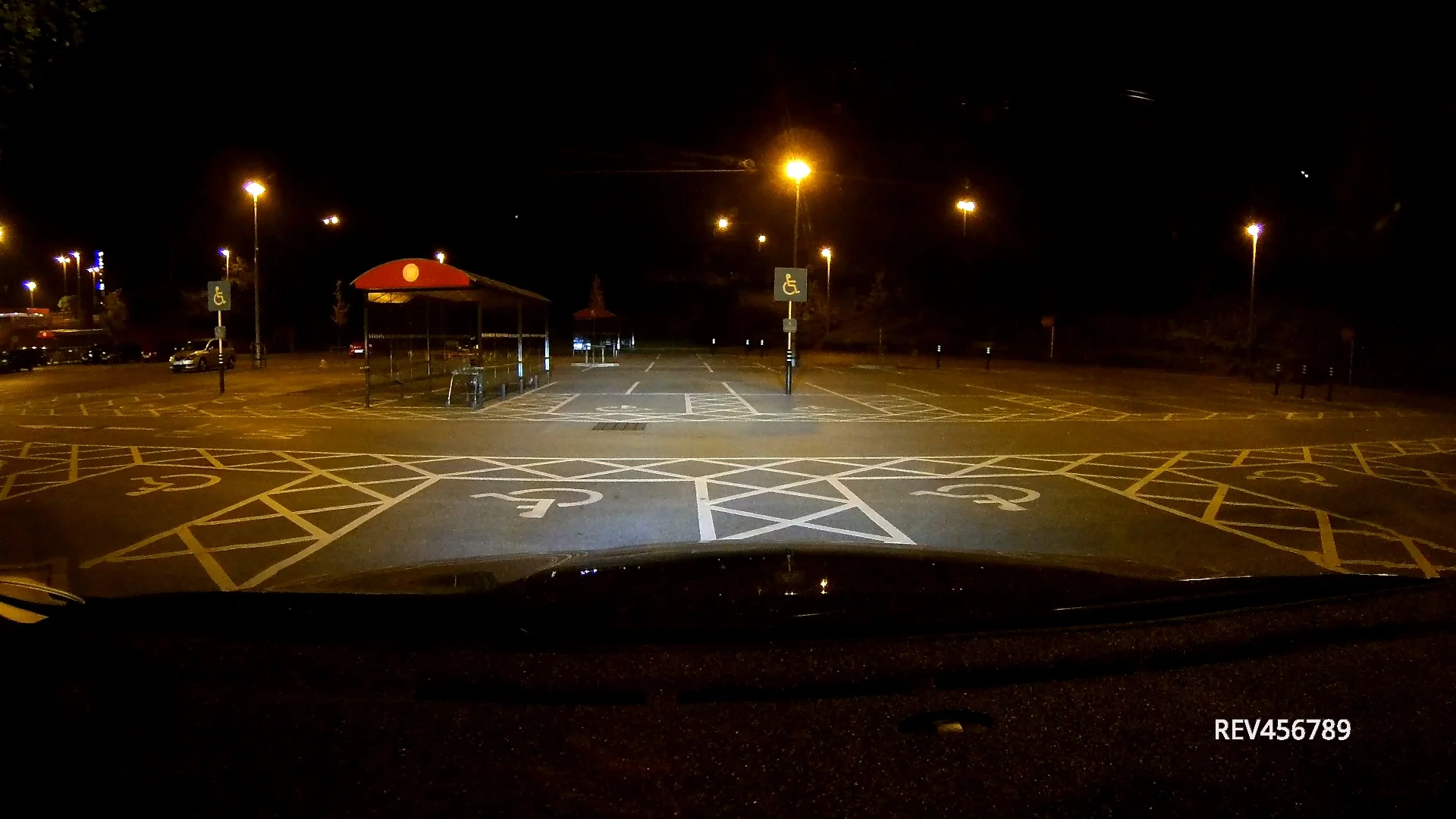

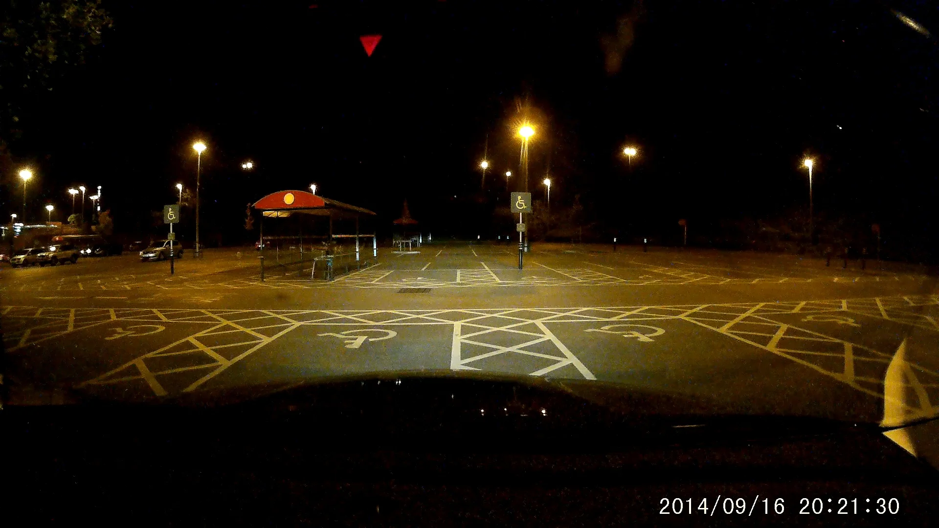

I've put the A118 up front today as a test and the day performance is fantastic, but the night performance is not so fantastic - the G90 and the Mobius definitely beat it with HDR on and off.
You can't beat that form factor though!
I'm intrigued to see what difference a new lens makes on these at night.
I'll post some screenshots when I get a chance
camping here... & thanks for sharing. hope this new model goes on sale in foxoffer soon. really have to admit the form-factor of A118 is almost 2nd to none ;)
Is the HDR setting supposed to do anything on these? Light levels look the same although there appear to be slightly fewer compression artifacts in the version with HDR although that could be anything like the sensor having cooled down a bit.
The HDR image looks to have a slightly cooler colour tone:
And for reference the G90 with HDR off in the same spot:
