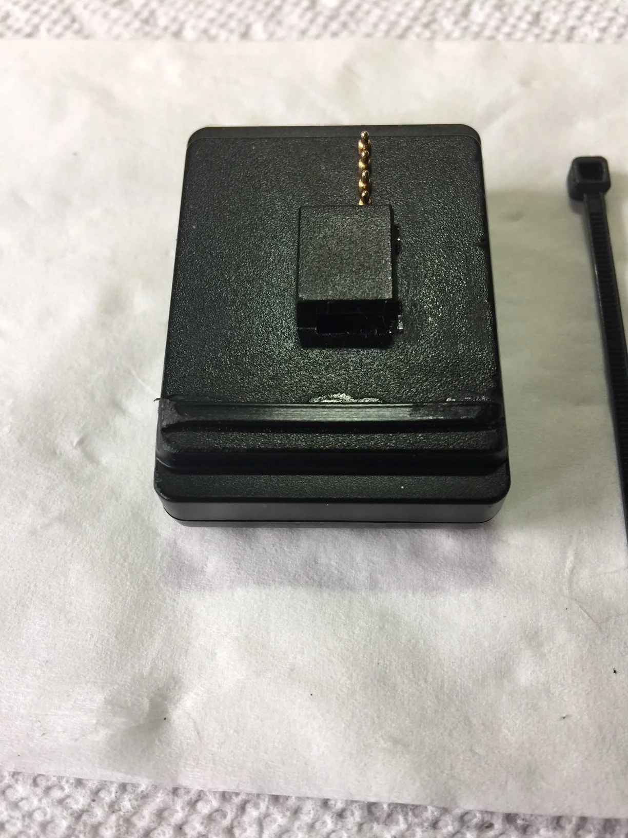

I have to replace 3M EVA foam pad. The camera is moving in the holder.
easy to fix, no foam required.
:: 25mm long 0.5mm thick end of a cable tie (or any other plastic) + crazy glue, v.1 (longer than 25mm, v.2 = 25mm) picture below, no camera movement on a (GPS) mount:

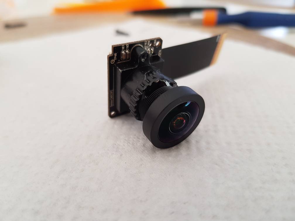

Can someone point me towards a link for the cable needed to set the focus when my new lens arrived. I only have monitors with hdmi.
The replacement Lens will be already Focused in metal holder mounted to sensor board. It ships as single unit as shown in Lens1 & Lens2 illustration above.
Use my Disassemble & ReFocus videos to simply disconnect original ribbon cable and connect to new Lens module. Do not over tighten the tiny screws into plastic.
Thanks and I thought I would need to re focus it myself and was asking what cable I would need like your old camcorder lead but I don't have a monitor with an old video input only a 2017 new 65" 4k tv which I use as a home media centre / PC monitor.
I wouldn't want anyone to go through all that intricate effort just to get perfect focus from a new Dashcam unless its your only option.
VIOFO is doing an excellent job handling Support Tickets today. Hopefully quality control improves as well so focus issues never occur again.
Take your time replacing the Lens module, usually it requires 2.5 Espresso/Cappuccinos for my hands to stop shaking.

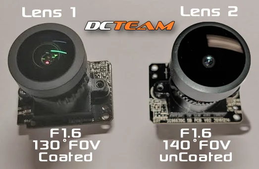

Which is the latest lens Viofo is shipping or is there a choice with the different FOV?110/140. I hope I get the same lens as lukasz.pl as this is the best footage I have seen in 37 pages of tests.
@ lukasz.pl Which lens do you have please.
There is no choice of Lens when buying retail A119S, it comes with whatever production line used that week. Unknown what you will receive unless you specifically requested lukasz.pl Lens1. Just to be clear Lens1 / Lens2 is DCTeam ID not official, just makes it easier to reference in the Forum. We need much more footage to compare the true differences between them besides the obvious Field of View. This is another reason I selected A119S for retail purchase, it can be modified many different ways and handles 28Mbps BitRate heat as @gse proved during more than 3 months daily use in the summer.
I have the lens number one:

Judging by your comparison I don't see a difference in FOV, and it was said that Lens1 has 110 and Lens2 140 FOV. I would say they are very similar. What do you think?
