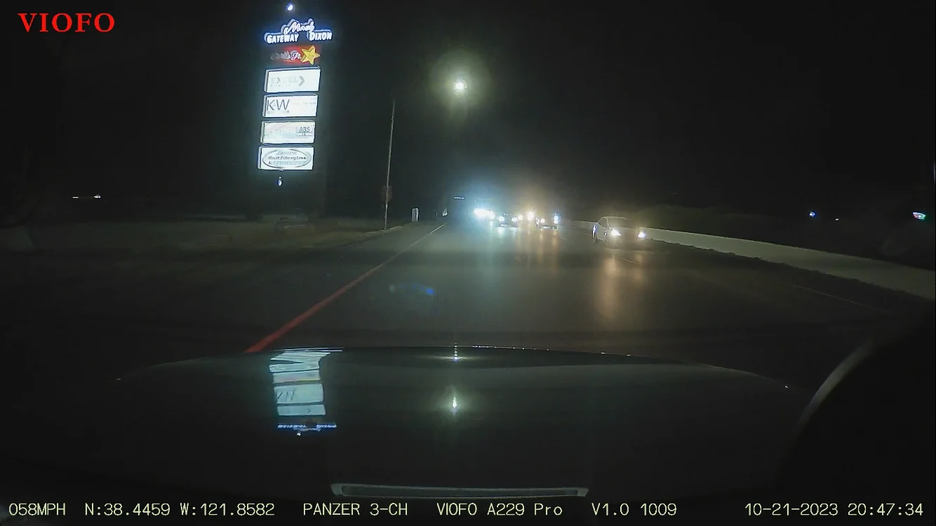

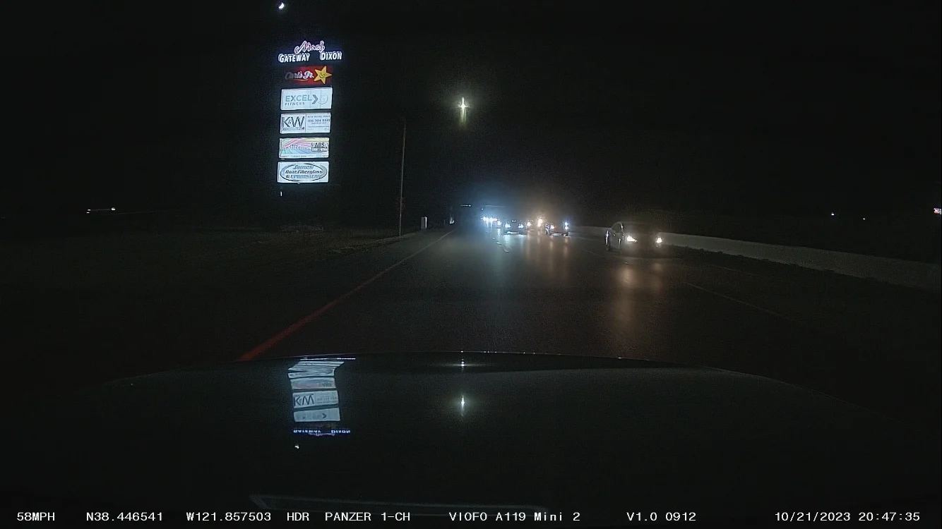

Here’s why I keep saying the A229 Pro & A229 Plus Rear HDR is unacceptable, (Front is just as bad).
@viofo @VIOFO-Support @safedrivesolutions @rcg530 @Vortex Radar
A229 Pro Firmware: 1009 + 0928
A119 Mini 2 Firmware: 0912
HDR: On (both)
Bitrate: Maximum (both)
CPL Filter: Off
Image Sensor: (IMX675) both
Vehicle headlights, lamp posts, and illuminated road sign are overexposed.

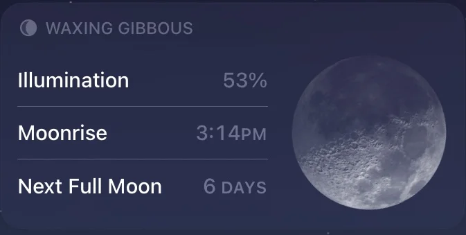

Even the Moon, (53% Waxing Gibbous).
HDR: On (both)
CPL Filter: Off
Here’s the videos;
HDR: On (both)
CPL Filter: Off
Here’s the videos;
Yeaaaa... The A119 Mini 2 just can't be beat!
It has been out longer though, so more time for them to refine it.
Glad i chose it for front and rear, instead of these new higher models with 2/3 channels.
I hope VIOFO refines the A229 Pro and other high models. They seem to have the potential to be just as good, or better than the A119 Mini2.
But seeing the samples testers here been posting, not all impressed with these "Pro" model.
They have quite abit of work to do.

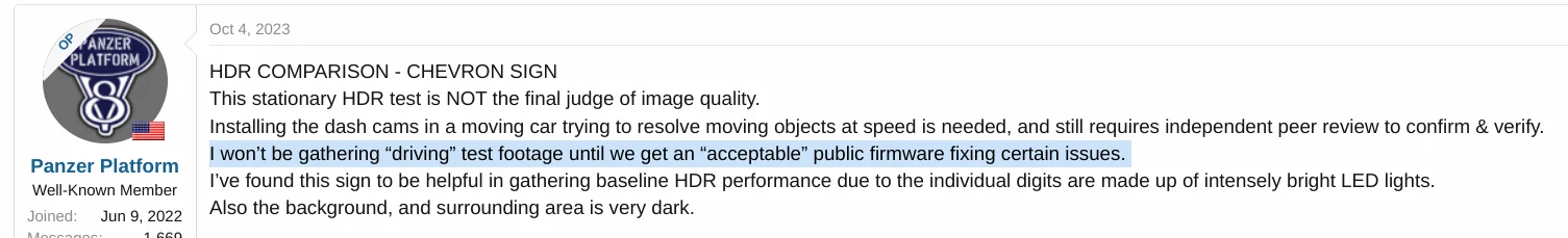

I've delayed getting "driving" test footage for the A229 Pro & A229 Plus because their firmware is unacceptable for a camera that's been released to the public.
It's "almost" a waste of gasoline driving around gathering test footage when the firmware & image quality is going to change drastically in the coming weeks.
If I had money to waste of gasoline I might, but I won't.
Sorry for the delay.
