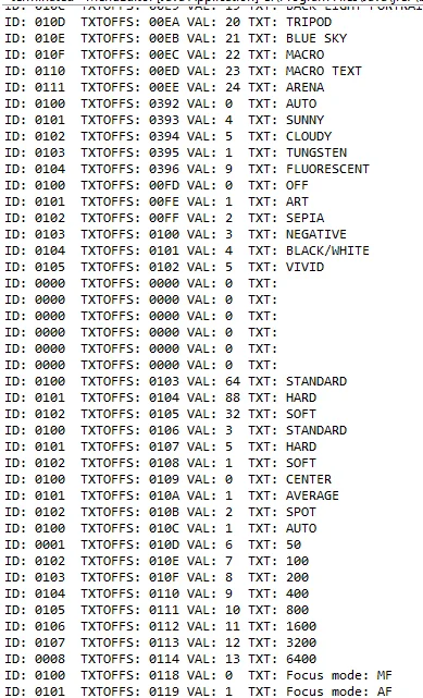

@Falsificator led me to the idea to add a new feature to A7Tool: A "settings-editor". It might be capable of editing the default values of all menu items.
But maybe I'll just add a "mapping"-generator which combinews text offset and value and prints them to a text-file.
Proof of concept:

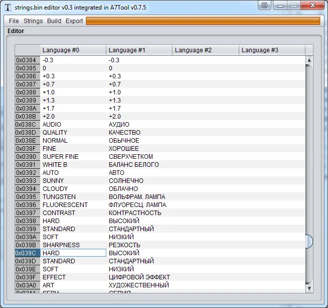

I also added a new column to the strings editor which shows the offset address of the strings:

- Added a new row to Strings editor which helps with changing predefine setting values
