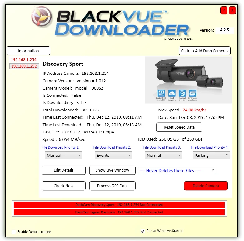

max speed under cam details is showing incorrectly
Hi,
Thanks for the feedback - but going to need a bit more info. Incorrect as not there, or wrong speed - or different to track data (because basically should be the same). GPS is reported in knots and converted to either km/hr or miles/hr depending on regional settings.
Only shows those gps dates that have been parsed, the parse GPS button checks all available.
Let me know what is what.
Thanks
Glenn

says i was going like example 2,076km/hr
Further to this - & lacking specific info - I suspect you are referring the the Google Maps Elevation Profile only?
With Blackvue Downloader max reported speed and all the track (click on the path) data being accurate?
I have now seen this as I have found some previously not used GPS files, by other download options. Essentially it appears to be a Google Earth 'error' as it is not seen in other GPS mapping programs for KML or KMZ files (KMZ is a zip file of KML- can rename KML it to Zip and unextract as needed)
I believe I have a fix, which is to skip duplicate timedates, which will update soon to 4.2.5... prefer to test for a bit because some of the other changes are more major.
This also brings some cosmetic changes, but more notably scaling compatibility for all devices/scales aspects.
Hopefully all going well, in the store by Xmas...

Are the updates to the program automatic? Or are you notified within the program, and are the free once you pay?
Also - I have the box checked for "run at startup" yet the app does does not run at startup on my Windows 10.
Yeah, actually this is the same for me. I thought it was just me. Standard win 10 x64 installation, no tweaks or fiddling about.
