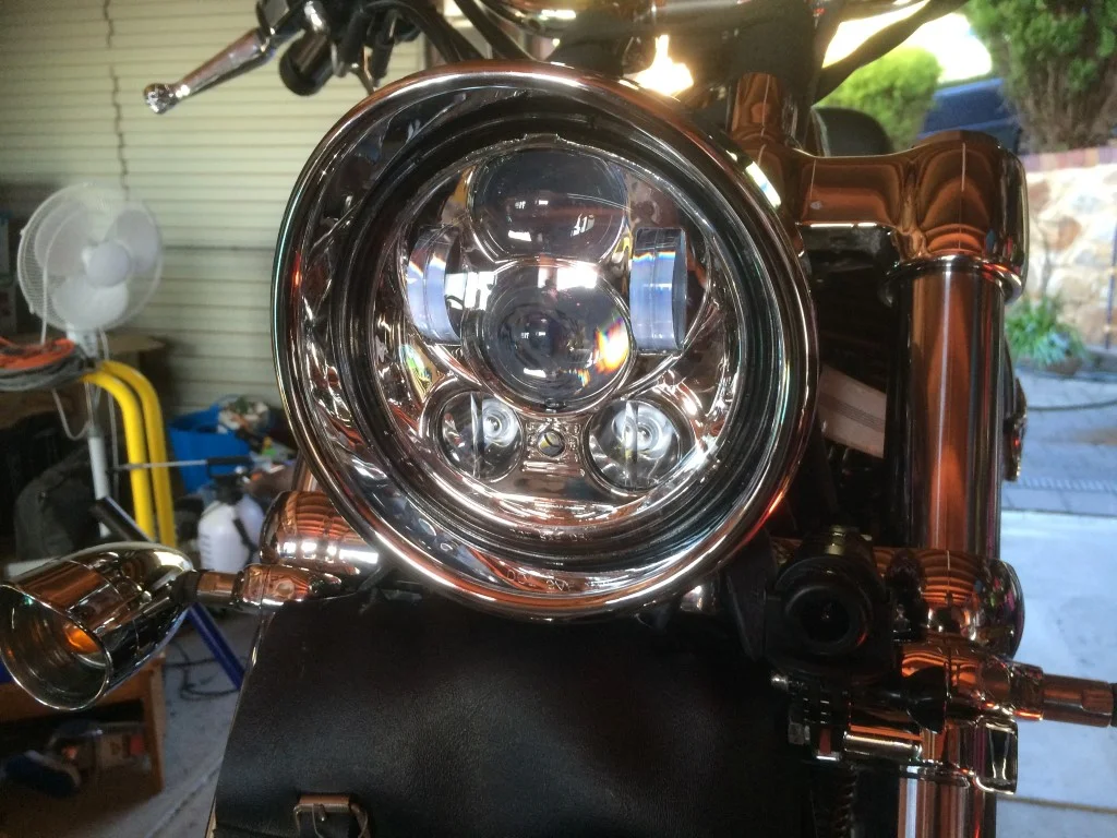

I've moved my camera up closer to the headlight and it is partially protected by the fairing which should protect it from road grime.
