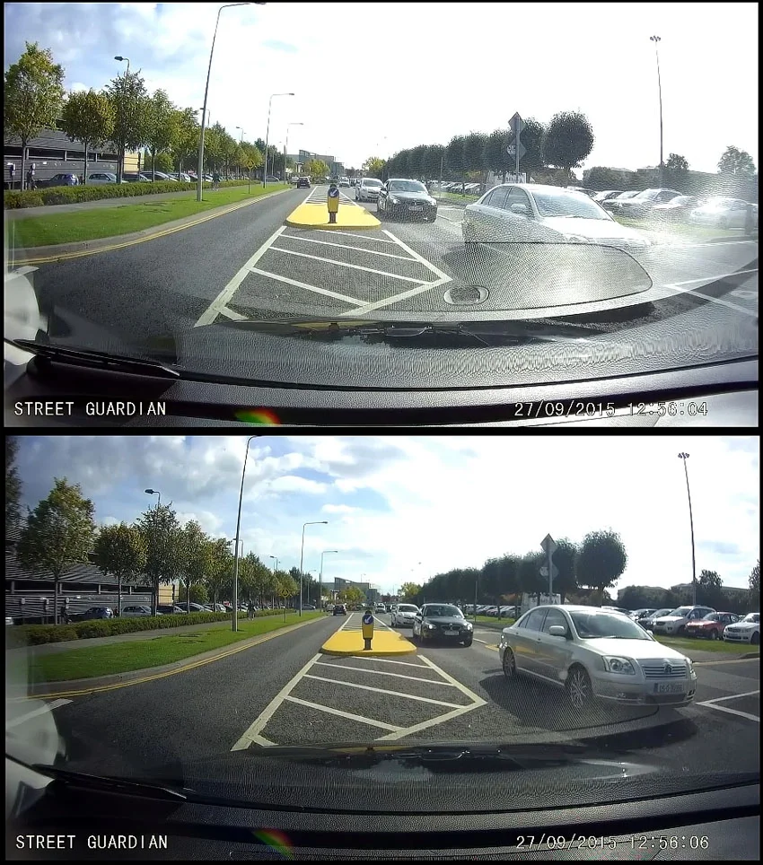

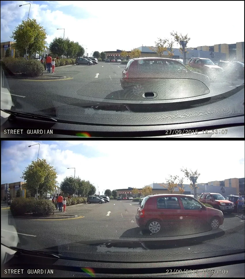

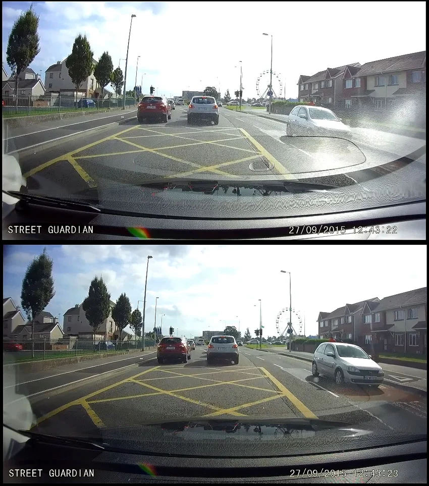

Here are my comparisons about Viofo CPL filter.
Tested on A118C2:
