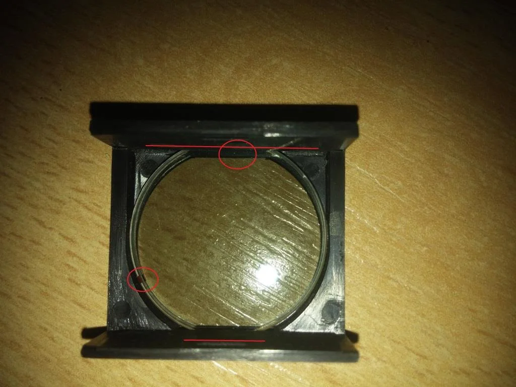

On both side to get best result. There is photo where is red dot now. Original was up on the photo (red circle). But in your car can be on different location.
Confirmed red dot location is different per CPL and can't be used for any group reference.

that's just a coincidence, the red dot only indicates which side is the front and which is back so the glass goes in the right way
I did not know this. I thought it was their universal setting.
me neither. but after my adjustment on a monitor 1 red dot appeared right on top. never saw the other one.
