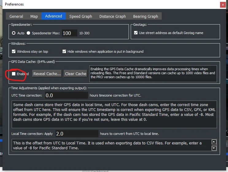

I've continued my tests and found that disabling GPS CACHE option FIXES the duration problem immediately.
Now I can read all video files directly from my SD card and time duration is correct!
The loading time increases, but duration fix is worth it.
No need to copy files on the PC and rename them.
