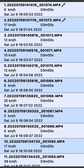

@traveler
Question 1:
The file order is not sorted according to the exif information or file name,
which leads to the confusion of the file order
(because the file is airdropped to the computer, the creation time and modification time on the system are incorrect),
but the time and file name in the exif information are correct.
So I hope to be able to sort by file name, or get exif information to sort.
Question 2:
The reverse function does not reverse the list of files,
but reverses the selection or selects the last file in the case of select all.
This is not the right way to do it, in my opinion.
The reverse function has been changed to reverse the file list order.
Question 3:
Allows drag and drop of files to modify file order
Question 4:
Provides select all and deselect all functions
