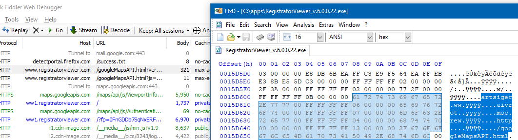

I just had a look and I think I've managed to fix it. Here's a patched version of RegistratorViewer with all the references to the bad domain removed: https://d.sb/registratorviewer
It was trying to load a page called /googleMapsAPI.html (which is strange because the Google Maps functionality works even without loading that page). I just removed the reference to that URL and replaced it with one that I control (just an empty page).
There was some very basic obfuscation, but it wasn't too difficult to work out. The string was just split into several parts and reversed:
Code:
w
artsiger.ww
eivrot
moc.rew
= moc.reweivrotartsiger.www
= www.registratorviewer.com backwards
Seems like it was trying to hide this URL for some reason.

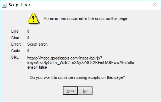

probably on the right track but getting a bunch of script errors depending on which map option is selected
