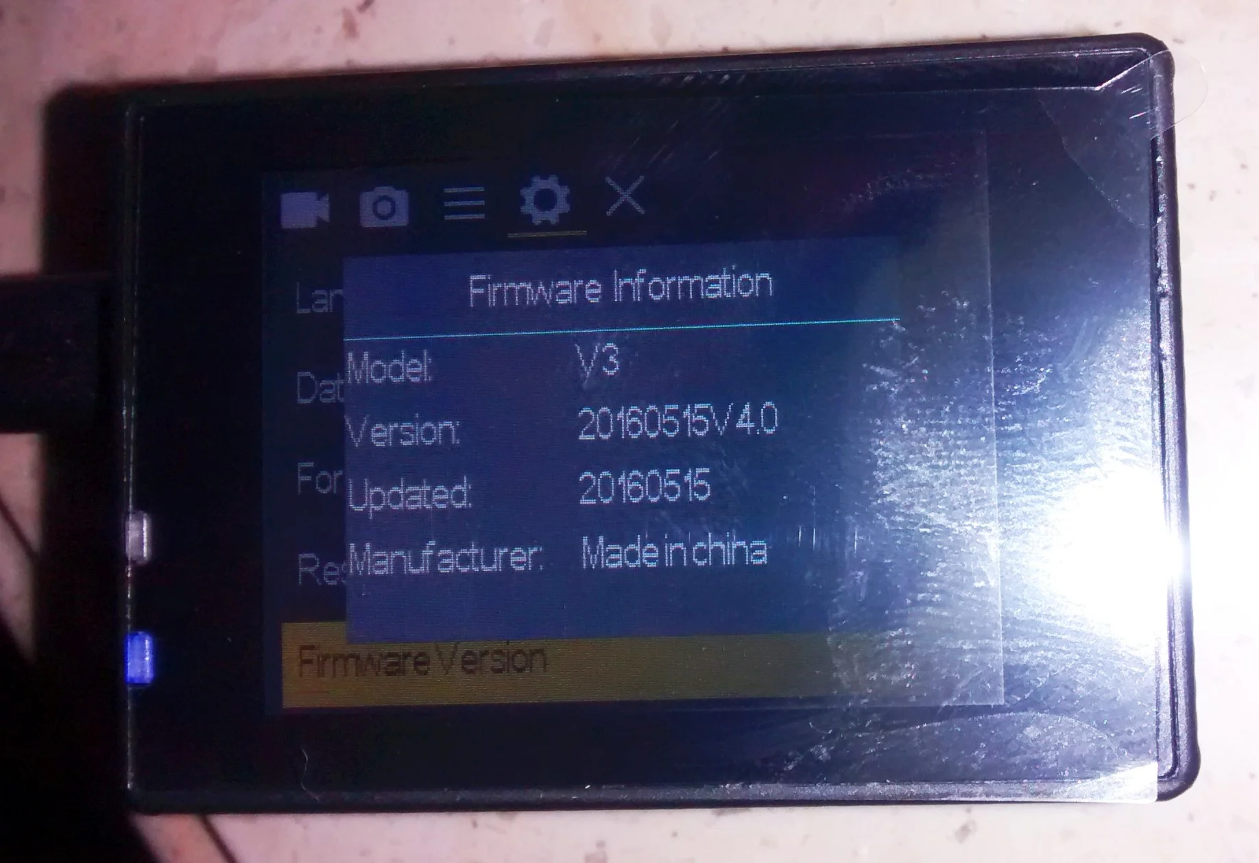

Hello. I received my F60B allwinner v3 camera from gearbest. It's Huangle Crane SL603 with surfer boot logo. Shows 'V3' model and "20160515V4.0" at firmware info.
*EDIT* Here is build.prop. Normal operation works alright as expected. 1080p videos are good enough. 720p is okay. 2.7k is very pixelated about every 3 to 6 seconds. 4k is only 3.2k and low quality / fuzzy. Most still pictures are horrible. The cam connects wifi to my smartphone and windows computer with password 12345678 fine but recommended "XDV" app for android does not do anything, just error message. I tried netstat command in adb shell and TCP ports 6666, 80, and 53 are listening. Data passes on UDP port 6669 often... but for what? The IP seems always 192.168.100.1 on wlan0 interface. I'm trying different methods to discover how the video stream works (maybe via rtsp/http/raw udp)... such as looking around the linux filesystem on the cam, and using onvifdm, nmap and wireshark, tcpdump, among others in windows/android.

and photo of firmware screen
