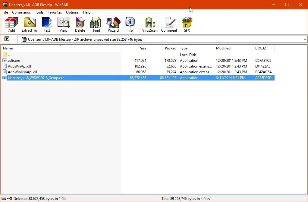

Sure. I will elaborate a little for other people reading this post. Links to a tool or file are in blue text. If any links are dead/don't work then let me know. See attached photos.
  • Do backup of camera firmware using backup cmd script (I got it from goprawn.com).
  • Use your tool unfex_refex_jpg2img_scriptbin_scripts(2) on the firmware backup full_img.fex file to get a script.bin file
  • Download and install Uberizer 1.8 . Files usually go in C:\program files (x86)\Technow\Uberizer folder.
  • Place a copy of your script.bin file into that Technow\Uberizer folder.
  • Open Uberizer_Offline.bat file (so you don't need to connect an Android device).
  • Choose option I, press enter, and option 9, press enter. Joy!
  • Use option 10 in that menu listing to edit/view the script.fex file or look again in C:\program files (x86)\Technow\Uberizer folder for script.fex and view it in Wordpad or Notepad++ (regular Notepad will show a single continuous line of text)
  • In the option I menu listing, there is option 11 to convert script.fex back to script.bin . I haven't tried that yet but I suppose it works.
  • *UPDATE* - newer backup script here and newer unfex/refex/jpg2img scripts here
2016-11-13 16_30_45-Uberizer_v1.8+ADB files.zip - WinRAR.jpg 2016-11-13 16_31_39-Uberizer_File_Explorer.jpg Uberizer1.8_Allwinner_Firmware_Menu_I.jpg Uberizer1.8_Allwinner_Firmware_Menu_Option_I_9.jpg

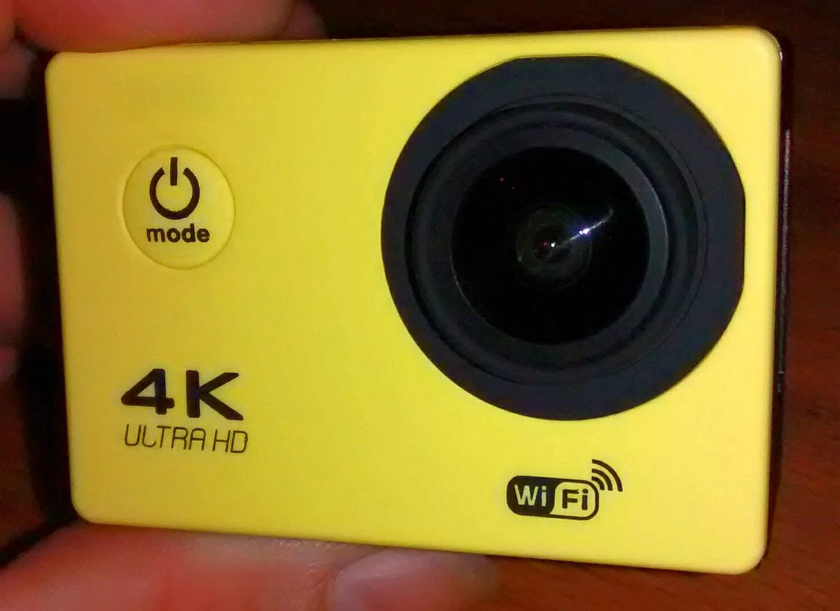

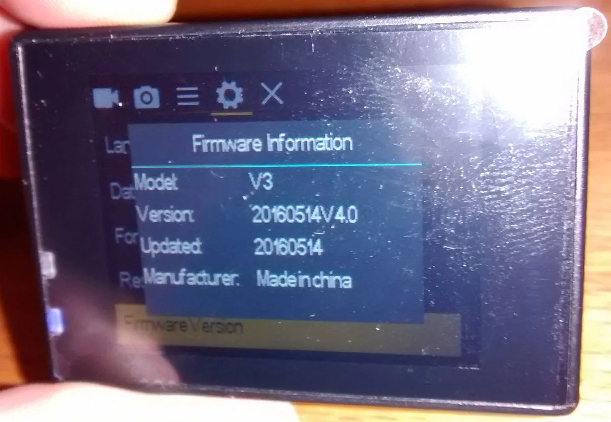

Here is a backup IMG for PhoenixSuite of my F60B Craine Sl603 camera, containing those drone photo boot/shutdown logos, but this time the front body is yellow and firmware date in info screen is 20160514V4.0 (as opposed to black front body and 02160515V4.0). I have two cameras now. ^_^
F60B-action-camera-Firmware-Version-20160515V4.0-V3-Yellow-jpeg-photo2-resize.jpg F60B-action-camera-Firmware-Version-20160515V4.0-V3-Yellow-jpeg-photo-resize.jpg

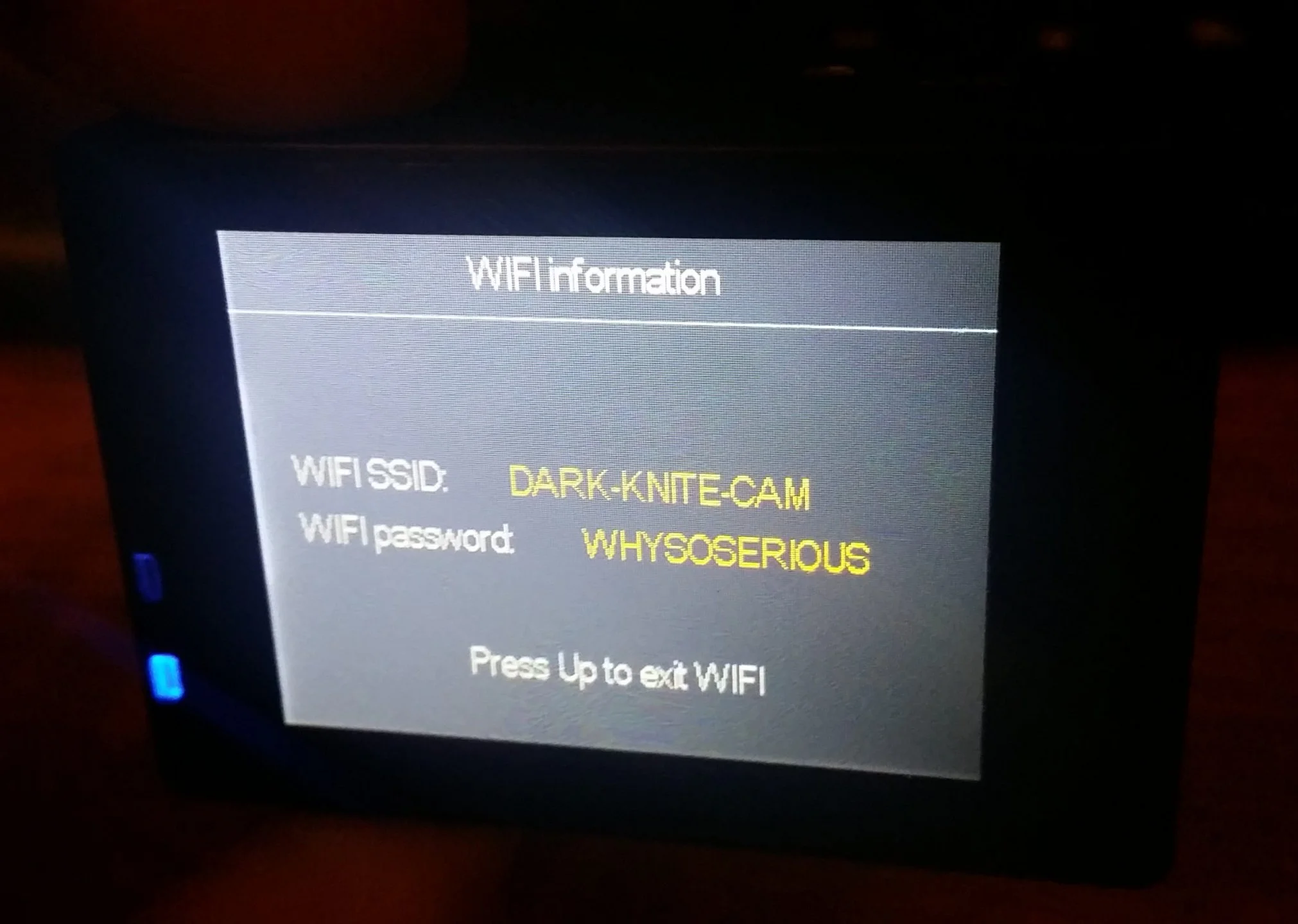

Also, I managed to change the camera's network name (SSID) and password in HotShot app, under ⚙ Settings, WiFi-Info. Give new SSID, old password and new password. Then Confirm. Then TURN OFF wifi on camera (up button). Wait 5 seconds. Turn on wifi again on camera. Joy! I suppose any letters/numbers up to fifteen maybe sixteen characters long will work. ^_^

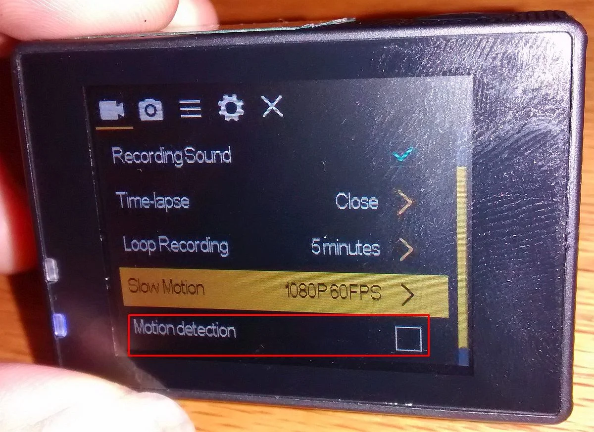

*EDIT* Some days ago I received a generic "F60R" crane sl609 camera from ebay similar to F60B crane sl603 but with wireless remote. Its factory firmware has motion detection feature for video only. So about 4 seconds of motion in %50 or more of the view usually triggers recording. Keep the camera motionless for a few seconds before you stop the recording; otherwise a new recording automagically starts.
To flash this firmware directly to another F60B crane camera, the 0-uboot.img should be patched by writing your camera's script.bin using Uberizer 1.8 (see other post in this thread). This firmware could not be directly flashed to my F60B crane sl603 20160514 probably because lcd_driver or whatnot was wrong. So I put together a mix recipe firmware pack that will flash right (at least for me), along with drone boot/shutdown logos. In this filesystem, there are new files "awmd" under /system/lib and /system/res for the new feature. Note: when using motion detection, your screen will have a running-man icon, and video files may be delete-protected in menu and in \lock folder not in \video folder on sdcard and file names will have _SOS after date_time. This happened on one but not all of my F60B(R) cameras.
download - https://www.dropbox.com/s/g1mzbvtkvla68zn/F60B-mod-backup-crane_sl609.xiapc.20160913+20160514-lcd_ili9341-IMG-FEX.zip?dl=1
Also a user on goprawn has F60R firmware with motion detection but for beike imx179s 20160604. Try this if you have a beike board or try to make a recipe mix.
download - https://www.dropbox.com/s/jng1xik56...ez_beike4k30imx179s.20160604_goprawn.rar?dl=1
Nice "addon" feature that maybe you can use? What do you think?
crane_sl609-xiapc.20160913-menu-settings-motiondetection.jpg F60B-mod-backup-crane_sl609.xiapc.20160913+20160514-locked-file-prompt1.jpg
