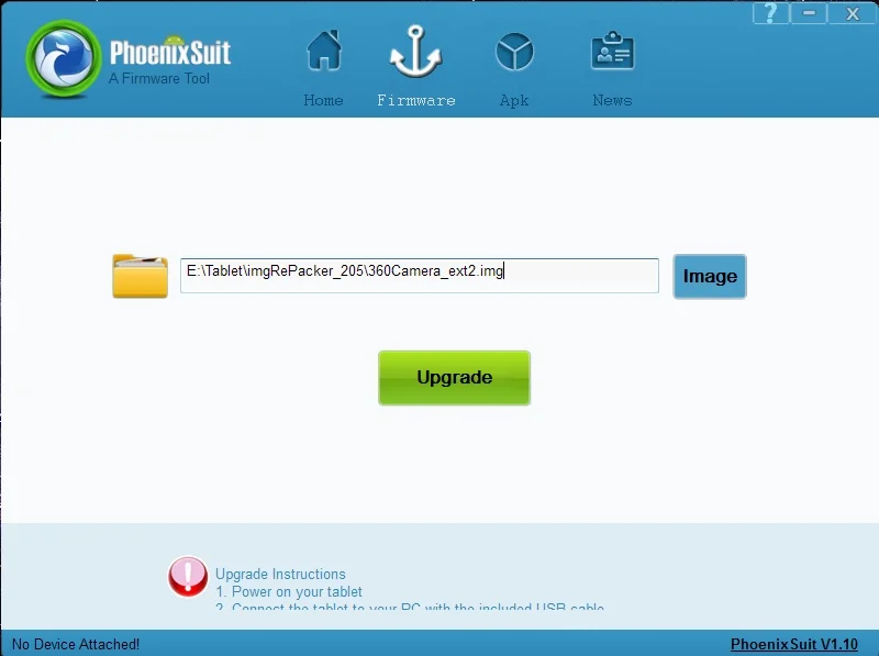

i need help. i can not reach the camera from my pc with PhoenixSuit_V1.10

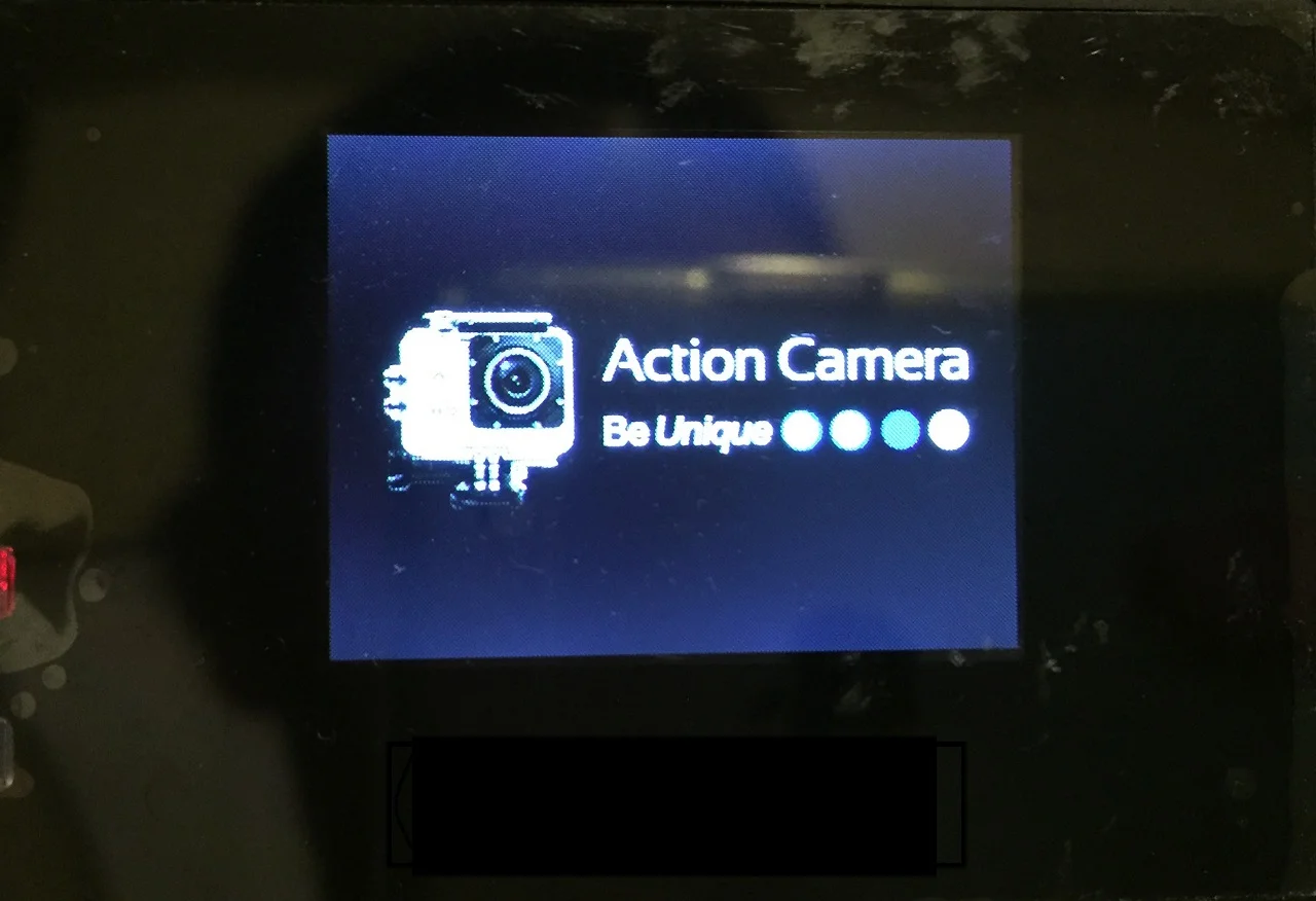

My camera stoped at start up, i can see only "be uniquie logo" No menu, no view.
i'm trying;

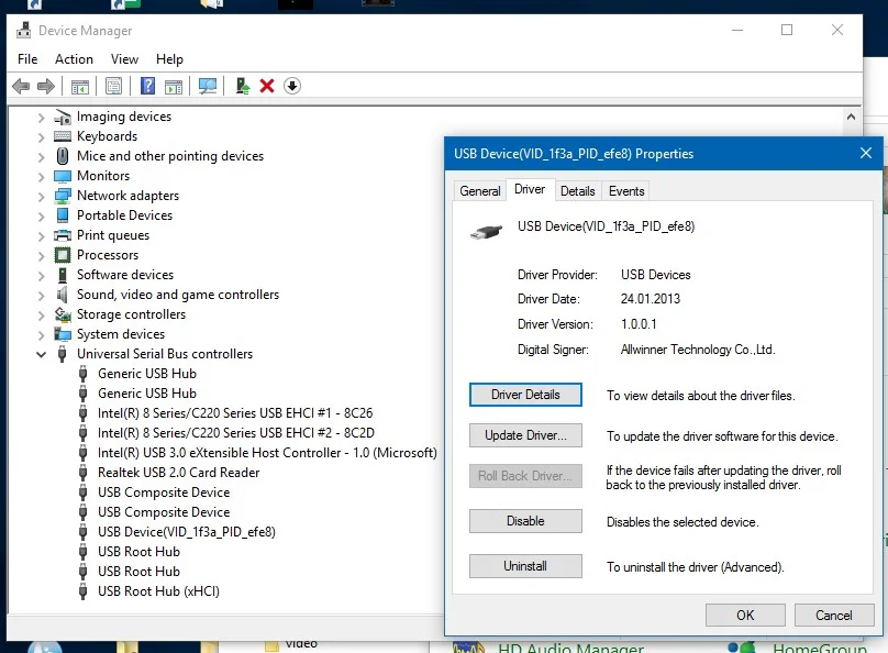

Press and hold up and power buttons, plug in USB cable. Win10 turn driver signature verification off
After this i can see the driver working ok. But PhoenixSuit_V1.10 can not find the device.
thx.

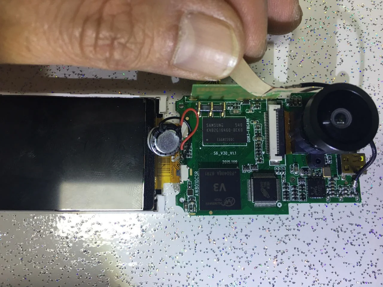

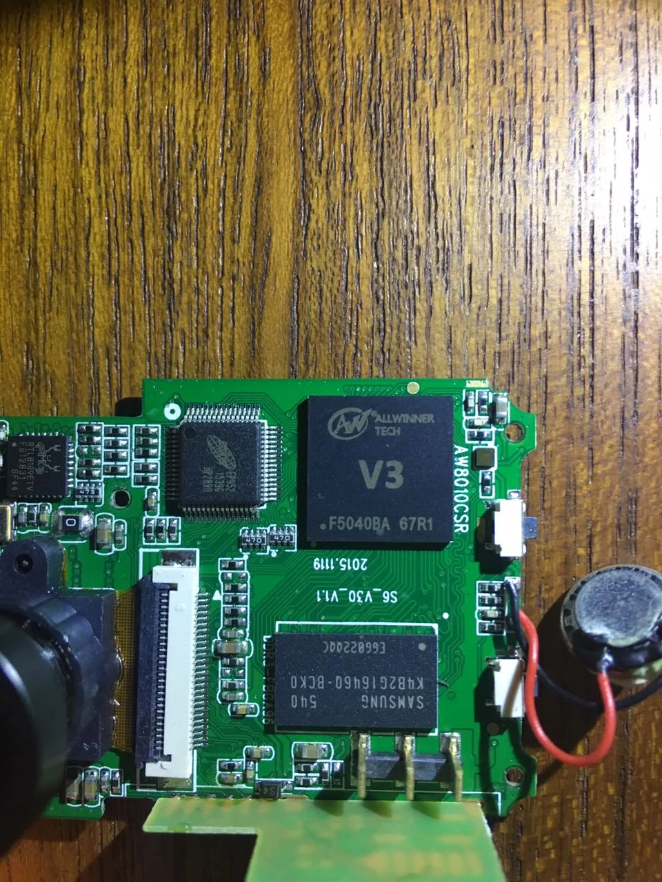

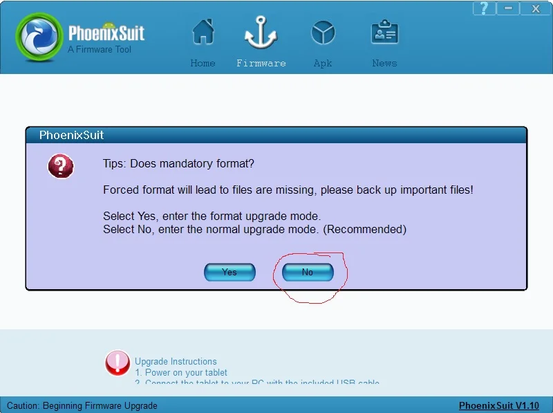

You have to open an IMG inside phoenix suite before it will recognize the device. Then start in recovery and you should get the yes/no format menu.
It looks like this... also try vmware image of windows7 as I refuse to run windows 10.
wrong sensor or LCD configuration. Try some others. There is a whole ton of full_img.fex you can re-pack inside the IMG, especially at goprawn.
All of the cameras thus far have been either OV, IMX179 and IMX179s. If you get an LCD close enough it should stop white screening. I'm guessing you couldn't make a backup since the camera was crashed already.
The back of the LCD or cable might help you find which one it is.

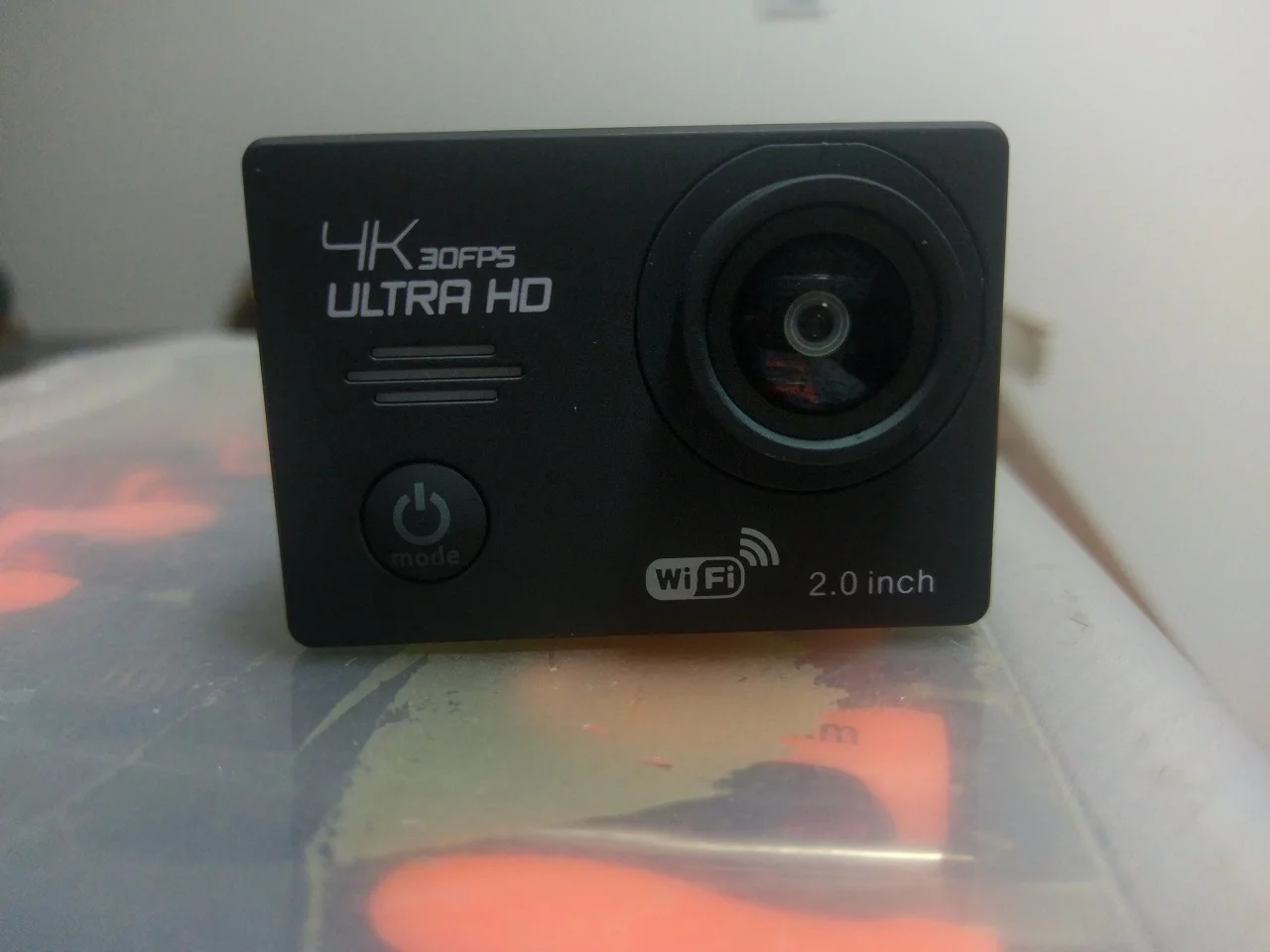

Now I have a problem...
I bought this camera... http://www.ebay.de/itm/112109500796?_trksid=p2060353.m2749.l2649&var=411103199197&ssPageName=STRK:MEBIDX:IT
and I don't get any access to this camera :/ It shown as a Camera or as StorageDevice but ADB and Phoenix don't recognize something!
So, what's wrong with it?
If the maximum video resolution is 1080p30 it's probably not an Allwinner v3. It just has the same body as the Q3h. Sellers can put any sensor/processor into any camera body and if they don't specify in the listing chances are it won't be what you expect. Check the exif data from the photos (in Windows right click -> properties -> details), because it might list a camera vendor or camera type there. And use MediaInfo (or something similar) on a sample of the highest res video. If you send that info here someone might be able to figure out exactly what you've got.
Width: 4000
Height: 3000
Vert. and Horiz. resolution: 72dpi
Depth: 24bit sRGB
Vendor: HDKing
Model: 603C
F/2.8
1/15sek
ISO-400
VideoCodec: H264 - MPEG-4 AVC (part 10) (avc1)
Resolution: 1920x1090 (1920x1080 displayed) 29.978142fps
Bitrate: 12.2 - 12.9mb/s
AudioCodec: PCM S16 LE (sowt)
Channel: Mono 44100Hz 16bit
I don't find the device at http://www.hdking8.com/product/ so it must be a replica (duh... Firmware Q7) but this also tells me, that it's customizable!
