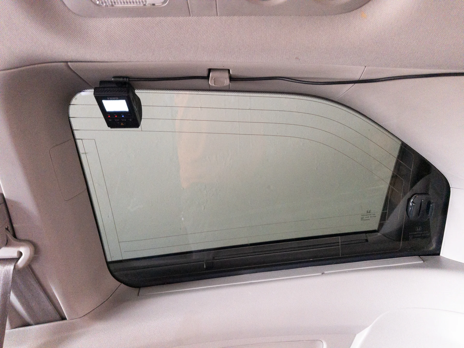

Any camera can be mounted anywhere. I have two Viofo A119 Mini V2 cameras as my side cameras. I use timelapse 100ms interval. This mounting isn't optimal because if the side airbags inflate, that panel would be popped off the camera would probably become a projectile. But the angles allowed by the hinge make it difficult to mount to the glass, plus I don't want to damage the antenna wire
