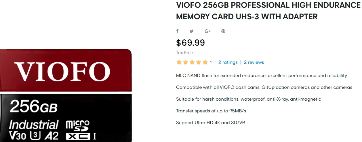

Not sure if you have looked at how much Viofo is charging for their memory vs other dashcam manufacturers...But Viofo isn't really making that much.
$69.99 for their 256GB Viofo card vs $55-60 for the equivalent 256GB SanDisk MAX Endurance.

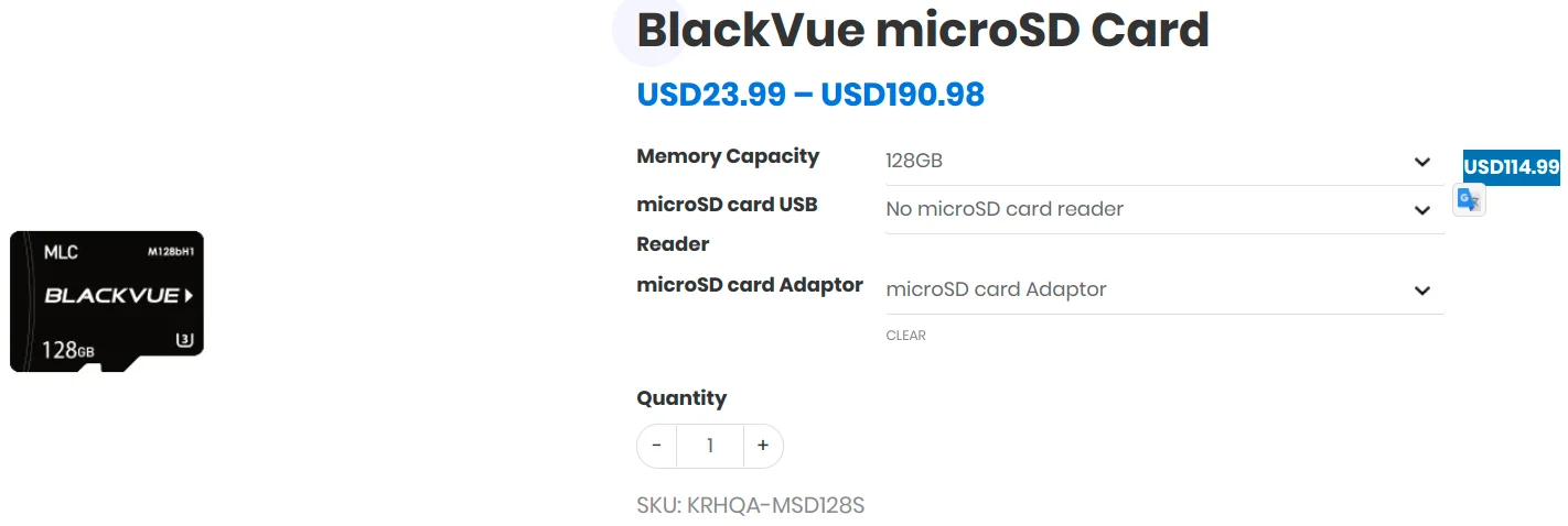

If Viofo really want to make money on cards, they would do like BlackVue and not recommend any other memory manufacturer except their own, warranty it for only 6 months, and charge outrageous prices for them.
Correctly. And they will not need to blush and take the rap for other manufacturers of memory cards.
