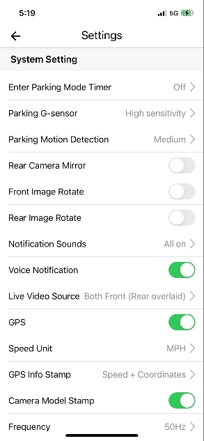

So update: for some reason my live USB with Linux mint wouldn't open up terminal so I couldnt download the formating tool that I wanted to use. I didn't have enough time to do a complete install of Linux so I decided to load up my bootable GParted USB stick and mounted the sdcard to the computer. I completely cleared the partition and allocation of the sdcard and formatted it. Gparted did it within 1 minute which I didn't like because that means it probably didn't do a complete full wipe of the card itself. After seeing that I decided to just do the rest of the formating in windows with GUIFormat. It took almost 7 hours to do a full wipe of the Samsung endurance 256gigs. When I popped it into the dashcam it didn't ask to be formatted before being used, it just started recording with no issues. Now time will tell how it performs. Here are all my settings and how the format results went.
@Kenza750 Are you doing a quick format with GUIFormat or a long one? And yes I have parking mode enabled, here are all my settings.
Sent from my SM-S908U1 using Tapatalk
looks like the same settings and procedure I followed besides I have set the bitrate to MAX instead of HIGH. Also with me the cam started recording immediately when I put the card in. The next day, after overnight parking mode, it started beeping again after 30secs. But recorded normally after pushing REC for the rest of the day.
Let's see how long it stays like this....
Did you do a quick format or no? If it starts acting up to the point where it can't record past 30 seconds no matter how many times you hit the record button. See how many gigs are available on the sdcard. I forgot to do that last time. I wanna see if it starts acting up around the same point of available gigs each time.
