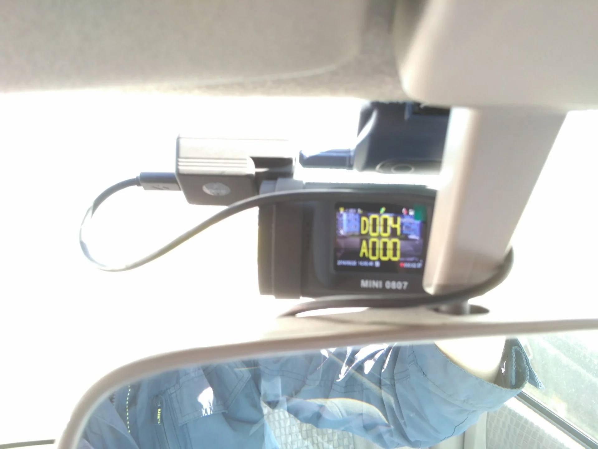

@ Pkentavr how you make it display this ? This is the information of your car battery . We only need it when user has problem .
I pressed display button(one long and one short click)
What is Standby Mode, and how do you get the camera into Standby mode
Page 7, section A of instruction manual, says "when camera is in standby, long press UP button for 2 seconds to enter the menu.
it seems that this is within a split second of attaching it to power, sometimes if i time it right I can get into the menu but most of the time I cant.
Surely its not this hard to access the menu?
FWIW i dont have any problem accessing playback menu by pressing down.
@blake7
The menu can always be reached as soon as the cam is supplied with power.
Probably the switch is very sensitive and detects both, push up and sideways simultaneously.
That happens to me often in the setting because I rotated 180 ° in "Flip Mode" use the Cam.
