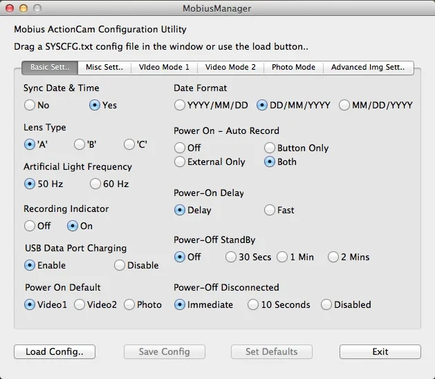

I already replied to you on RCGroups. http://www.rcgroups.com/forums/showpost.php?p=31460109&postcount=15100
Open the SYSCFG_BAD_MOBIUS.TXT file and your problem should be evident from the last group of 5 settings. You have set the darkest exposure possible, which is black. Some other Advanced settings are also definitely not correct.
