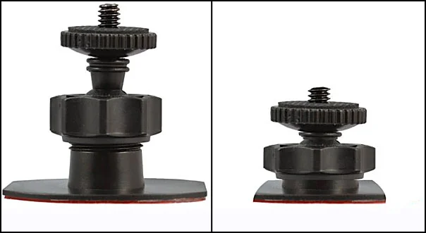

@JooVuu
How much the short mounts can move around depends upon that locking plate/knot.
If you replace that with a much smaller knot or a wire tab to lock, even very short mount can move all around.
You can test it by removing that plate all together and just use the ball mount 1/4" screw and see how much freedom you'll have.

@JooVuu

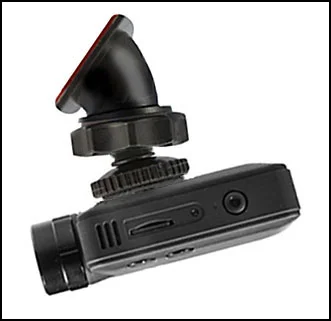

Yes, I agree. This was my thinking when I created those Photoshop mock-ups of a hypothetical ball and socket mount for the JooVuu-X. As you can see, I made the locking nut half the width of the original design we see here on the left. Of course, these mock-ups don't show the additional axis swing you would achieve in real life since they are just trimmed down versions of the original. A real-life version would allow for more of the ball to protrude from the socket.
A metal one of these could be a hot seller...
I think a metal one might be cool but I also think it would be expensive to manufacture yet not provide any particular advantage over a well made plastic one.
Absolutely!!! Plastic components can all be injection molded rapidly, metal would have to be individually machined which is time consuming and the raw material cost higher. Even if they could be cast each would still have to be finished afterwards whereas plastic I.M. parts are ready to go immediately. You would likely end up with a mount more expensive than the camera. 😱
