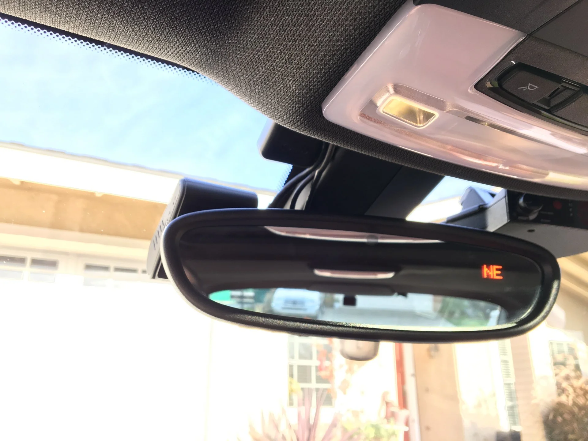

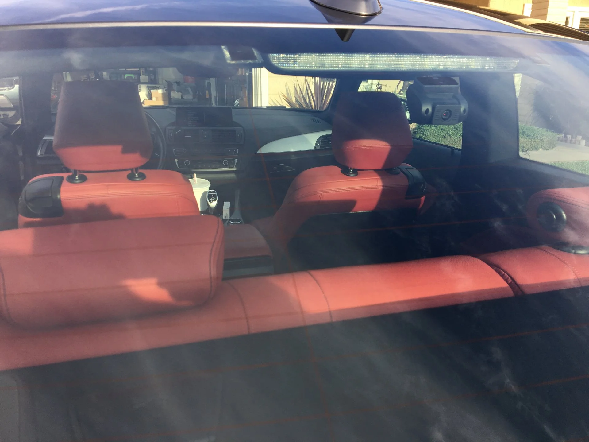

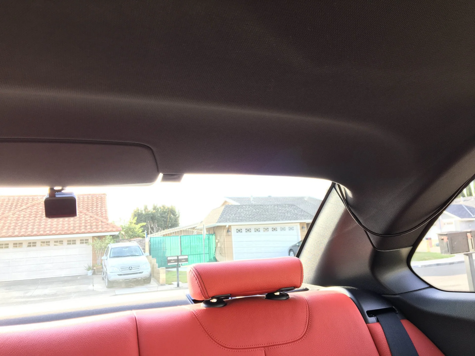

I just needed like 6 more inches. So close. I didn't have enough to tuck the cable under the molding on the C pillar. But even if I had 6 extra inches I probably would still do it over again with the longer cable to run it under the floor trim because the B pillar molding with the airbag is too tight to hide the cable around its edge, and it would bug me seeing the wire wrapped around the top edge of the B pillar. I don't want to mess pulling off the trim on the B pillar since the airbag is behind it. Running a long cable along floor should be quick and easy.
I popped off the rear upper brake light cover to hide most of the cam cable under it. If anyone plans to do the same on BMW, pull down on the cover from the side closest to the glass. There are clips on the side closest to the front of the car that will probably break if you pull down on them. You need to pull down on the back to pop out the two vertically mounted clips about an inch down, and then slide the cover towards the rear glass to pull the other two front clips out that are mounted horizontally.
BTW - I'm quite happy with the quality of both the front and rear video. I had looked at a few other dual channel cams and they had poor specs for the rear camera. Both the day and evening video look great. Image is very sharp on both cams even on the edges. And you can't beat the service from Street Guardian!

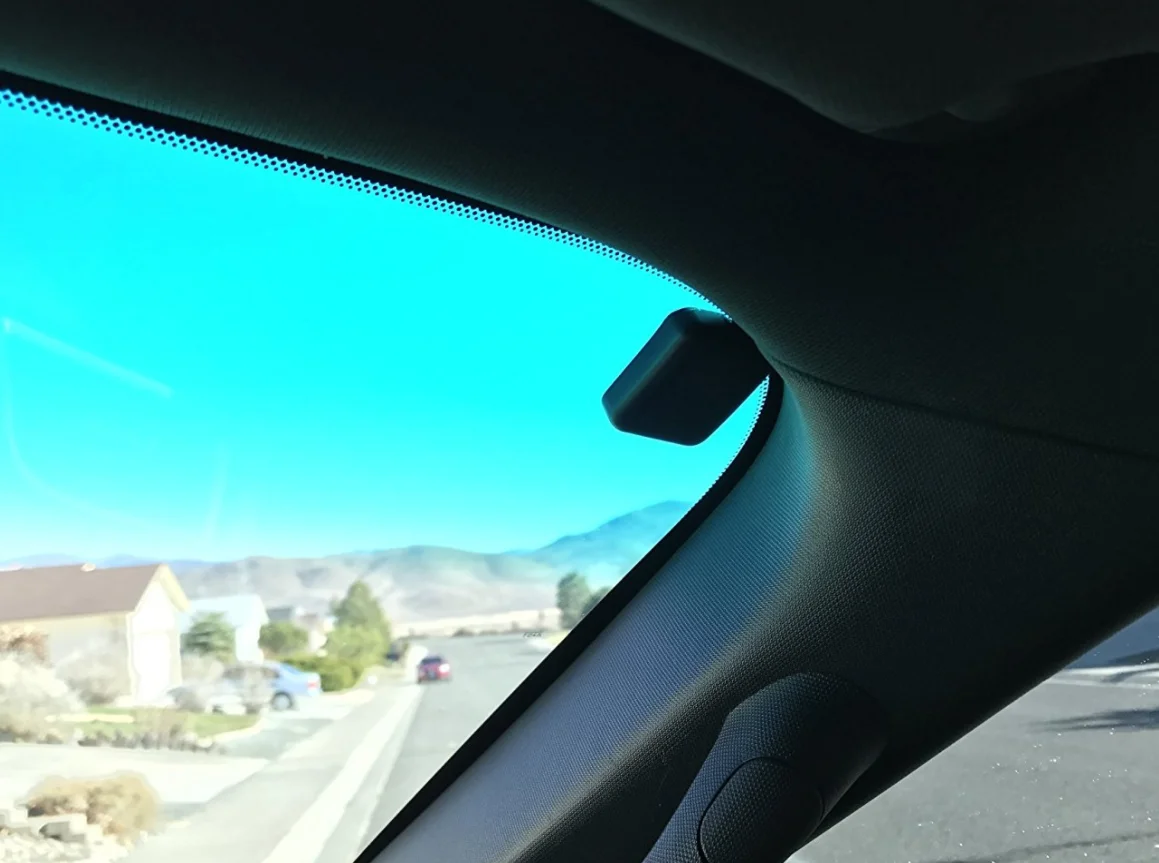

Quick question about the gps- does it matter which direction its mounted? Is a far corner of the windshield like this ok? Whats the best?
Sent from my SM-G920W8 using Tapatalk
3, 6, 9. 12 o'clock, Doesn't matter, mount it so the cable is hidden as much as possible and not sticking out. (makes no performance difference)
Far corner yes
That should be fine, i put my antennas in the upper corners of the windscreen.

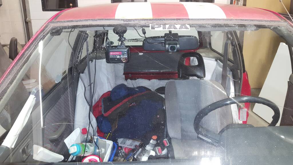

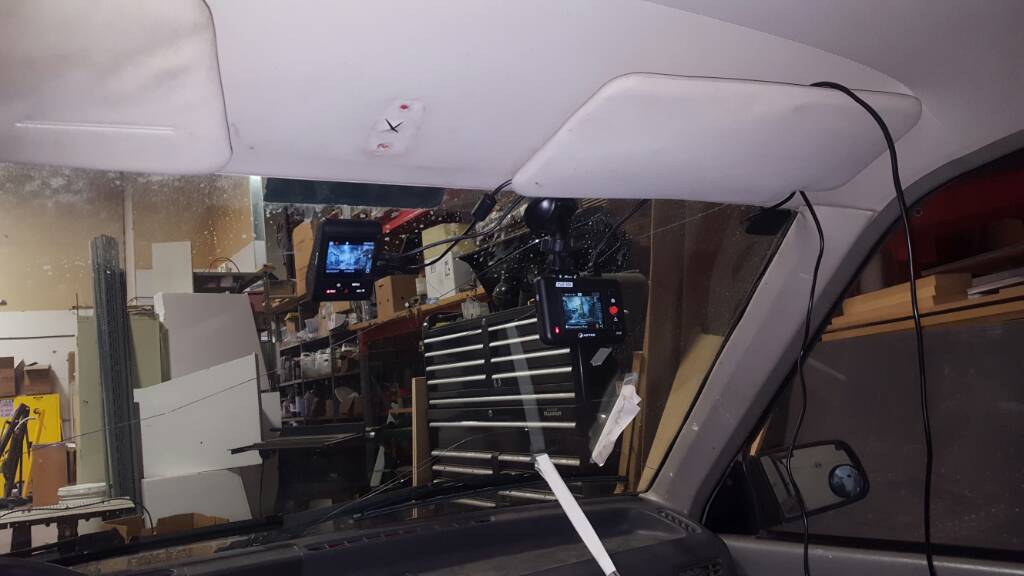

Good i got my front cam and gps installed. Ill have to make a bracket for the rear. Leaving the old cam in for the drive home to compare video and then it will come out. Wires will be routed later. Its 10pm and i have an hour drive home. Happy so far! I just hope i got the mount on square...

Just looked over my videos from last night coming home- the sg front cam compared to the aiptek x2. The sg wins by a long shot but i for sure need to put the foam in the mount to stop both the audio and video vibration.
One question/suggestion: the startup noise- on your next camera can it be something different? Anything but that horrid 'china camera' noise. Would like my $500 camera to sound different than the $25 one i bought years back, lol.
As long as the vibration stops with the foam im happy. The gps is nice and this camera is discreet with very good night quality in town with streetlights and decent in complete darkness.
Just need to get a bracket made for that rear cam so i can try it out!
