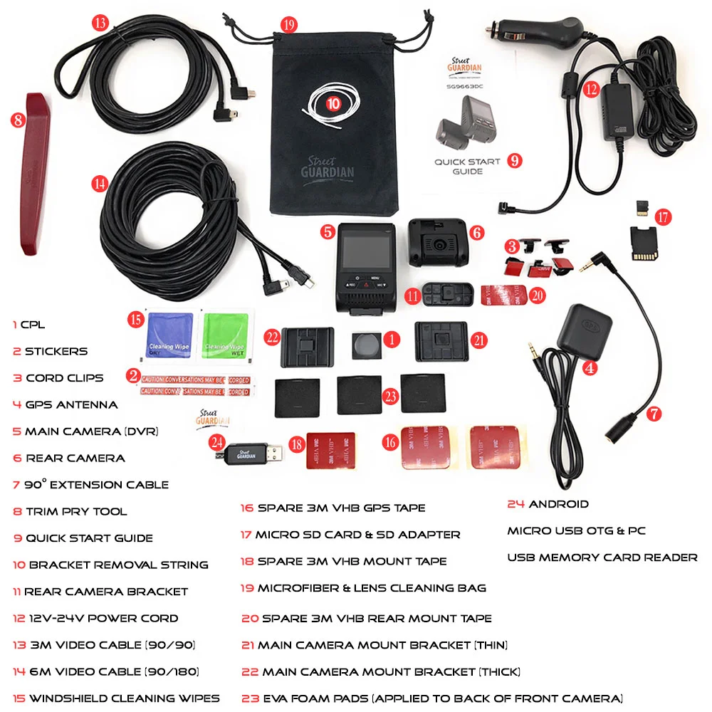

Make sure to get your serial number before you apply the foam tape unless you've already registered for the extended warranty.
3M EVA foam pad can be applied over the camera windshield mount, this way serial number on main dvr will be visible. Of course with dashcam frequent mount/dismount serial number may wore out after some time, but I believe most people leave it mounted in car for overnight and remove it only when really needed. Still it is worth to write down product serial number and register on SG website for extended warranty and FW updates.
it will work better if applied to the back of the camera, more important if the camera will be removed often, they're not really intended to be removed often though

I didnt realize there was a thick and a thin mount. Why 2 different sizes?
Sent from my SM-G920W8 using Tapatalk
best thing is set the lens to the desired angle with the CPL fitted and hold the camera up to the glass with the mount in place, if the thin mount gives you enough clearance use that, if you find due to windscreen angle you need the thicker mount then use that
