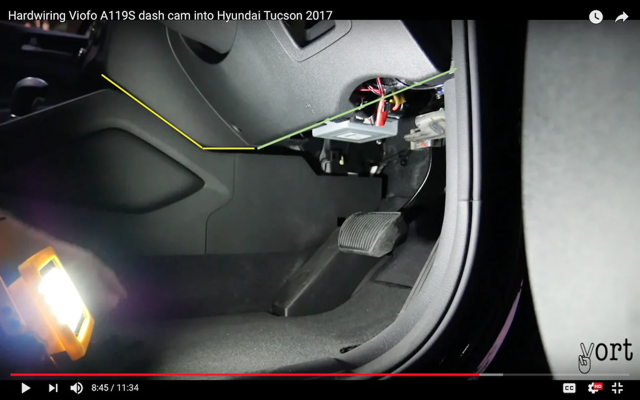

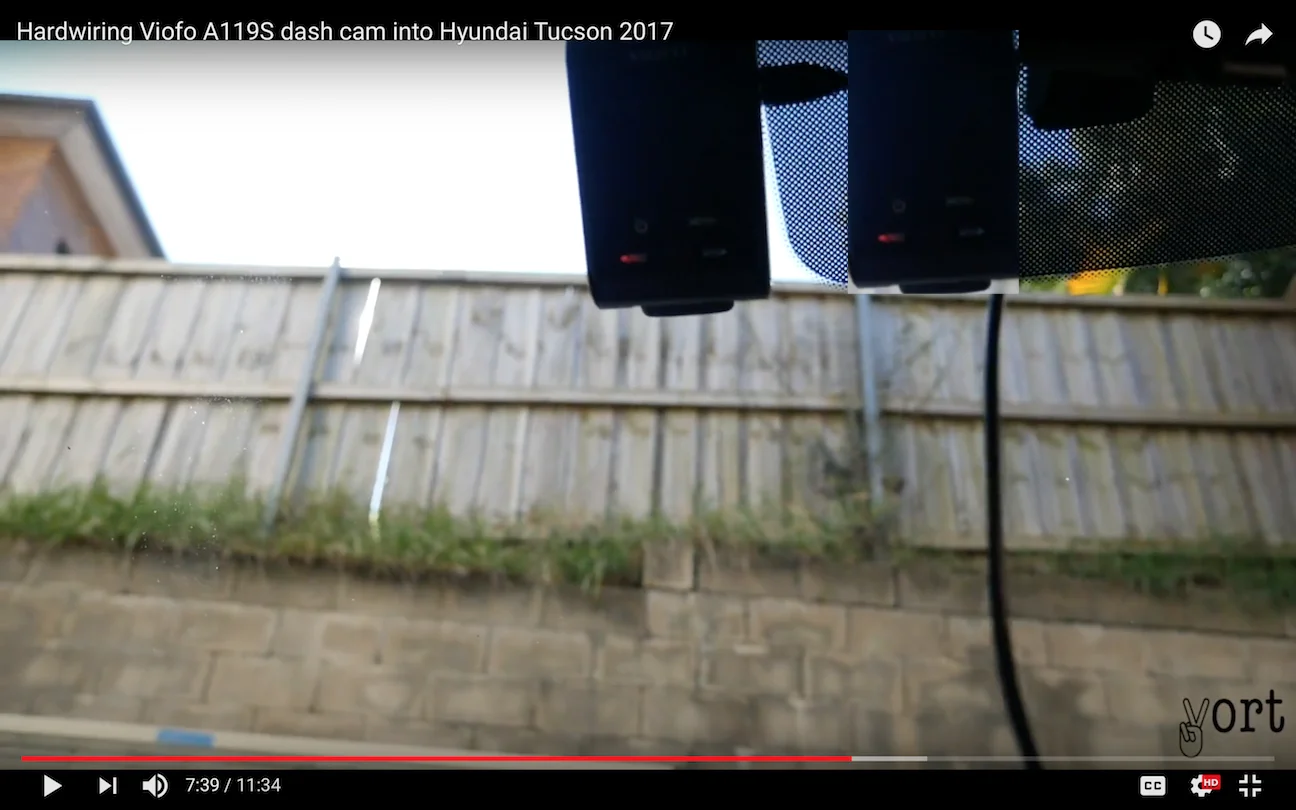

Don't know whether you plan on hardwiring or not, if not you could run the wire like shown below, green line behind the plastic trim.
These cameras are meant to be stealthy, better to mount it on the dotted area with just the lens visible from the outside.
