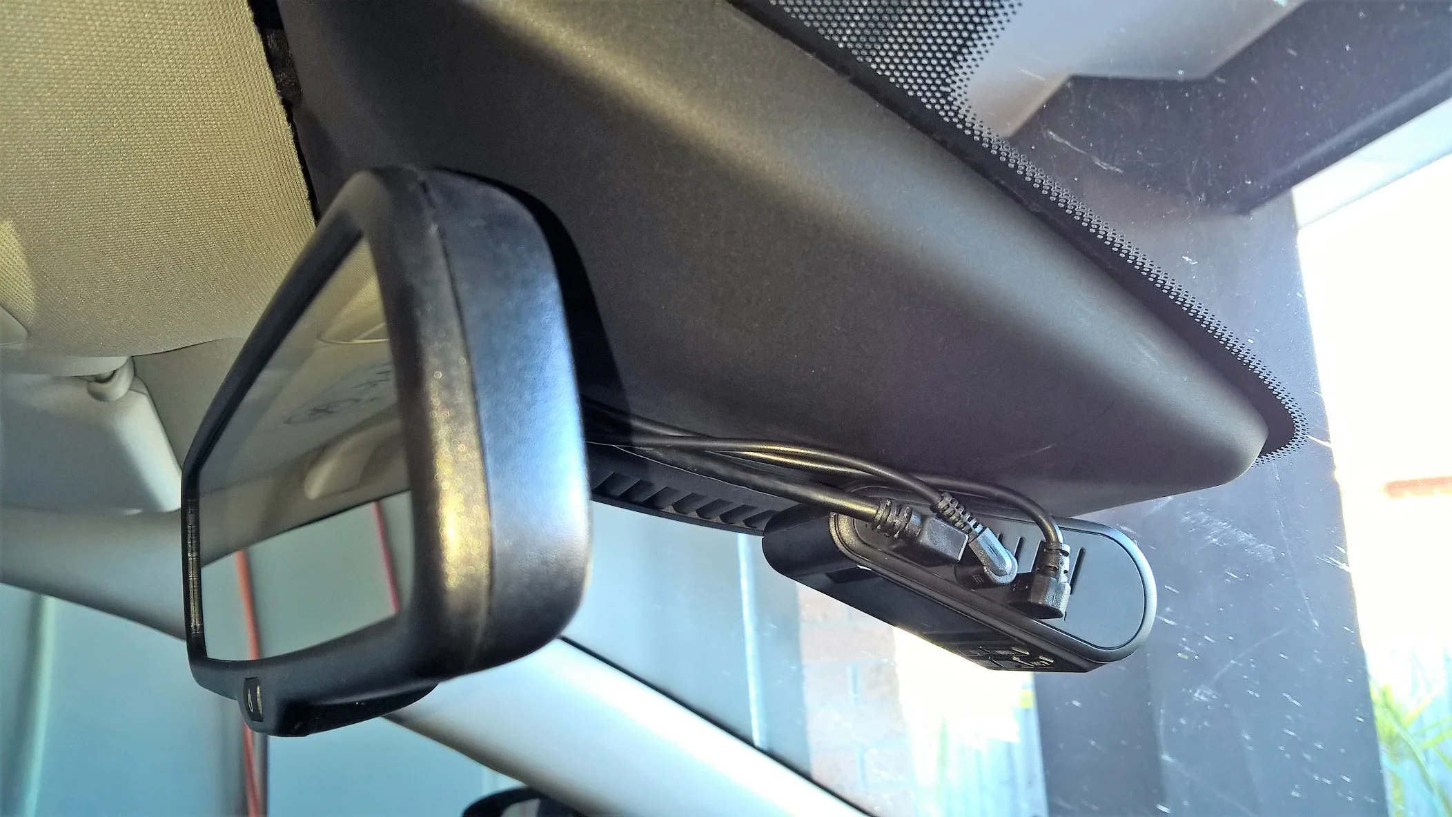

Got it installed, front is fantastic, rear is really good. Short cable in set has two right angled USB plugs...won't fit with GPS. Long one has straight and right angle USB...but in all cases USB is right angled the wrong way...should be left (up) instead is right (down)...so more cable to deal with. GPS/overlay seems to be hit or miss...I need to look at that further (I had it working, didn't change anything, and it stopped working...reformat card everytime i pull it out and put it back in.). Sound is pretty good, considering it is a non optimal location. Aiming cameras is much easier with a live view app. On my truck I had to cut out a piece of sheet metal to shove under the headliner and create a mounting platform for the rear camera...can't glue on tint, and would be too low anyway. Power cable is long enough. Actually location of USBr cable made mounting rear camera more difficult in my application) BTW if you install in right hand drive car, USB cables might not be as wrong.
Short cable in set has two right angled USB plugs...won't fit with GPS. .
sounds like you have the cable installed the wrong way, the plugs are different each end
edit: when you have the cable the correct way around will look like this when plugged in
Maybe...I thought I tried it the other way around...but I will take a look.
Have you considered mounting on the sensor housing?
So, that is what I did. It's been a few weeks since I installed in my CX-9, and have been meaning to post some pics so here we go. BTW, thanks Rick for sending the GPS extension cables.
Currently I have used the thinner mount, and the camera is catching a frit to the left top corner. Not a big deal, but will be removing it and mount the thicker one at some point.Will wait for the new hardwire kit to become available to do both together. Hope that is coming soon, Rick? 😉
