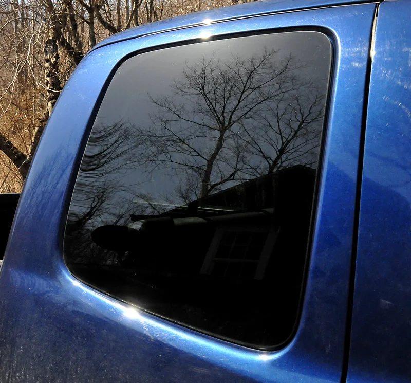

For quite awhile now I've experimented with different cameras facing laterally out the very dark tinted rear side windows of my pick-up truck. The cameras always require an exposure adjustment to compensate for the dark tint which acts as a neutral density filter but there has never been even the slightest color shift regardless of which camera I happen to be using. The cameras work very well in this installation.
The one camera on the market that would be able to deal with the problem of a tinted window causing an unwanted shift in color is the Mobius because it is the ONLY camera that provides for extremely granular adjustment of colors across the entire RGB range and which can be stored as custom profiles.
There is a dash cam behind this glass.
the difference here is your truck has privacy glass - a dye mixed into the glass itself. this doesn't affect clarity like film and its adhesives do. ronan has a film applied over the glass. also, lighter films like his sometimes impart a bit of color, usually blue or green, sometimes yellow, to the light coming thru.
I see. Yes, I can see why a film could cause a color shift where factory glass wouldn't. Either way, the Mobius camera's ability to adjust for color balance would be a possible way to deal with it.
Those aftermarket tint films are completely illegal in my state so I have little familiarity with them and only see them on out-of-state vehicles.
